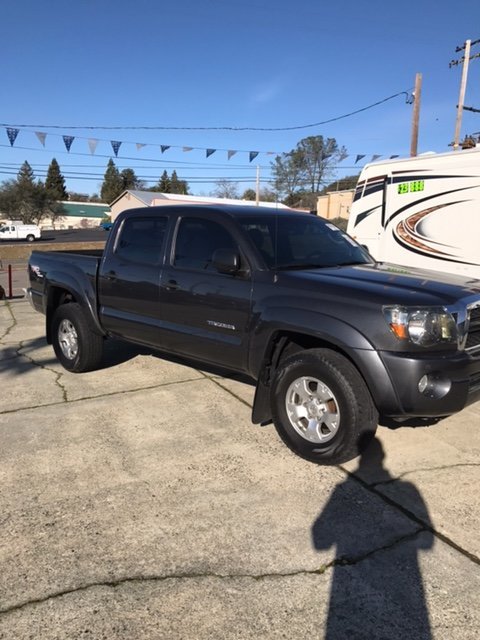

    First thing I did was peel the stock TRD bedside stickers and add some matte black ones I bought off eBay. Then, to fit in with 90% of my fellow Taco owners, I had to add the small american flag sticker under the side mirrors haha

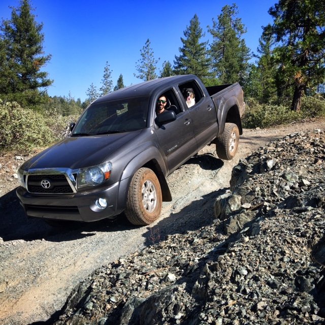

    Here's a sikkk stock flex pic lol

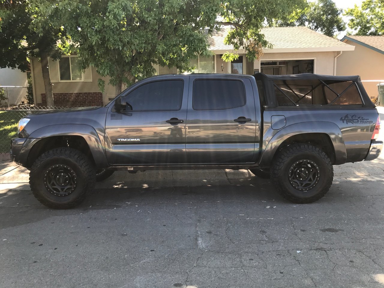

    Bought a used Soft Topper from Mike on here(don't know your name on here lol), mainly for my dog, and it will come in handy on long road trips with rain.

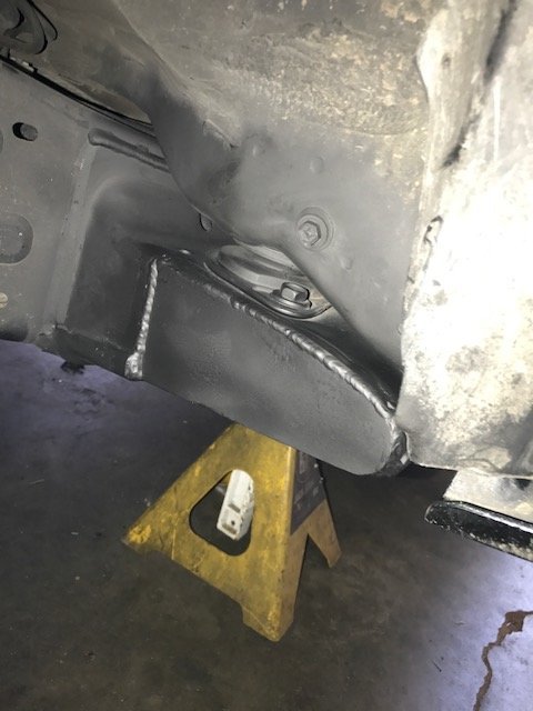

    Read alot about tire rub on the cab mount with 285's. So I chopped the body mount.
    *UPDATE*
    -Kicking myself in the ass for cutting first then getting tires. 285's would have cleared the body mount just fine. So I spent 4 hours working in 100 degree heat collecting metal dust on myself for no real need haha.

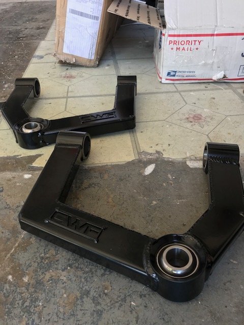

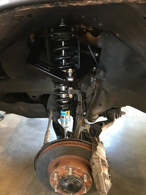

    Bought some new UCA's from "CWF offroad". Super nice and cheaper than TC's, icons ect. I love the look over tube'd arms.

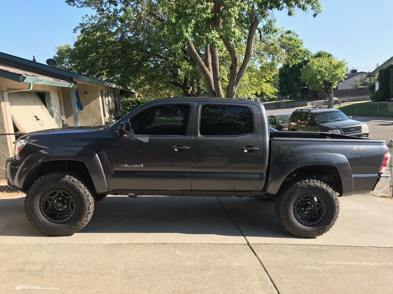

    Throwing the lift on. 5100's, old man emu 885 springs, CWF upper control arms, and the driver side got the classic 1/4" spacer for the infamous taco lean(part # TP14). Sway Bar delete mod.
    Forgot to take pics of the rear. It was 105 degrees when i installed the lift. When I got to the rear of the truck, I was in survival mode. Didn't take any pictures, sorry guys.
    Rear of the truck got:
    -Icon AAL
    -Icon 2.0 w/ resi shocks

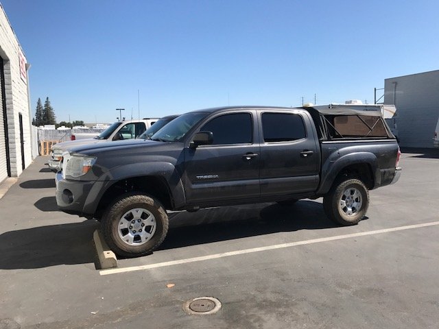

    Here's the truck after the lift and mudflap delete mod- almost kept them on just for the haters

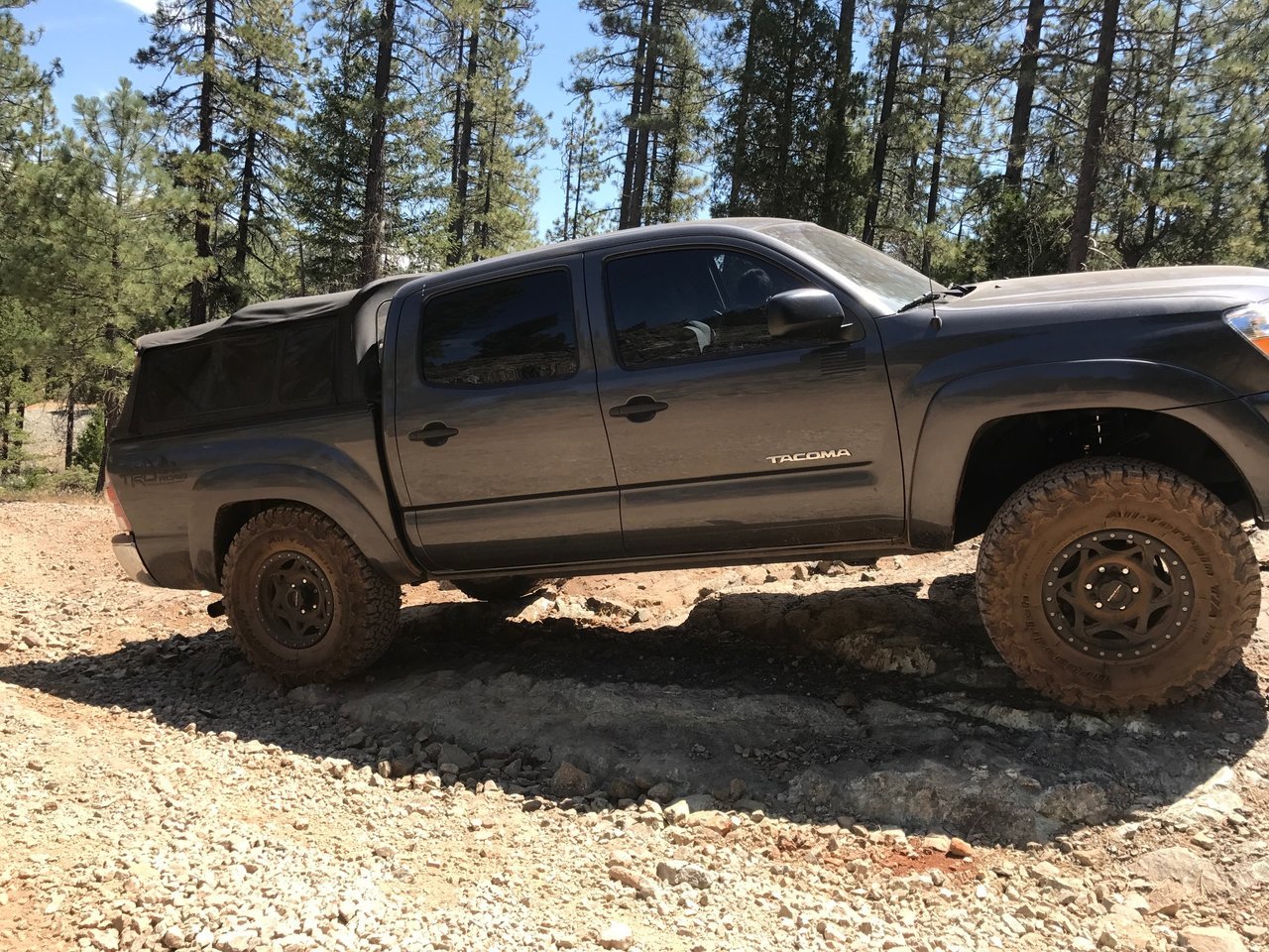

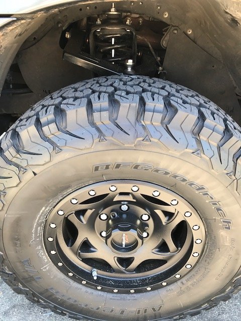

    Finally had a day off and headed down to Americas tires to get my rims wrapped.
    BFG All-Terrain KO2's 285/75-16
    Walker Evan Wheels, 16inch, backspacing- 4.50", offset- 01mm
    Truck is night and day different to drive now. Bilstein's made a HUGE improvement! Happy I went with the 285's. Almost bitched out and went with 265's, woulda hated the look. The truck cruises better on the freeway, just below or right around 2k RPM's now. Mileage wise, I think I lost 1.5mpg with the wheels/tires. I was averaging between 290-310miles per tank stock, the last 2 tanks I've gotten 270-280miles, also taking into account that my speedo/mileage is slightly off now due to tire size.
    Also want to note what a huge difference the AAL pack made. When the truck was stock, I would get a pretty gnarly "clunk" or "thud" when I'd come to a complete stop, felt like you barely got tapped from behind. Then while accelerating from a stop I'd get another harsh "clunk". I figured it was axle wrap, but wasn't sure. After installing the AAL, problems completely gone. Truck feels nice and solid now.

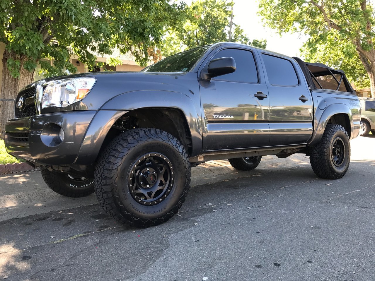

    Here she is in her current state. Couldn't be happier
    Had to take the topper off for the full effect.
