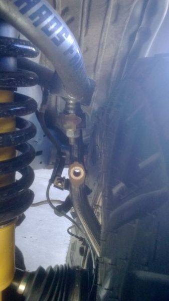

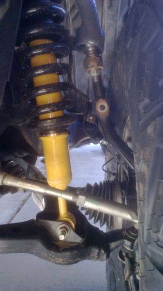

    Need help. Here are a couple pics of my suspension with the 315 mounted on a wheel with 4.5 bs. Looks like there is enough space for the UCA and spindle but not positive, thoughts? Do people go with wheels that have 4 bs to clear the mechanics or moreso to help eleviate rubbing on the fenders, cab mount, etc.?

    Looks like you have clearance.
    If you pushed the wheel out farther (4" BS instead of 4.5") you would rub more due to larger arc your wheel will travel.

    Well it's either that or he's gonna rub the frame and LCA more than he would with a 4.0.
    I'd run it though Matt and see what happens. That's all the clearance you need for the spindle so you're good there.

    Thanks for the input guys. For now I'll push forward with these wheels and see what happens.

    FWIW I BARELY rubbed the frame just in one tiny little spot and only in rare circumstances, for the most part lock to lock I didn't rub at all.

    looks fine matt!

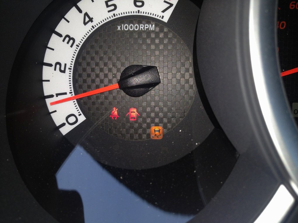

    So after alignment, I can't get my traction control to turn off?

    Nathan you need to do a zero point calibration.
    Here's the relevant section of the FSM. Skip to step 4.
    I use a paperclip for the SST (special service tool).
    http://www.tacomaworld.com/forum/at...d1354944864-how-do-alignment-home-0410026.pdf
    If you can't figure it out and you're anywhere near South Lake, swing by and I can help ya out.
