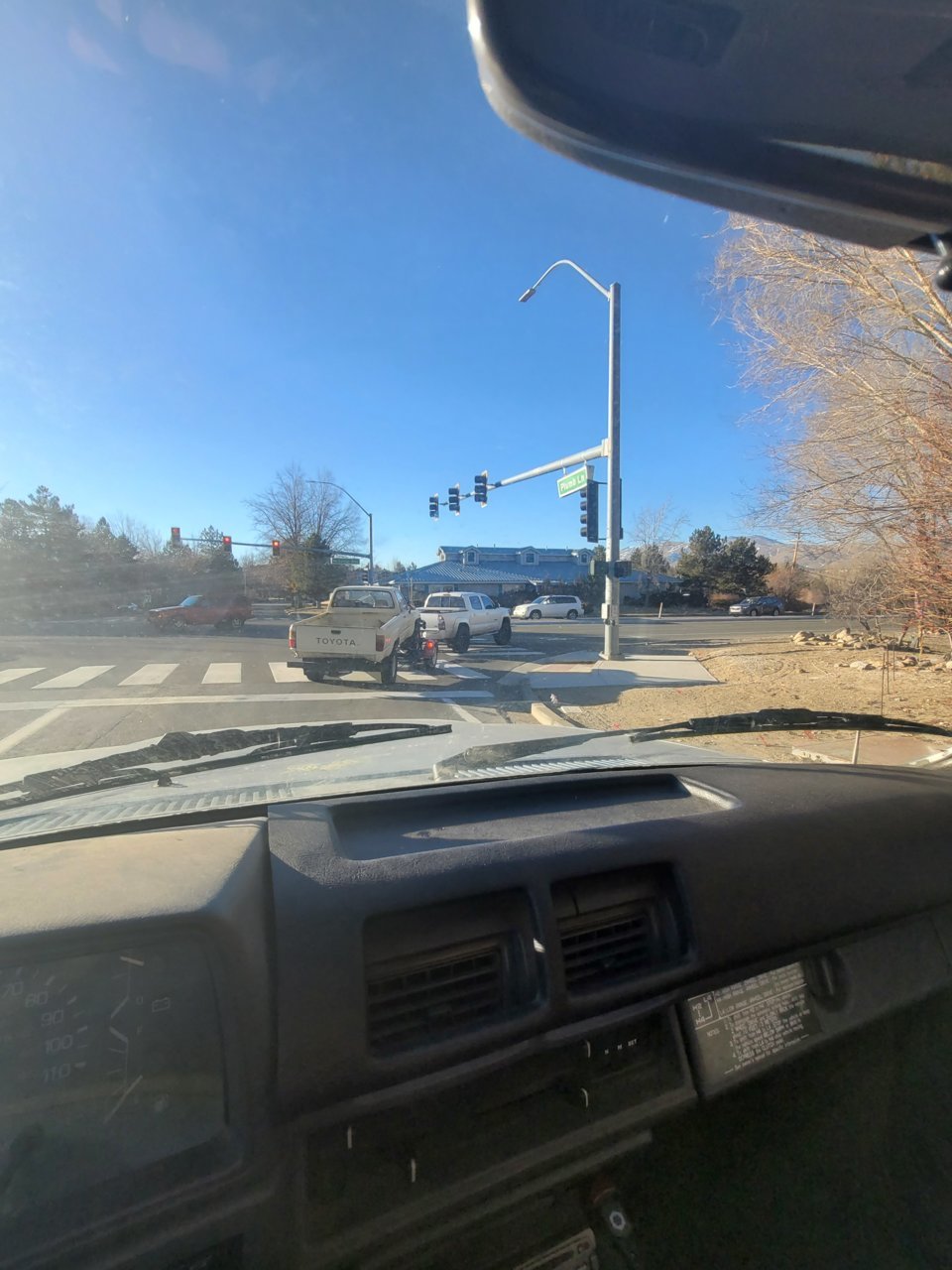

    Spotted in my hood the other day... anyone on here?

    I wish. I’ve always wanted to have a Marty McFly replica, seeing that it was the best movie(s) of all time. IMO

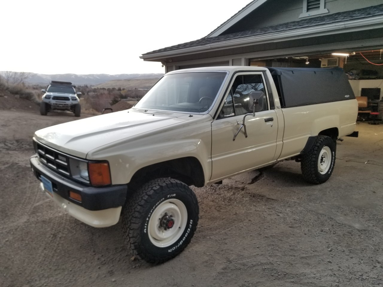

    Not sure if I have posted this in here... I have an '86 the same color as above, I drive it more than my tacoma around town. I thought it was crazy how much people are willing to pay for clean early Toyota 4x4s but after owning a couple i get it.

    That’s clean, I like the color!

    Nice!

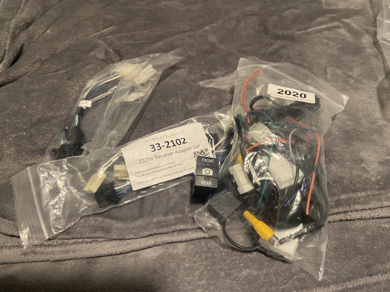

    Any third gen guys want an anytime front rear camera kit? Got it off another member when I bought my sliders. He was getting rid of truck never got around to installing this. I didn’t even look at what years it’s for till I got home.
    I think it’s 2020+?
    Got the dual function switch too.
    free.99 payin it forward
