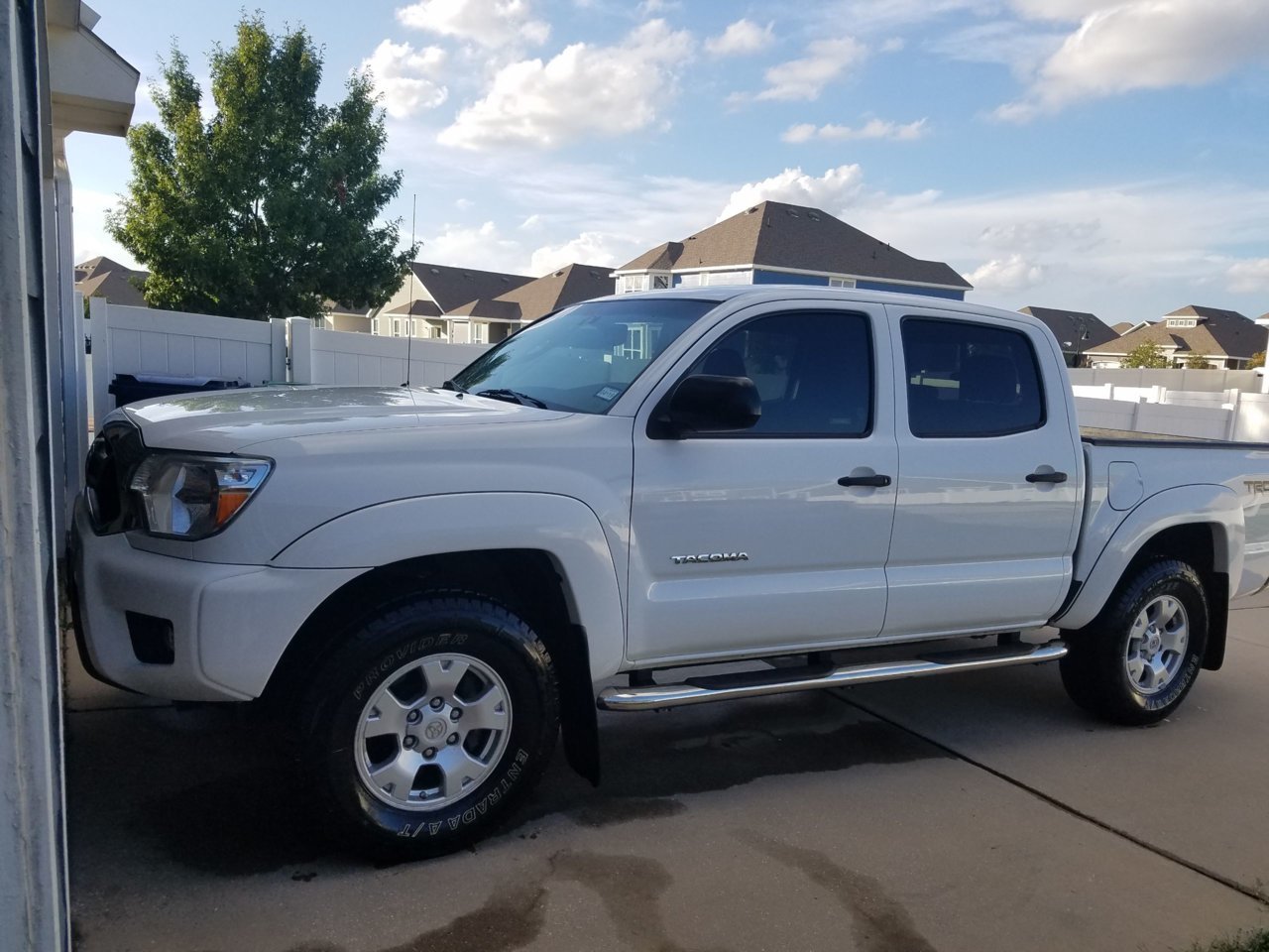

    - Factory as factory can be...

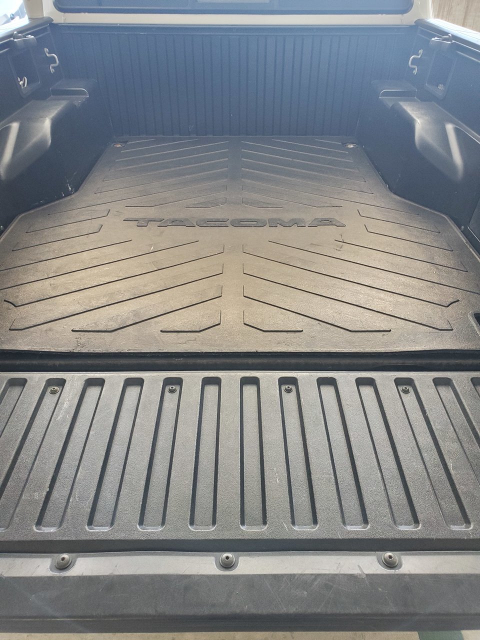

    Baby steps...
    No more stuff sliding around I'm my bed.

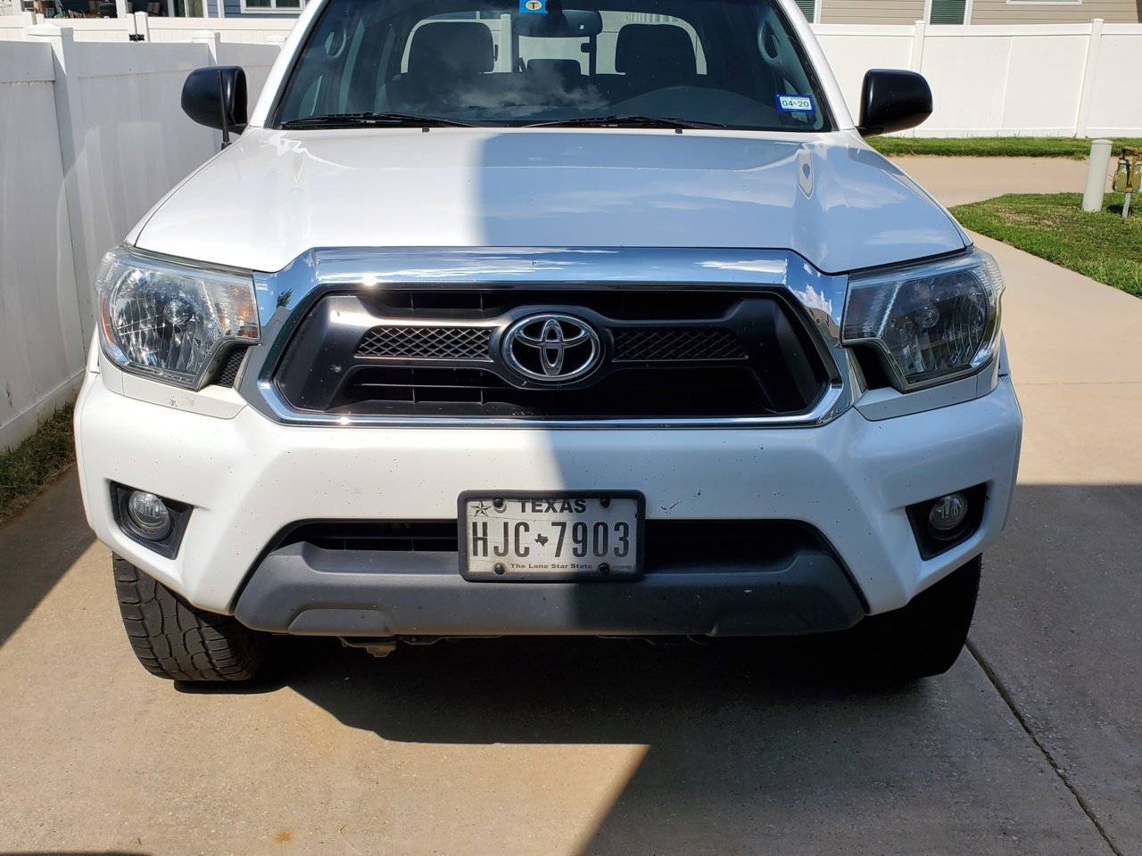

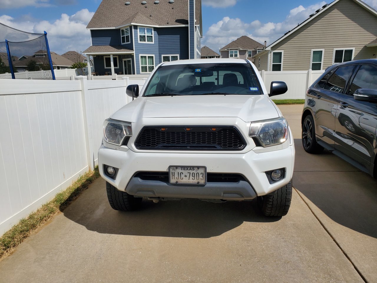

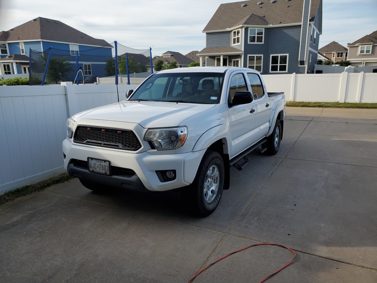

    First official mod. So it begins...
    Before
    After
    ChadsPride and Taco-Obsessed like this.

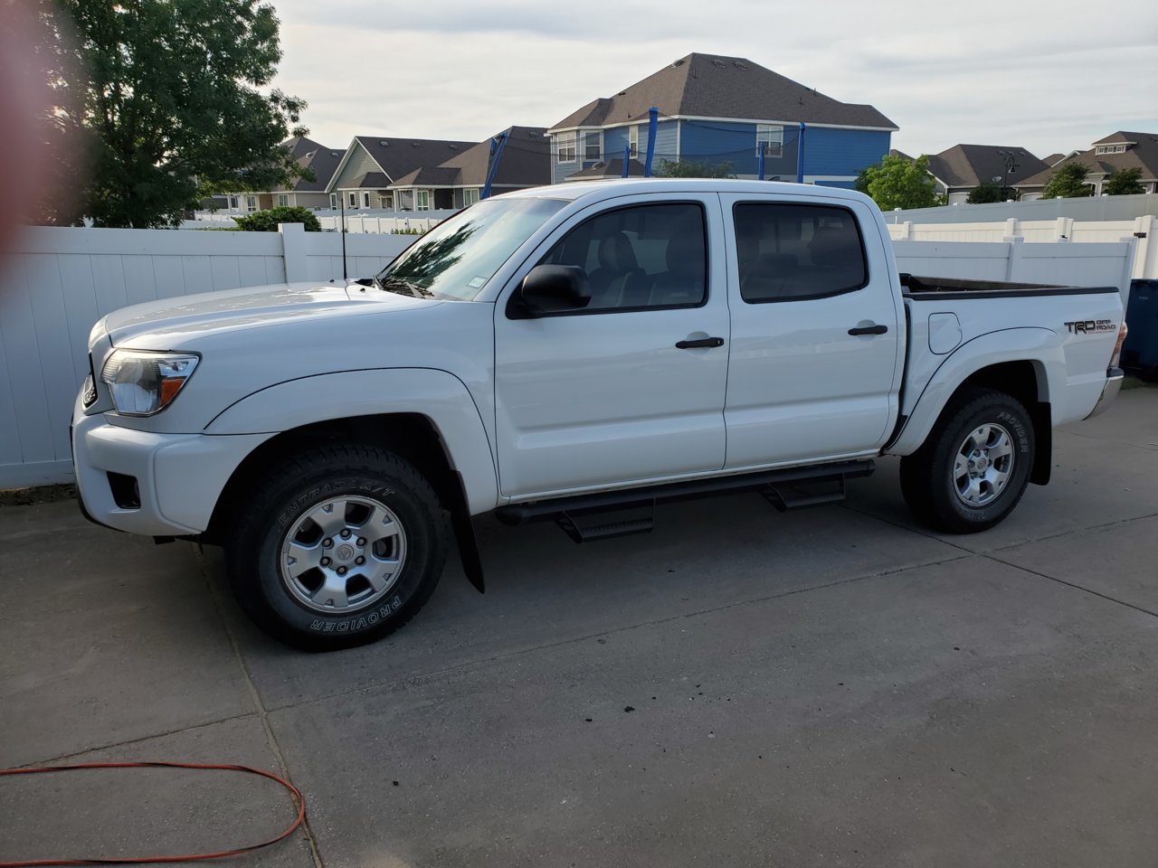

    Finally an update!
    Got a set of 3rd gen Predator side steps (thanks @IllTrucko).
    I decided on these instead of sliders because I have people in my family with short legs that need to be able to get in the truck once I lift it. I'm not doing any wheeling that would require sliders.
    Also, de-badged the emblems. Now just have to decide if I want to take the TDR stickers off the bed.

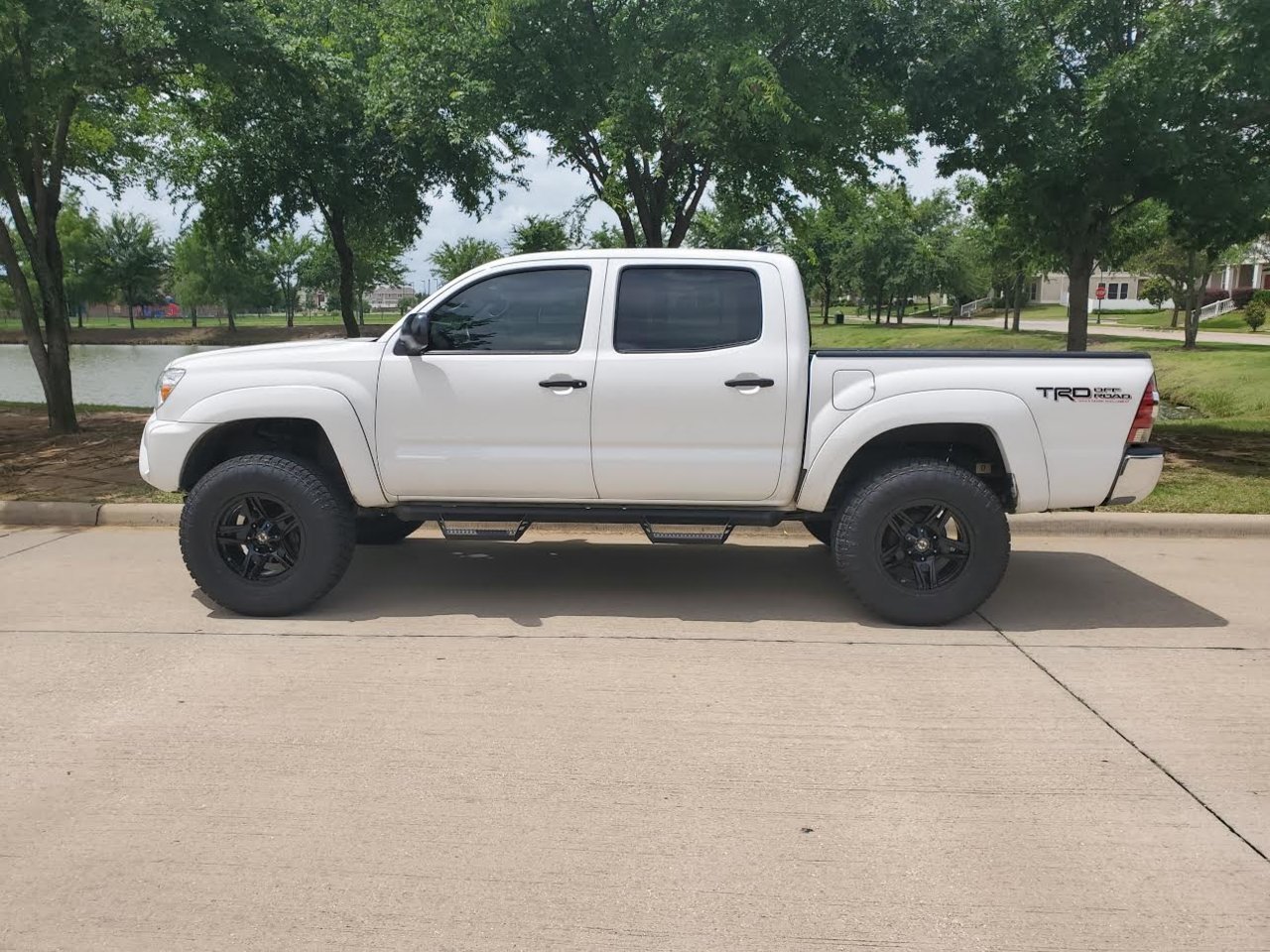

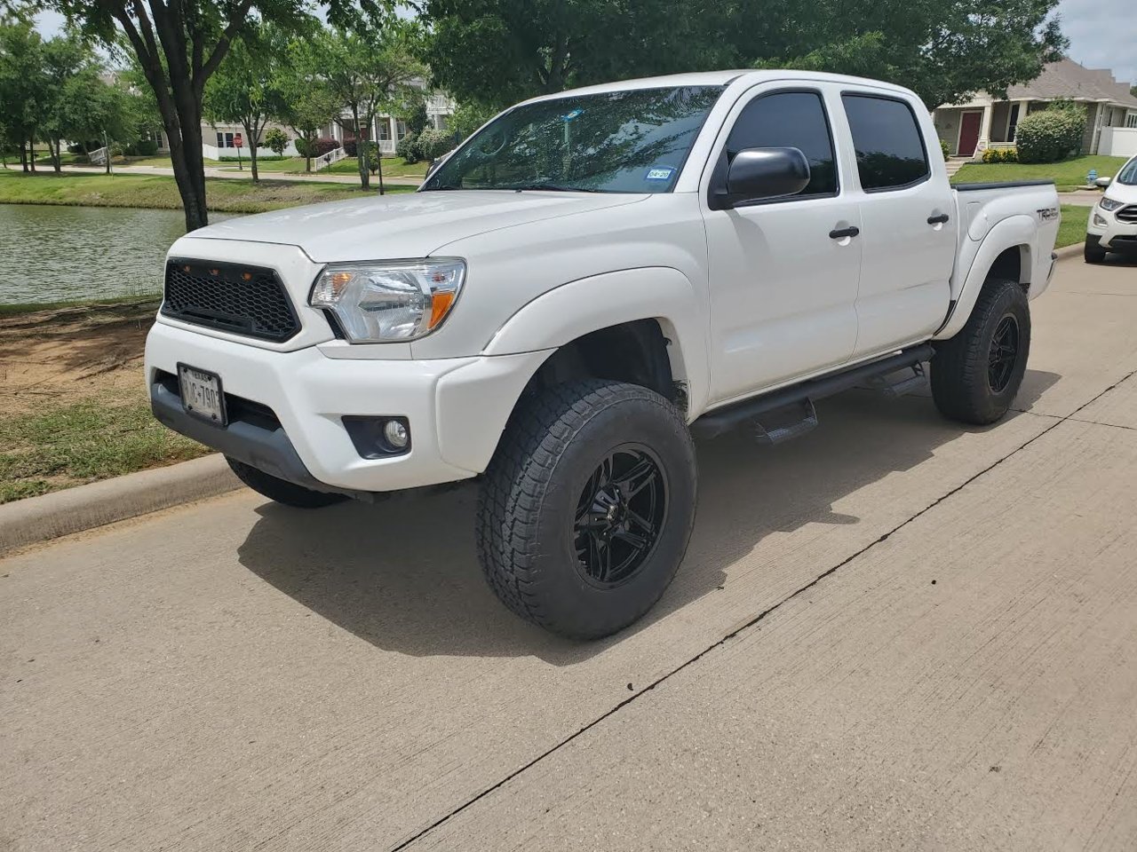

    Lift complete. 4 inches in the front, 2 inches in the back. New wheels and tires add an extra inch. Center fender to ground measures 39".
    One spindle went on smooth as butter. The other fought me the entire time, from stubborn bolts to a bad tie rod (replaced).
    The biggest pain, though, was adding the 2" blocks and new shocks in the back. Getting the pins in the blocks to line up with both the springs and the axle was a pain in the butt. And somehow, I ended up way out of toe on the rear. I had to use a come-along and ratchet straps to get everything to line up again.
    Got the alignment done today.
    So far, very happy with it. Looks good, rides good. Now I just need to give it a good cleaning. We've had thunderstorms off and on all weekend, so not good weather for cleaning a truck.

    Only a slight rub at full lock in reverse on the cab mount with the 285s. Just slightly rubs the very corner of the mount. Don't know if a cab mount chop is worth it or not. Maybe a little hammer work will take care of it.
    Interestingly, it didn't rub before the alignment. I must have had more caster in it before.

    As I said, the tires just barely rub. After running them for a few days, I decided not to do the full cab mount chop. Instead, I cut away some of the plastic and folded over my pinch welds. I then took an angle grinder to the corner of the cab mounts and ground it down some. I only took off maybe a quarter of an inch, not enough to cut all the way through the mount.
    After a few days of driving, including deliberately turning the wheels at full lock, I have not felt any rubbing. If there is any, it's so minimal as to not notice.

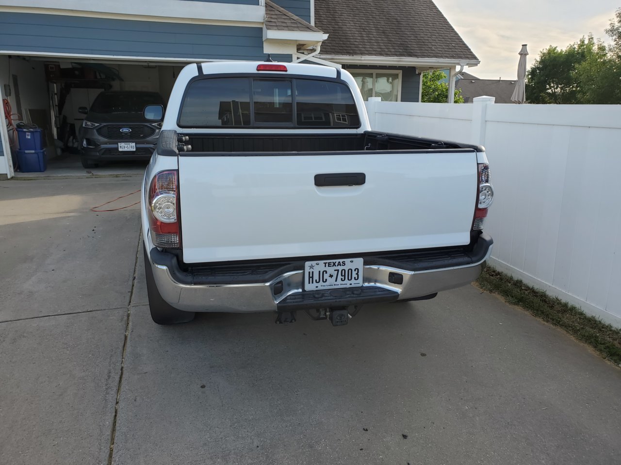

    The rear spacers have been in for a while. However, I've been dealing with a severe eye infection for the last 3 weeks that has hindered my vision. Hopefully I'll get to where I can see soon and get these spacers on.

    Eyesight is finally improving. Got the rear spacers on. Now the rear width matches the front.
