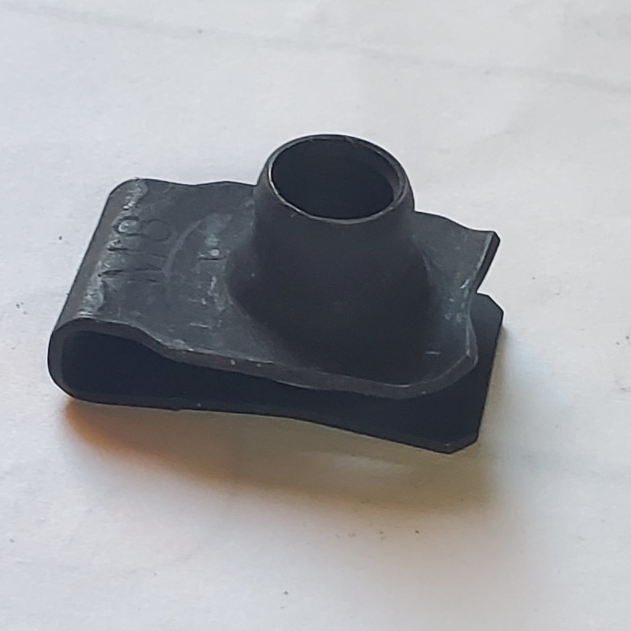

    The Sequoia has 4 wheel disc brakes and the Tundra has front disc and rear drums. To use the Sequoia you would have to install rear disc brakes as well.
    If you have a drill, drill bits, and a hacksaw/grinder with a cut off wheel you can make your own. 0.125"x0.75" flat bar bent into a yoke and use a 10x1.25mm speednut to attach the yoke to the booster.
    There isn't any pressure on the yoke that would cause it to separate from the booster's actuating rod. All of the pressure forces the yoke onto the actuating rod.
    Someday I'm going to offer a Tundra booster/MC install kit for a Tacoma and it'll be less than $30 shipped. I have other ideas in front of this one. I'll also offer one for the Sequoia booster/MC for the same price. $190 is absolutely f_______g ridiculous!!

    Looking at the other guys setup in the post you referenced it looks like I could substitute either loctite or epoxy and place of the welding. I have a machining station for making AR receivers...so the "flat bar" part is handled. Its just not a full on CNC machine.

    I'd have to see what you mean. It depends on where you're planning on putting the epoxy.
    You could use 2 regular 10x1.25mm nuts instead of a speednut as well. There's no pressure whatsoever that would separate the actuating rod of the booster from the yoke.
    I definitely wouldn't use epoxy to mate up 2 yokes.
