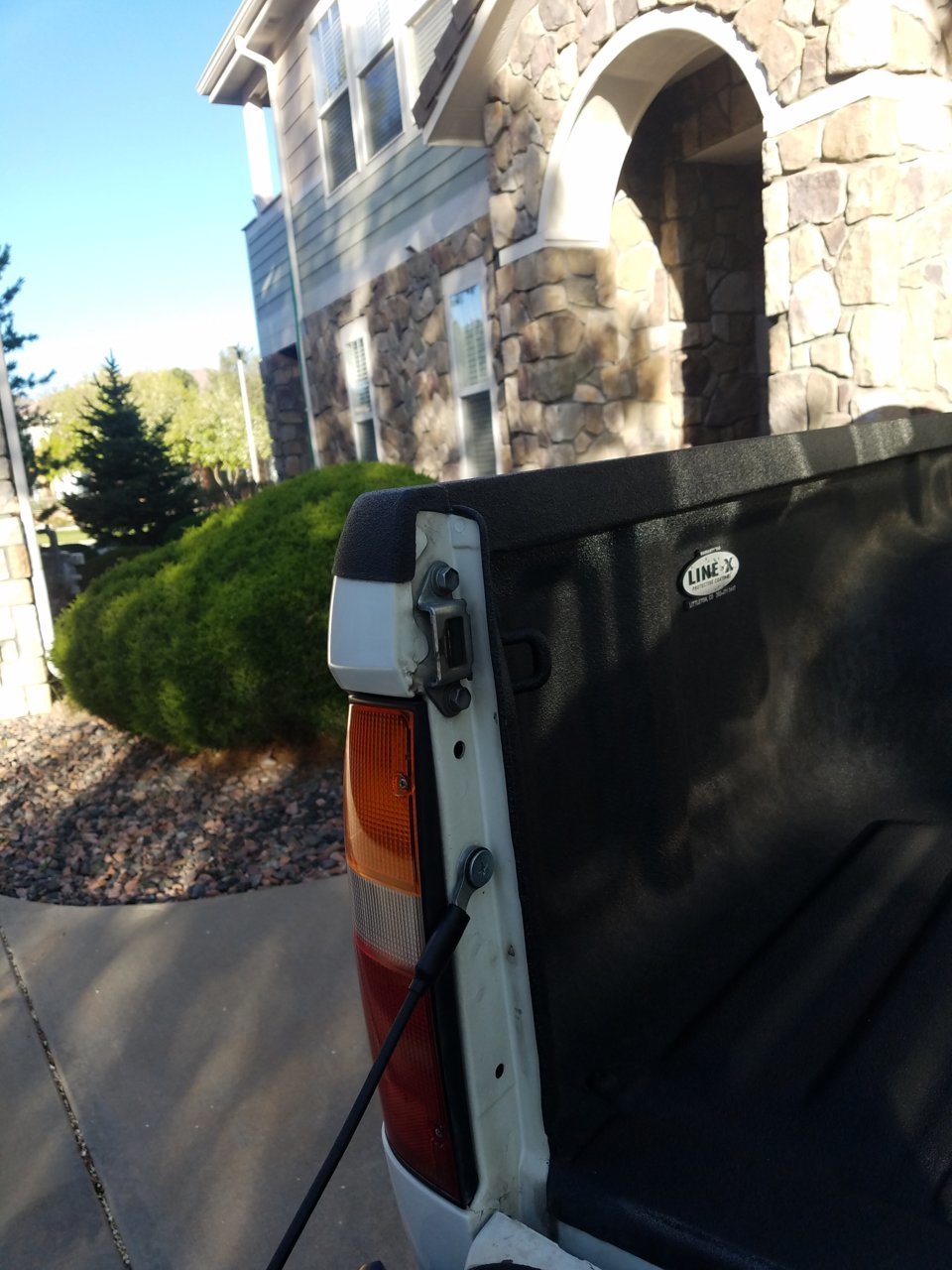

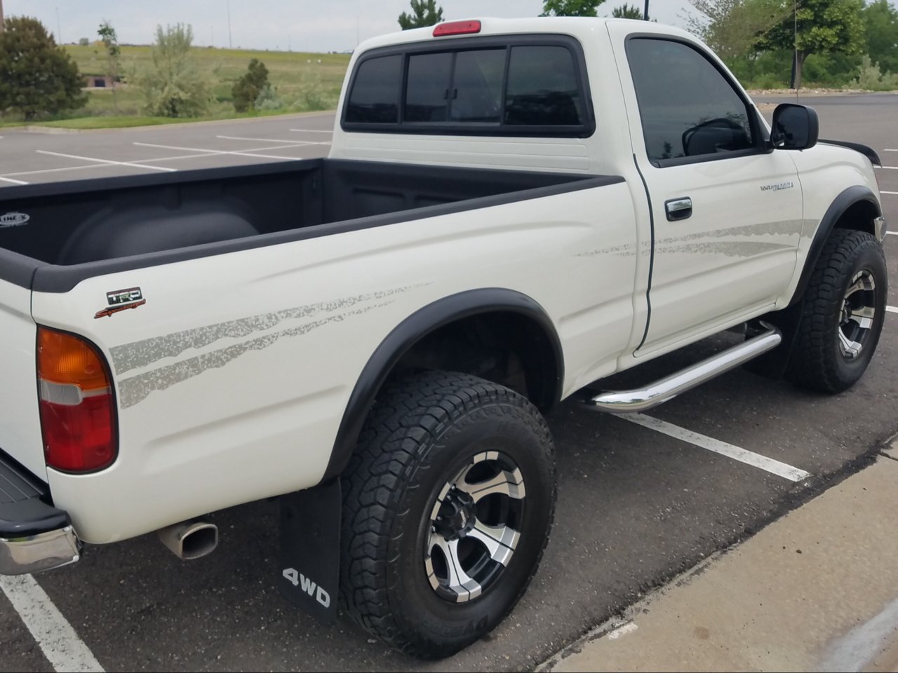

    It’s 2 stage and it still needs to be buffed :)
    This was the day after it was painted in my Tahoe back seat area

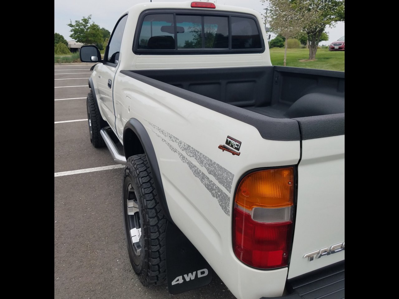

    White is reflective and lasts the longest of all colors because of that

    Both truck sides shown here are original paint with almost 600,000 miles to boot.
    White wears the best of all colors.
    I had a black 240z years ago, was the worst color ever for maintenance

    600,000 miles. I’d be happy if I could make it to 300,000. Doesnt look bad for that many miles

    J A Y

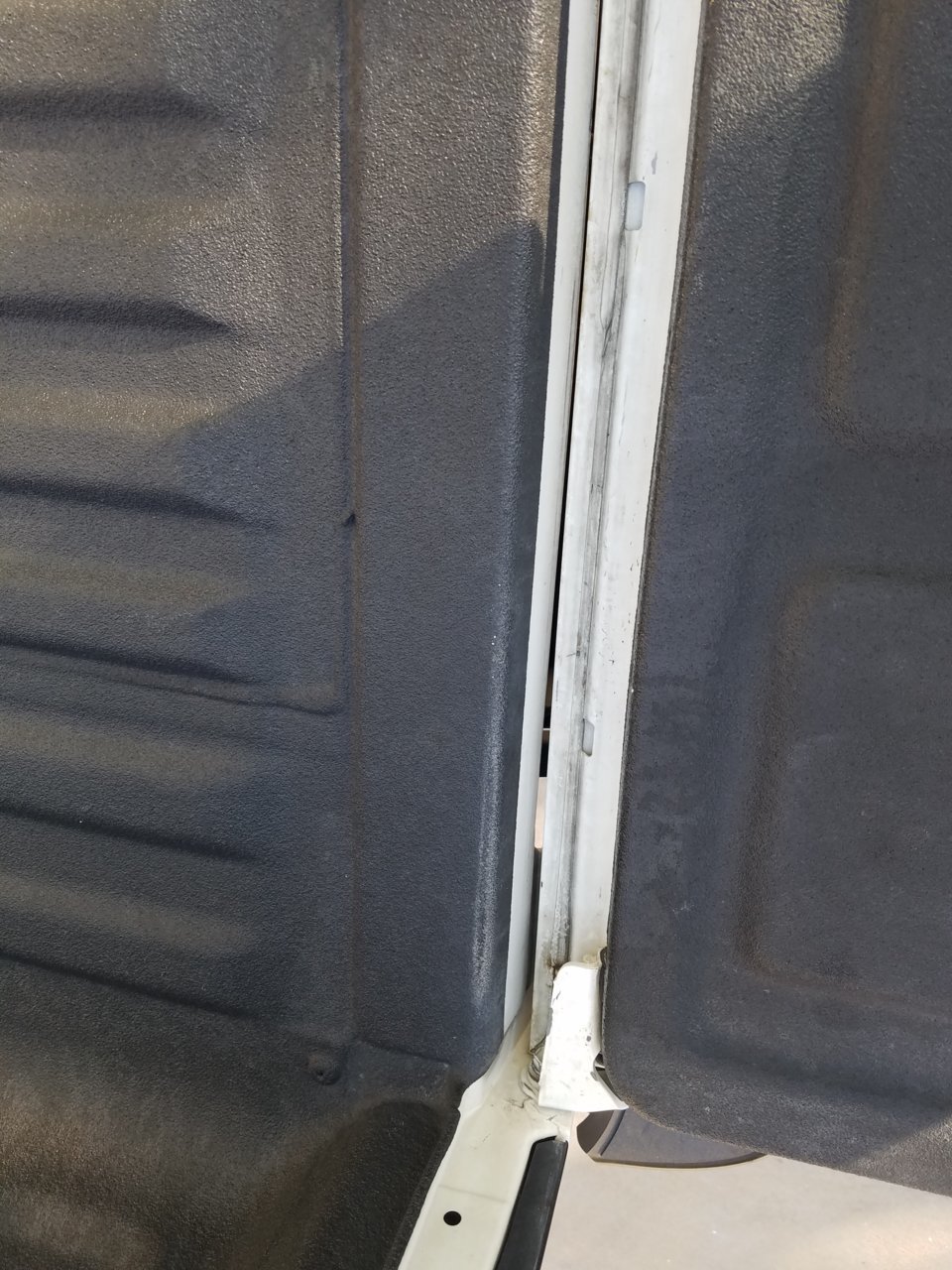

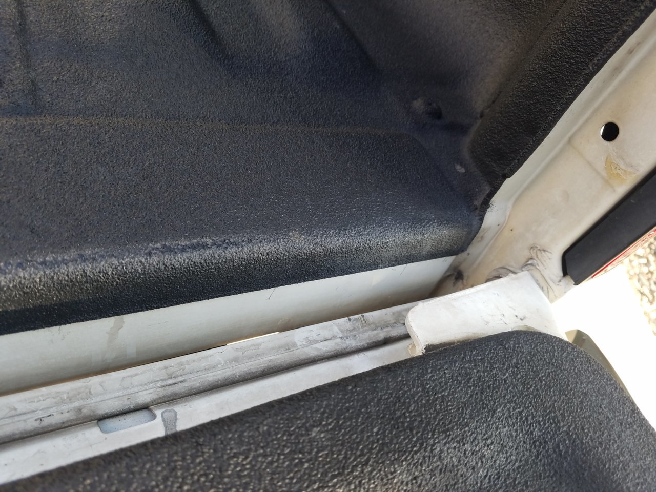

    is that LineX the premium (darker/more sparkle) one?
    what's the liner look like with the back gate down?
    must make sure mine is done right! (before they do it)

    No. Was the next step down
    GQ7227[QUOTED] likes this.

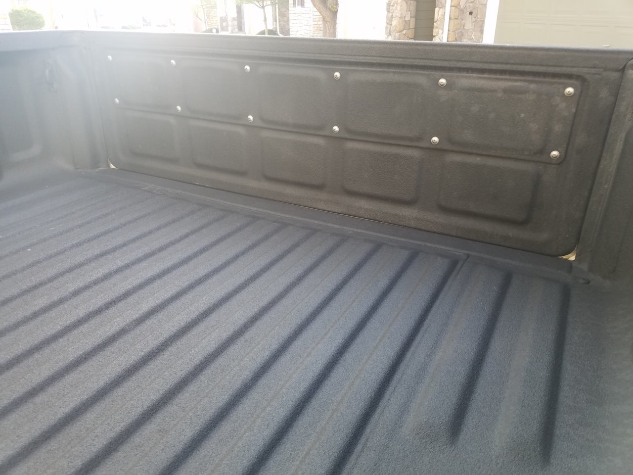

    I decided on this type drop, there are different styles to pick from when u have it done

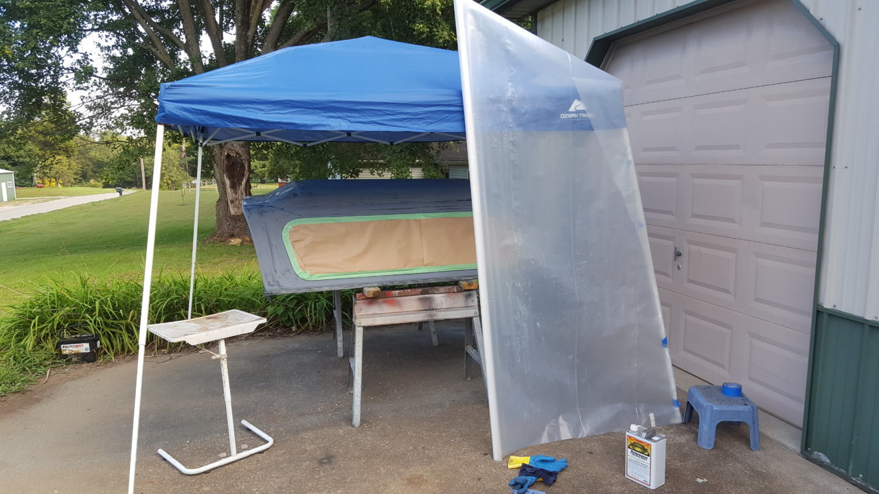

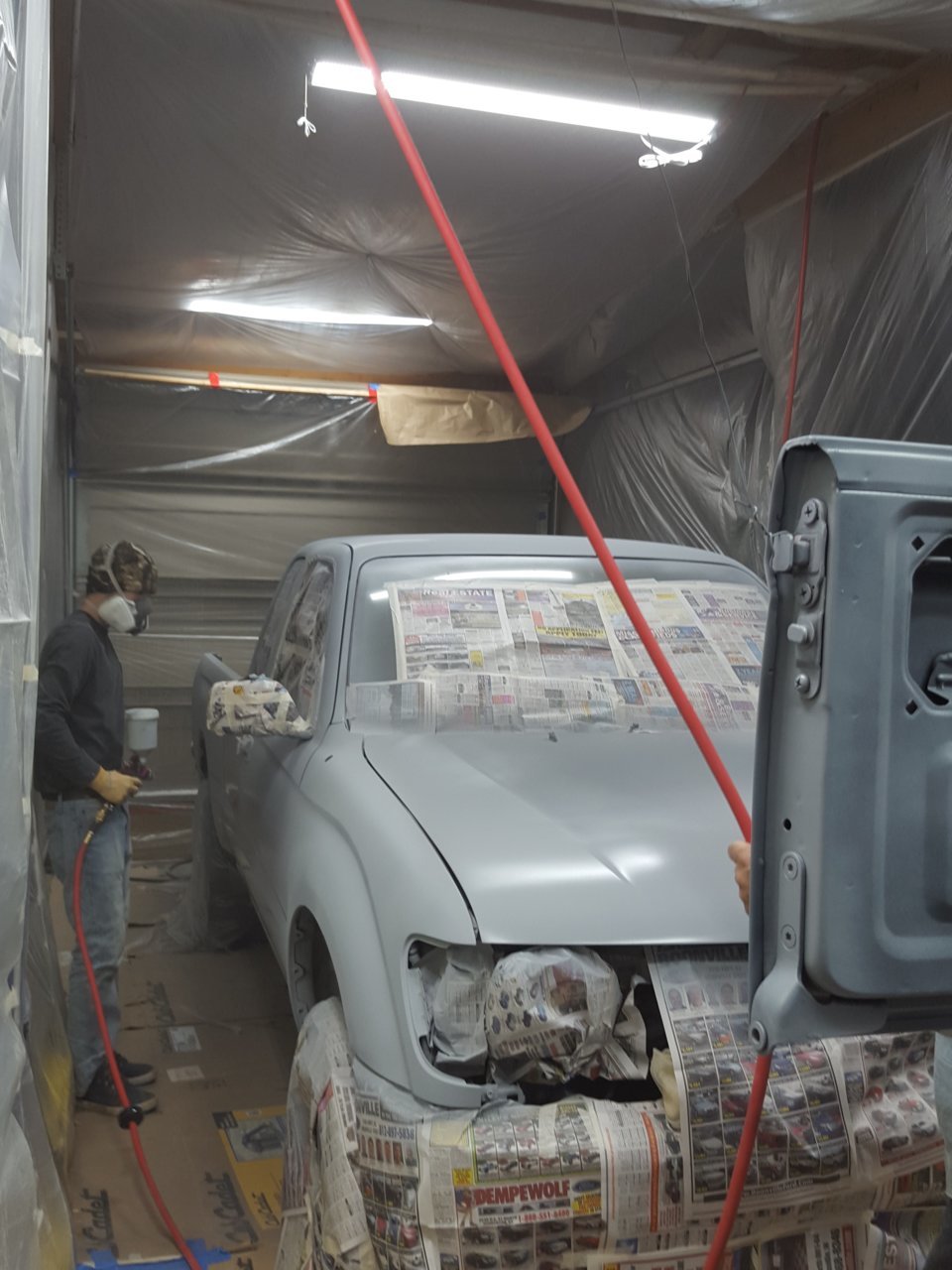

    Strictly amateur here.
    I painted one of mine, and am prepping the second for a partial (hood, 1 fender, roof, and bed cover) due to it being wrecked and faded on top/bedcover.
    On the 1st truck, same color repaint, entire truck after replacing a lot of metal. I did a fair job of prep and got a fair paint job in return. I never buffed it so shine is only moderate. May buff it this Summer as time allows, but I am okay with it as is. I am not too picky on these older trucks. It's over two years old now and still looks the same. BTW, more shine = more visibility to the prep flaws.
    Block sand any body filler, then wet sand with several grits (ex 400, 600, 800). Make sure to use degreaser as a last step and do not touch after that. Mixing the materials is well spelled out on the containers. Just get a glass or plastic measuring cup or two and the paper funnels/strainers at the paint shop.
    I have 60 gallon compressor. Worked it pretty hard.
    I did make a plastic booth in my garage for the truck, then later another outside for the shell. Cheap 1x2 boards and very cheap plastic sheeting. I left the top open and used a HF exhaust fan to setup negative air pressure inside and exhausted it under my garage door. Mandatory or you'll see nothing once the spraying starts, plus the inside of your garage will change color. Just use a furnace filter to keep the paint out of your exh fan or it will be ruined very quickly.
    Materials were about $400 for Nason brand base coat/clear coat. Purchasing 1 gallon, I barely had enough paint with shell to get two base coats. I did primer the entire truck. The base coat is fairly forgiving with regard to runs, but be careful on that clear coat. Too close and it runs, too far and it drys, especially in hot weather.
    Again, just novice advice. Take it FWIW.

    Eventually closed in 3 sides, no breeze/dust that morning.

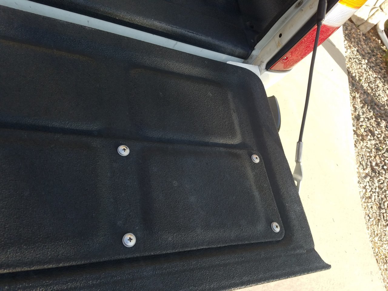

    any with the tailgate down?
    are they supposed to go to the edge of the bed, a little bit from the edge or down & over the edge to the bottom?

    V6 5sp,RegCab,TVS1320 Supercharger, 56mm pulley, methanol injected Haltech ECU, AC Tvs1320 supercharger,(MUST DO) every 125,000- 150,000 needs rebuild Projector headlights HID 5 speed manual Amsoil for all drive train Smaller 56mm custom pulley, (MUST DO) 2004 DESNO fuel injectors, zero ping ping, 2004 side door mirrors Dick Cepek Rims, Michelin tires LTX, ATM Pathfinders Dynopro ATM ( that last 100,000 miles) Now running Dynopro ATM mud and snow tires KN cold air intake Cat back dual exhaust with ss exhaust tip, Raised exhaust tail pipe to 2" below body line Optima*dry cell battery,red top Alpine sirius radio, 200 watt amp, focal is165 split door pod speakers Focal door speakers Subwoffer behind seat Viper alarm, Electric Locks Dark tinted windows, bucket seats corbeau lg1 Tacoma Rubber floor mats TRD fender extenders, Bilstien shocks, King shocks JBA UCA trailer iv hitch, electric brake control, Drilled slotted brakes, High carbon steel (MUST DO) EBS green stuff 7000 series pads(MUST DO) TRD engine oil cap TRD stick shift, Marlin crawl shift kit. Rear sliding window 2002 4Runner functional hood scoop cut into Tacoma hood, 4Runner dual overhead map light Gentex Auto dim + Compass + Temp, garage,rearview mirror Snow Methonal kit stage 2 Custom 3 core aluminum radiator Linex bed liner Haltech stand alone ECU, Intake supercharger gauge. Stainless steel brake lines, Custom leather wrapped steering wheel, Haltech stand-alone ECU,
    Tomorrow when there’s light

    thanks, this is a big (permanent) investment lol
    gotta make sure its done right and I won't need some bare metal spots that are near the edge (under current plastic liner) repainted before they oxidize.

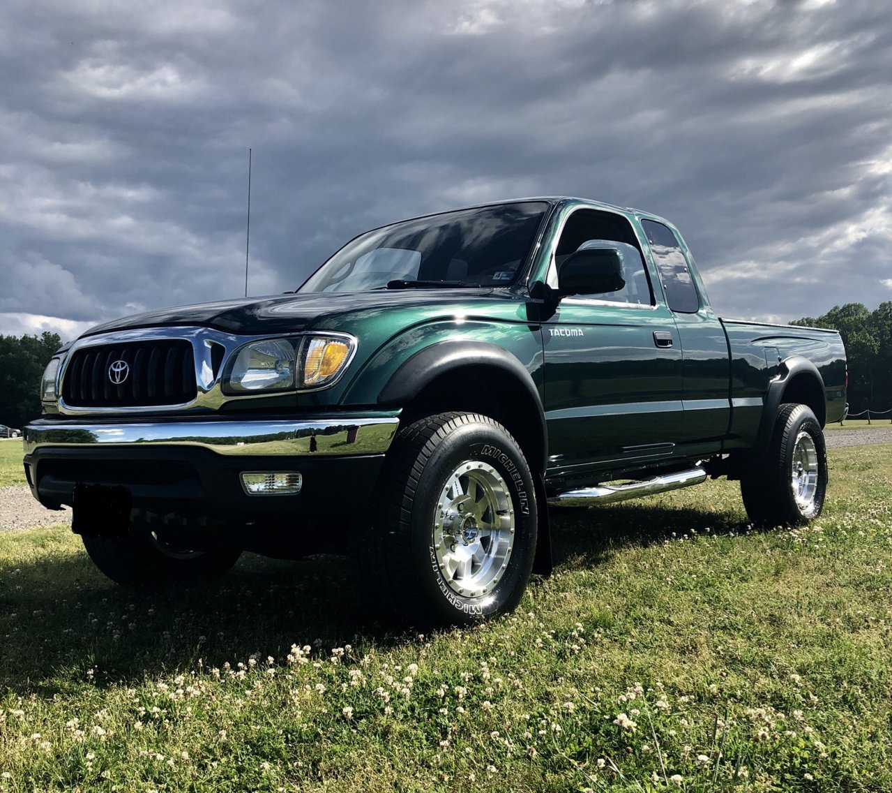

    AC67BE6D-1580-4D2C-AA88-48CA074CF647.jpg I went to Maaco, had their base coat/clear coat job done the first part of March. It is my DD so I wasn’t looking for a multi thousand $ paint job, but wanted something to freshen up the original paint. That was nearly 3 months ago, and so far I’m very happy with it, no unpleasant surprises at all. Unless specifically noted to fix prior to, which costs more $, they paint over what is there, but I knew that going in. I had a couple of places that took some extra work. I’m giving it plenty of cure time, so haven’t polished and waxed it yet, that will be soon since the days are much warmer now. The paint job has a 5 year guarantee, we’ll see how it goes. I tend to keep up with paint care, maybe I can stretch that out a bit.
    As an aside, since the paint job, I’ve had 2 unsolicited cash offers to buy it, in the 7 years I had it before, I had 0. Might have nothing to do with it, the original paint was still in good shape, an unusual coincidence though.
    A pic from a few days ago after washing it. The wheels were put on just a couple of days before. (The offers were before the wheels.)

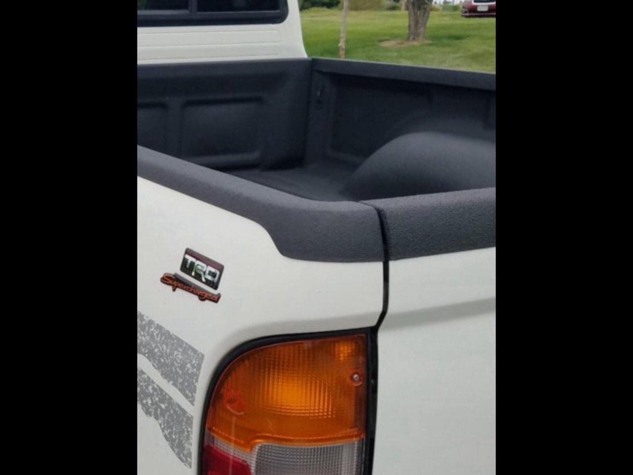

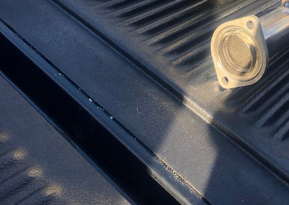

    does water drain out the back (gate closed) pretty easy with the liner over the edge?
    does not look like i need to worry about the bare metal showing!

    Never really noticed, it doesn’t rain here very much, after car wash it all disappears tho pretty fast
