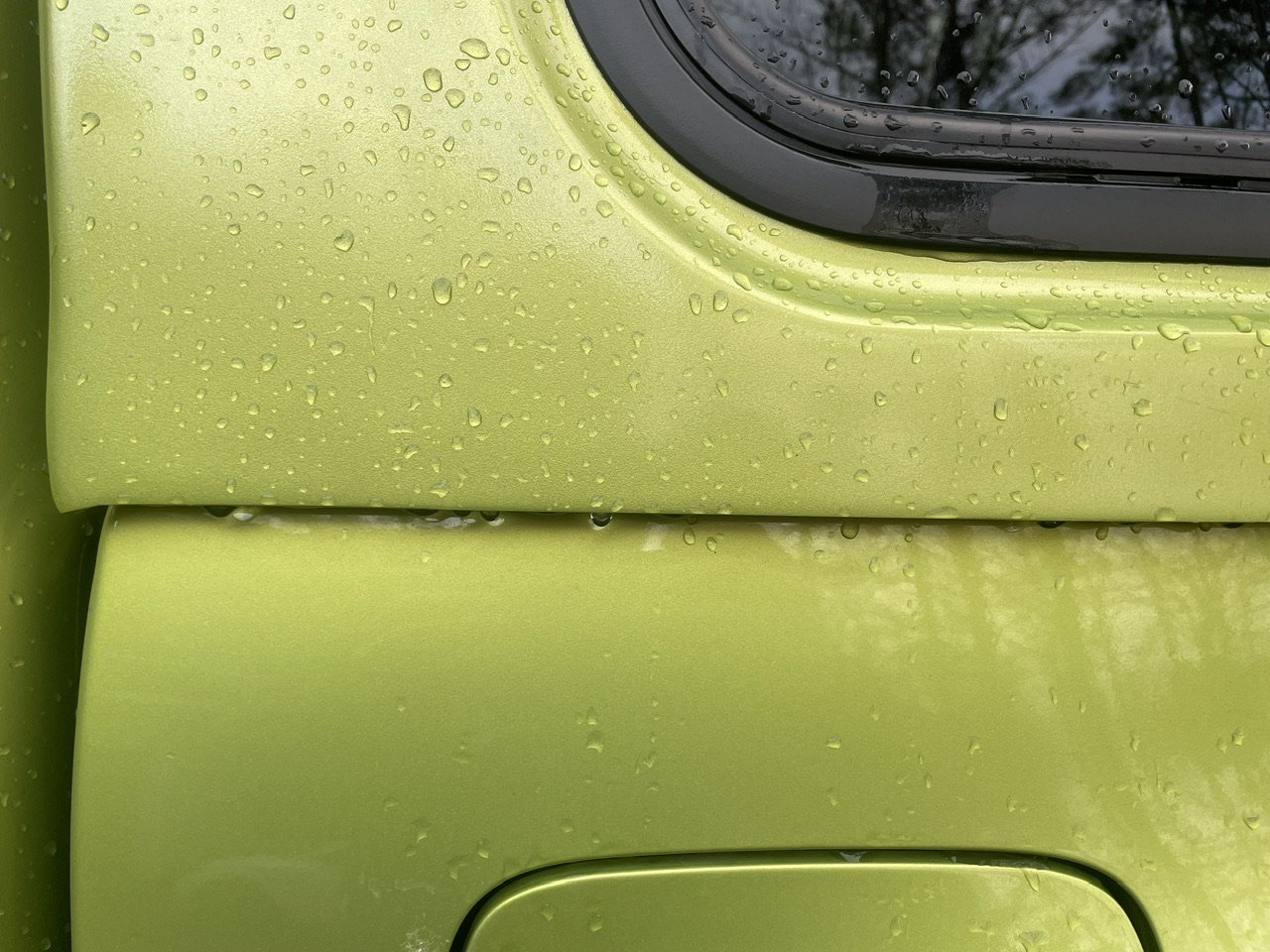

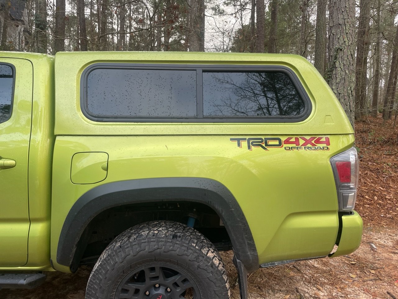

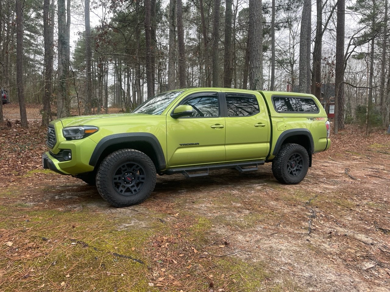

    I've had the shell back on the truck for a few weeks now so I thought I'd post up some pictures of the finished project and wrap this up.
    In total it took me about 25 hours of work start to finish to get this done. I spent about $400. Most of the money was spent on paint. I bought color matched aerosols from Touchup direct. I bought their kit with primer, color, and clear together and I bought 4 sets the total cost for the paint was $280. The rest of the money was spent on sanding supplies, masking supplies and new seals for the windows.
    The paint does show some orange peal and when you look at it in direct sunlight you can see the difference in reflectivity. You really have to look closely to see it though. I'm pretty sure I could have got a better finish if I'd have waited for a warmer day. I had to spray when it was about 55 outside.
    Overall, I'm pretty happy with the way it came out. I've received several positive comments so I'm going to call it a success.
    Overview
    The shell
    Close up. It looks better with some rain on it.

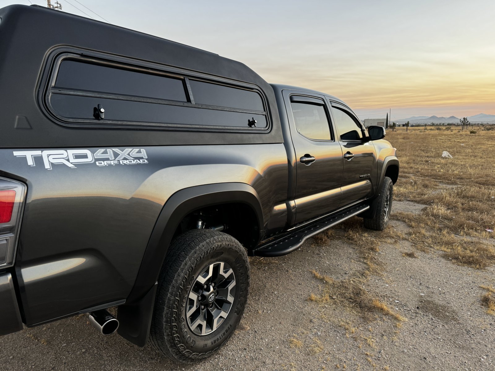

    I appreciate that. Like a champ! Sits in the sun most of the year in so. cal... Seems to not have faded at all. I haven't had to retouch it and zero pin stripes from a few trail runs. I thought for sure that I would need to do a touch up sesh once a year... pic taken 2 weeks ago... so it's been almost 1 1/2 years. You can see some imperfections on the sheen around the windoor from when I painted it and it got windy.. Id highly recommend a sawzaw paint can shaker, shake each can like hell, I also warmed up each can a few minutes each in a hot bucket of water... and also a rattle can holster/sprayer
