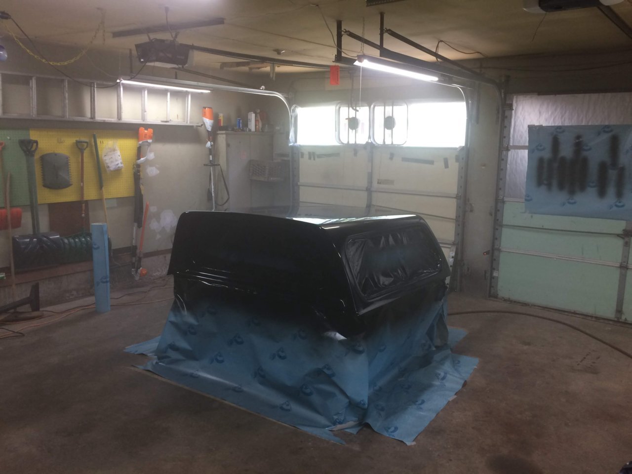

    I've painted a few vehicles in my garage. It takes a lot of prep and auto paint isn't cheap.
    Look up Kevin Tetz. He has a number of painting videos.
    Next, find a local auto paint supply store. I use the PPG Concept line. Also, you need a healthy size compressor - at least 15 CFM at 90psi. Larger the tank the better as compressing air will squeeze the moisture out of it. Water in the lines will ruin the paint job. Always use the same line of paint from the same company to prevent compatibility issues.
    2 to 3 coats of a high quality clear will give an excellent deep shine. Read and follow the tech sheets and make sure you use proper PPE.

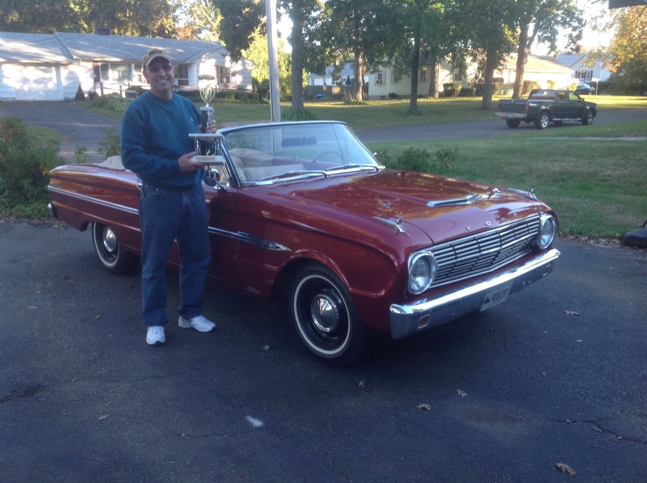

    Here's a cap that I sprayed for @Cativelense last summer and my 63 Falcon that was painted about 10 years ago all in my garage.

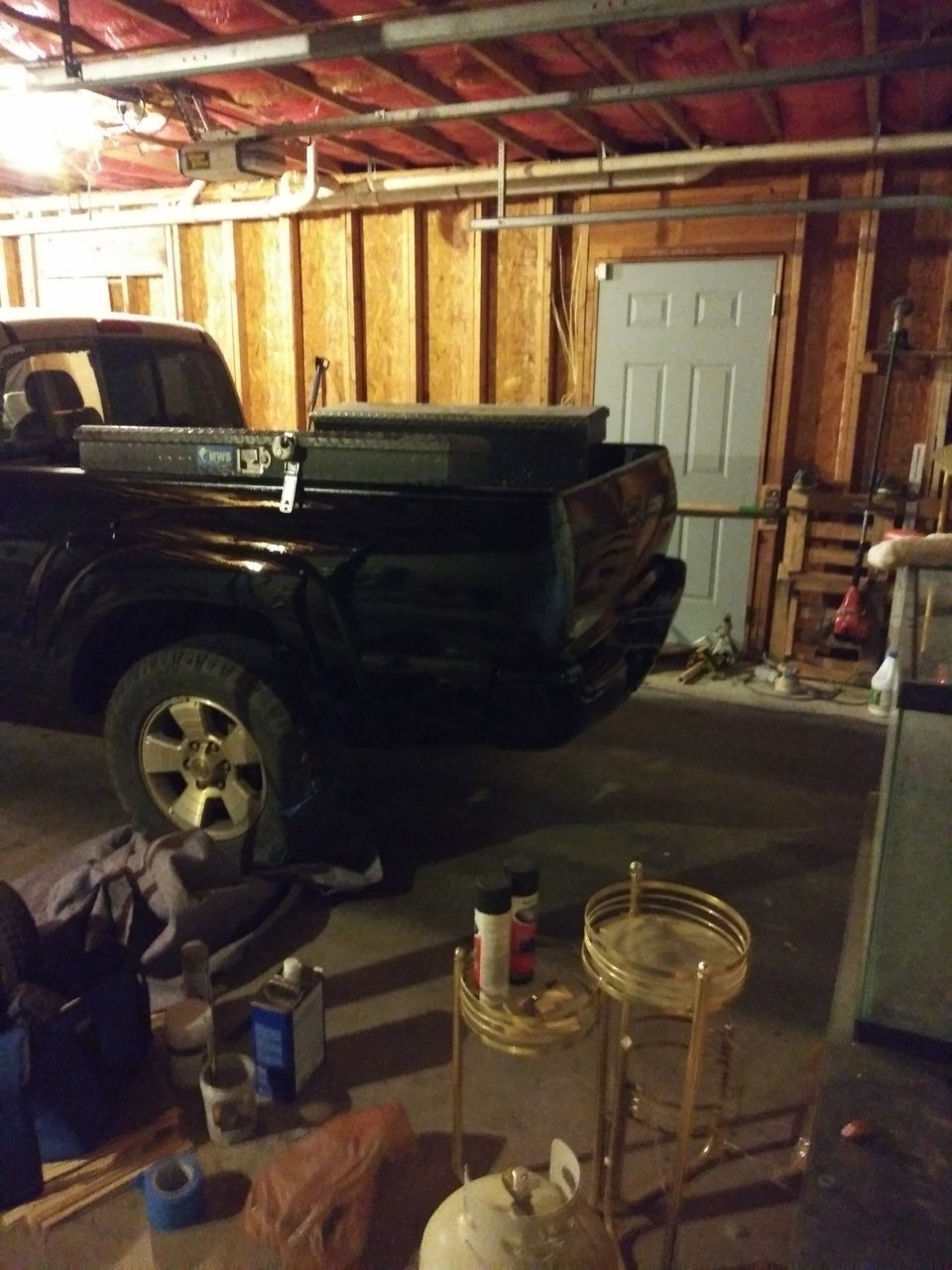

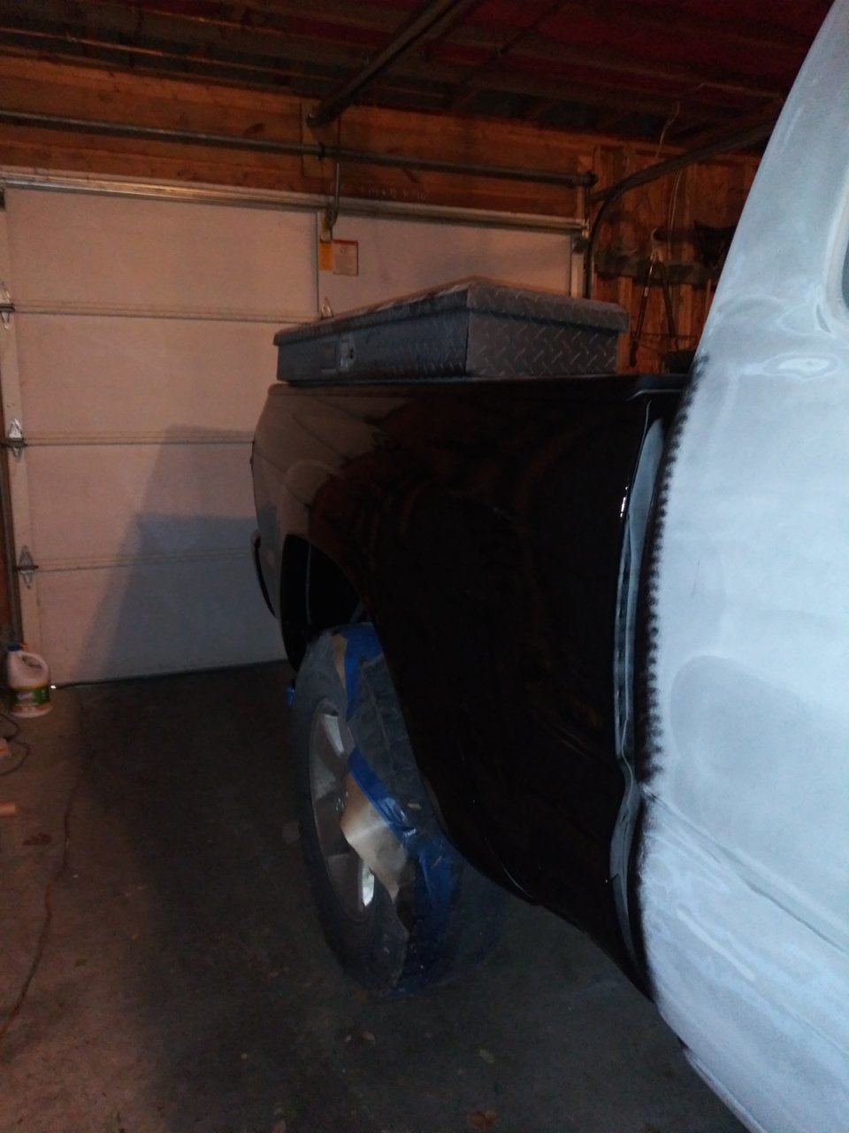

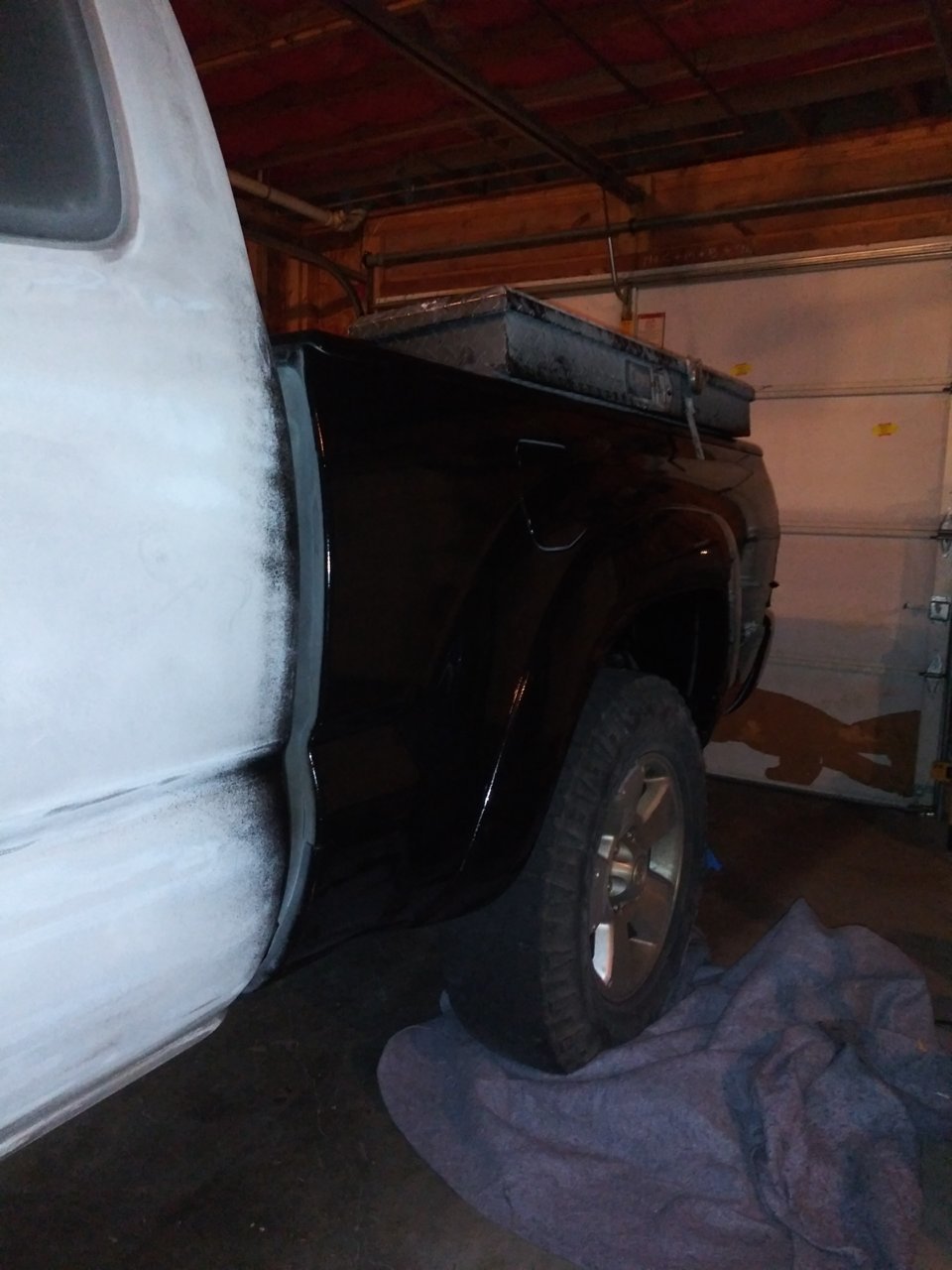

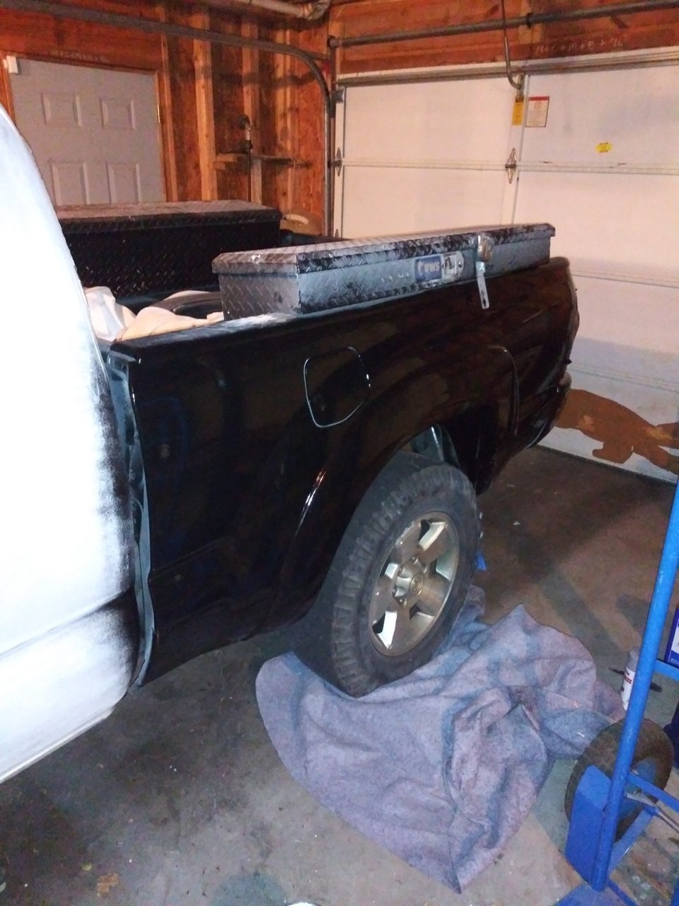

    Got the base on the bed. Kinda wanted to test it. Not bad. We'll see once i get clear on.

    Going to look sharp once i get those new factory rims on.

    Just a suggestion, lock the garage door, remove the top panel, tape the opening off with plastic, and insert a box fan or two to ventilate. It'll pull the overspray out so it doesn't settle on the paint. Furnace filters in a window or man door for make up air would be best - if not, you'll negativity pressurize the house which isn't necessarily a bad thing when painting a car. Just watch CO build up from the furnace.
