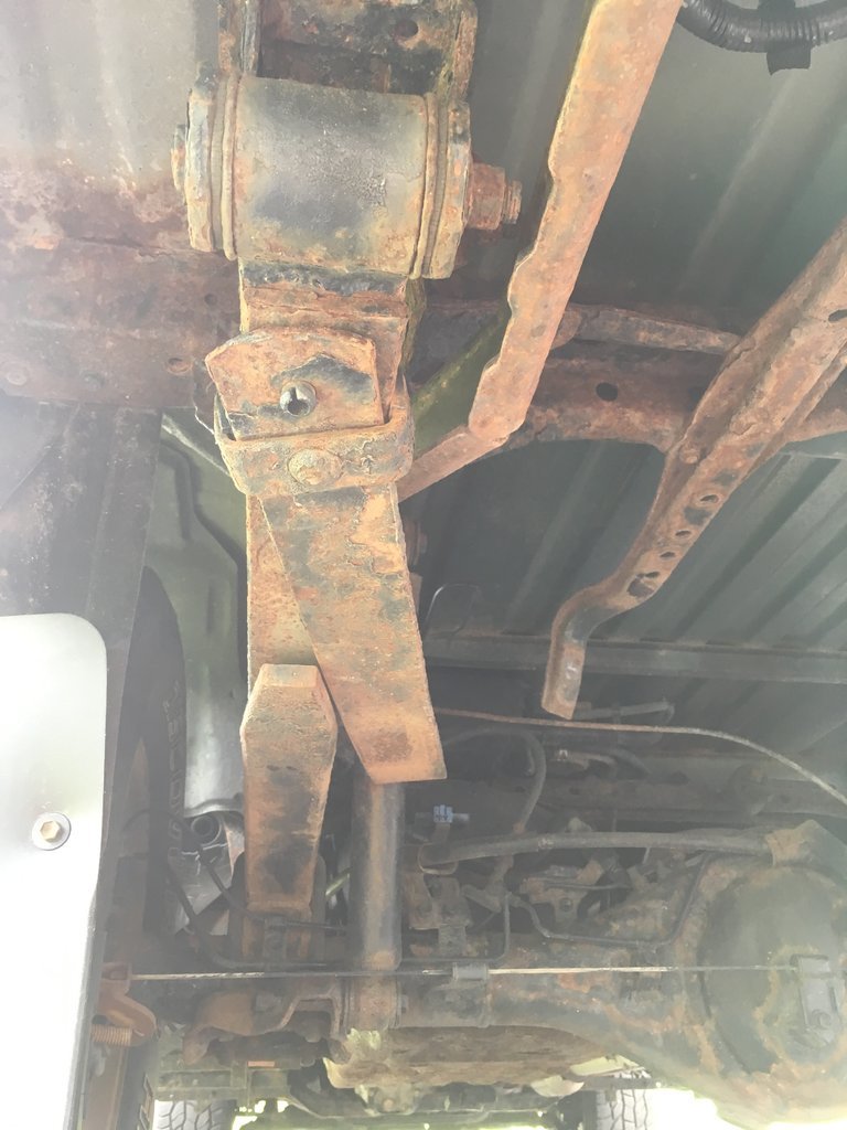

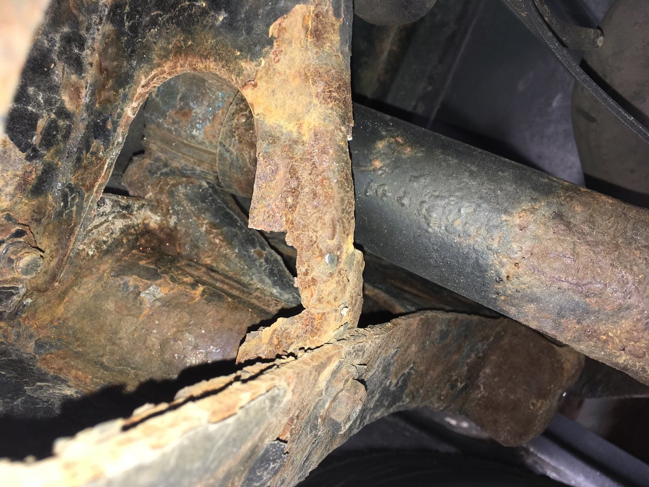

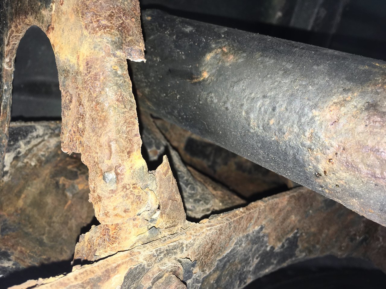

    Attached are images of my rear leaf spring and a rear middle frame crossbar. My truck isn't eligible for the warranty frame replacement, so what am I looking at in costs?

    Uh oh, with this amount of rust on your frame, you should definitely check if it hasn't rotted elsewhere.
    Rust on these frames is pretty nasty. Can look solid from the outside, when in fact it is paper thin. Bang on it with a hammer, especially where the leaf springs attach to the frame, right behind the cab, as this is usually the first place where these frames rot. Also, the frame rails by the gas tank and the catalytic converter, as these are also commonly rotten spots on rusty frames
    The thing is that these frames rust and rot from the inside out, so the rust could be worse than what you can actually see on the outside. Try to poke a finger or something in the square holes on the frame rails to see how much rust chunks and flakes there is in there. If full, not a good sign, but it is the hammer that is really going to tell you if it's still good or not.
    Depending on how bad and where the rust is, it is possible to put some patches to a rusty frame. Though the cost will depend if you or a friend of yours know how to weld, as this is going to be less expensive than having a shop do it

    FYI. I had two shops recently quote me $1500 and $1685 to replace from the rear leaf spring to the center of the truck. One shop would use two sections of saf-t-cap and the other would fab their own. Estimates are for both driver and passenger side. For me it is worth it to invest in the repair.

    Welp. Shop said there's a definite hole in the frame caused by excessive rust but there's nothing that they can do because the previous owner didn't get the frame sprayed when the recall came out.
