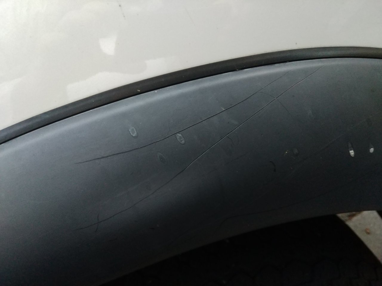

    Looking for DIY suggestions to fill long cuts made in one of the wheel well flares.
    I assume there is some grey colored polymer I can simply press into the grooves?
    All responses are much appreciated.

    A good cleaning and application of Mother's back to black will make deep scratches less visible.
    Never heard of colored filler for plastic fender flares.

    Epoxy and bondo and sanding and rattle can paint would work

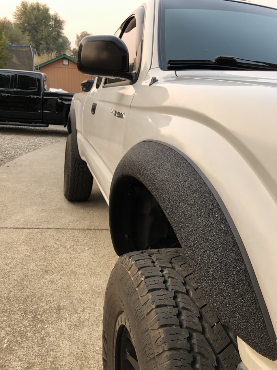

    Raptor liner is always your friend
