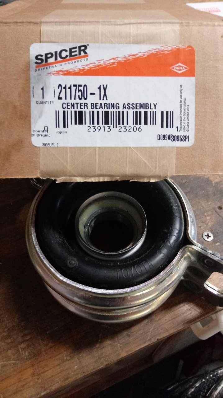

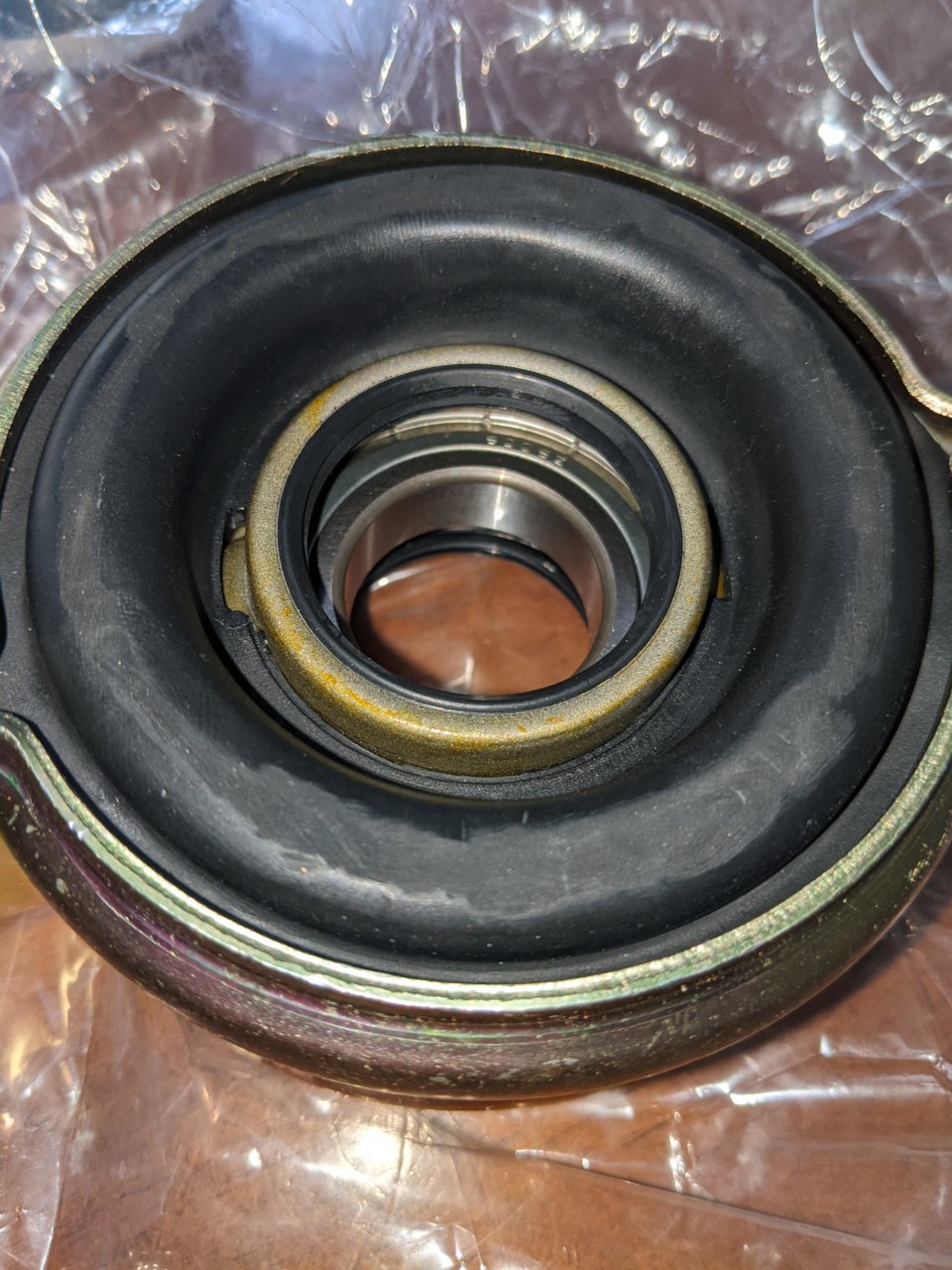

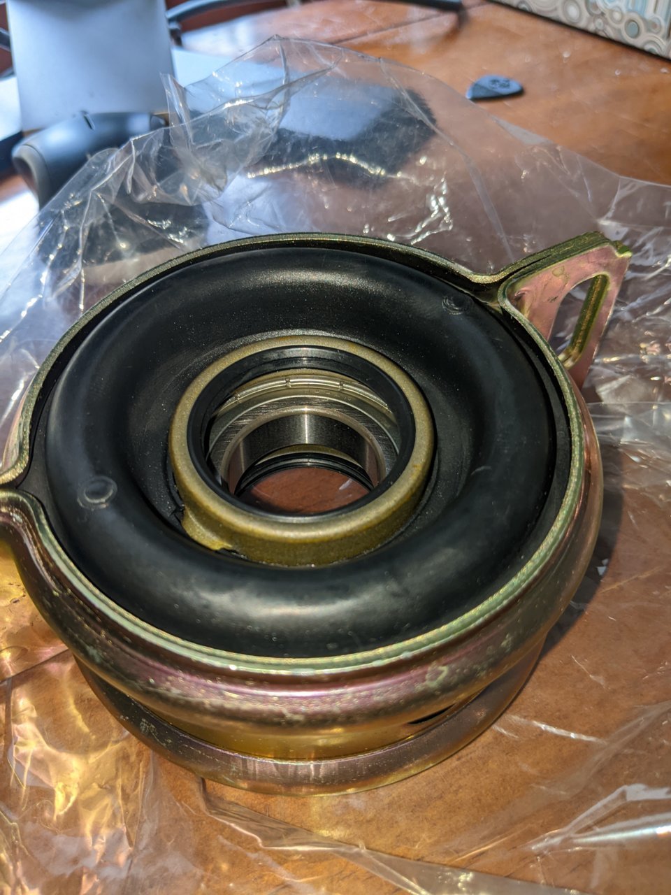

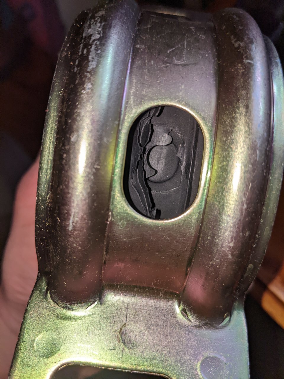

    Anyone have any detailed pictures of an OEM carrier bearing? This supposedly OEM one I bought on Ebay is looking suspect. The outside has lettering that was scraped off and the outside of the rubber inside of the mount looks a bit unfinished. The bearing inside is stamped KOYO JAPAN 6006Z. Not sure if the inside means anything, but the combination of both make me question if I am getting ripped off. I reached out to the seller. He responded with this...
    "Hi, I was told that some of these parts have access material from the molding and manufacturing process that requires removal at the factory.
    We get all of our parts from Toyota and Lexus and have sold hundreds of these with no problems. All of our parts also come with manufacturers 12 month warranty."
    #27
  8. Mar 30, 2022 at 12:10 PM
    #28
    eon_blue
    Mar 4, 2016
    #180213
    69,784
    Azusa, CA
    uh...yeah I would send that back. I got my OEM (Spicer) one off of Amazon via this thread, has the TOYOTA logo stamped on it with part # just like the factory one
    the one in your pic doesn't look like it has any grease in it either

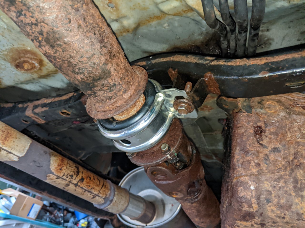

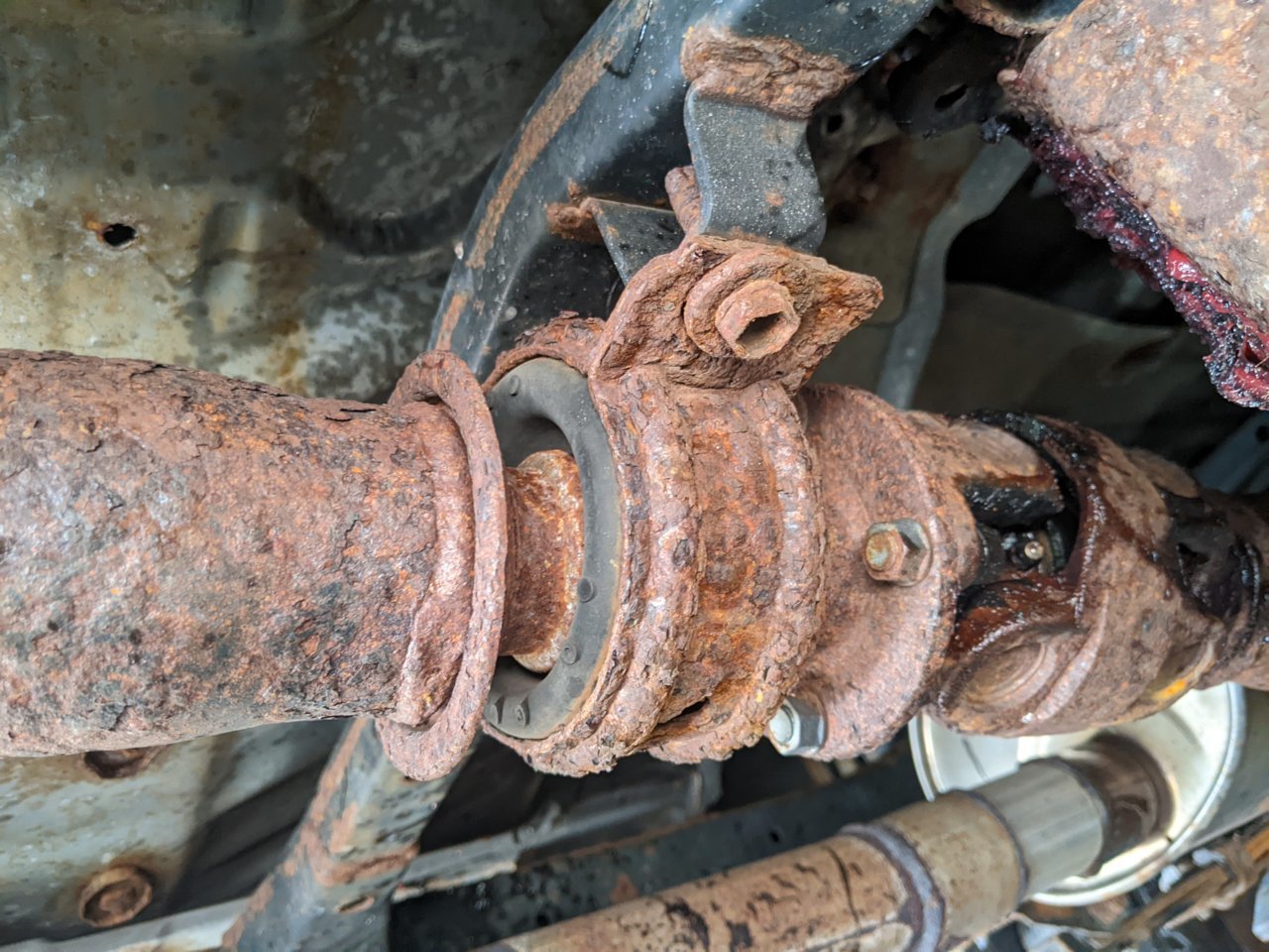

    Pictures just because... rust :(
    Looks like my next move is checking for play I'm the U joints and probably replacing ones that have play or replacing all if I don't find any movement. Not sure what else I should look into?
  19. Apr 2, 2022 at 12:53 PM
    #39
    Andy01DblCabTacoma
    Andy01DblCabTacoma Well-Known Member
    Mar 12, 2021
    #359086
    3,976
    Andy
    San Diego, CA
    01 Double Cab v6 4x4 TRD
    F: Kings SPC, R: 5100s+J59s. Custom armor.
    uh.... your vibration is likely due to how rusted your drive shaft is... it can't be balanced any more. don't throw money at that shaft anymore. you need a new one.
    Morden, eon_blue and ztwatson[OP] like this.
  20. Apr 2, 2022 at 1:09 PM
    #40
    eon_blue
    Mar 4, 2016
    #180213
    69,784
    Azusa, CA
    Man that is crusty... Didn't realize it was rusted so much. I would agree a new DS at that point is probably the way to go.
