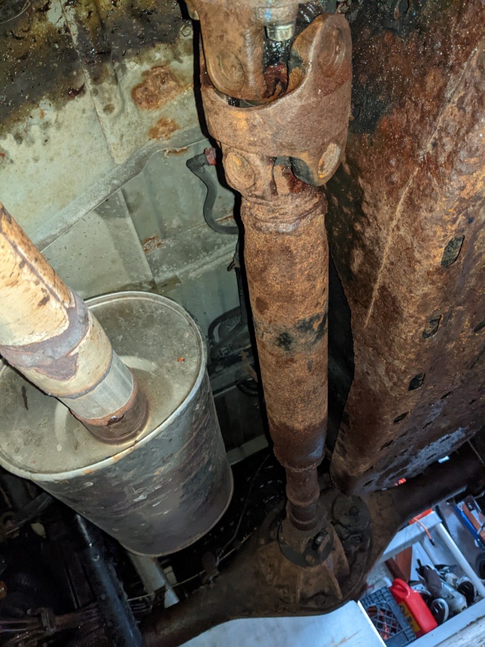

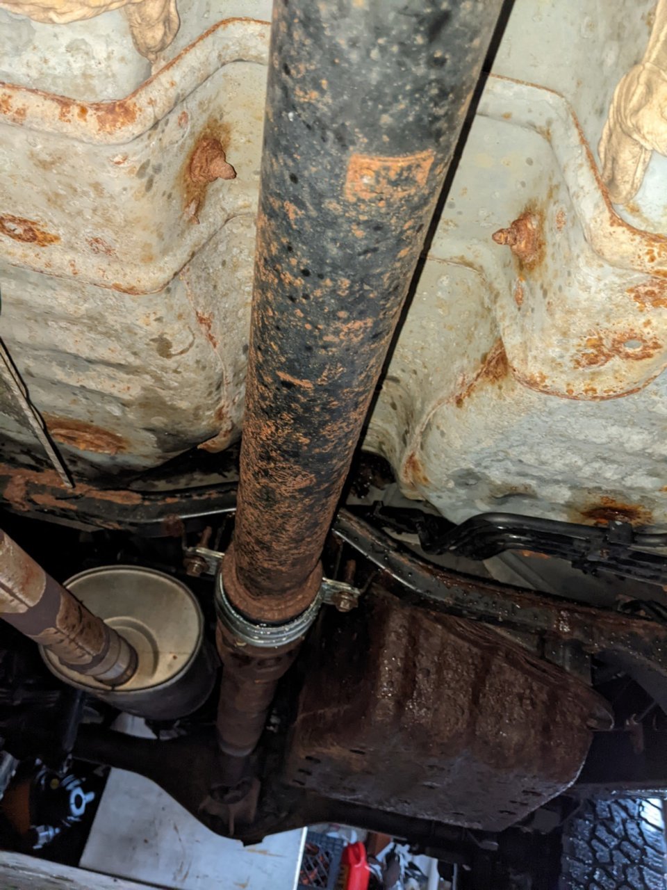

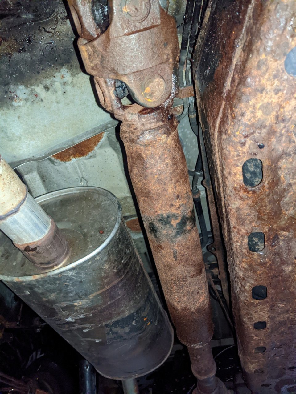

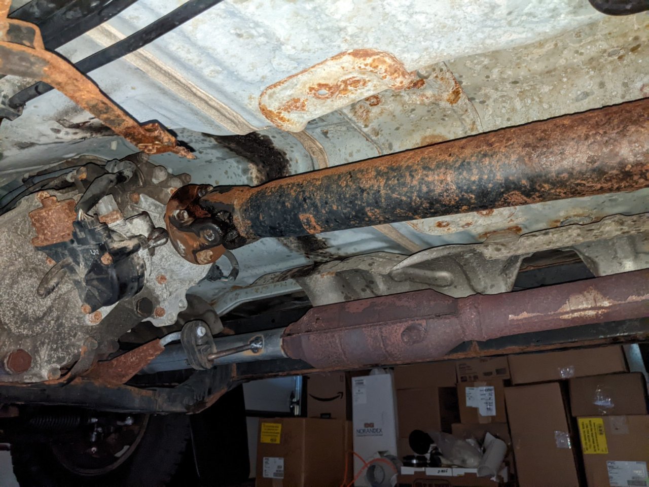

    More pictures for further input. The rear driveshaft is definitely worse than the front. Is there a way I could confirm it was the rust of the driveshaft causing this issue? I don't feel any play in the U joints nor do I have any noises. I just greased them earlier this week.

    The thing that seems inconsistent with the theory that the rusted driveshafts are the cause of the problem is that the vibration was not as bad when I first got the truck (5 months ago). It vibrated around 60 MPH. After getting an alignment done, the vibration got worse and is now noticeable though varying from 40 - 65 MPH. I have a hard time believing all of this is just the driveshaft being rusted.

    Yeahhh. That's pretty bad and I don't shock easy from rust.
    Bad thing is when you search people chasing vibrations (seems like they're always around 60MPH, seems like hitting the problem on the first toss of parts is difficult because so much rotational mass has 227K miles on it.
    I would hate to advocate changing as it's expensive if it doesn't work but I don't see myself (me doing all labor even) wanting to sink the money for all new u-joints into that. Sorry to see your plight.
    You know you are really going to have to put some effort to keep that frame alive right?

    maybe take of front then rear shaft and drive it both ways to see if one improves it.
    edit: On second look, I have definitely changed U-joints on a shaft like that in my younger days and thought nothing of it. I sure wasn't going to buy a new driveshaft until an old one got bent.

    I don't think there would be an easy way to determine if the DS is the source of the vibration.
    If your vibration was introduced around the same time as an alignment, you need to start from that point. Did you get new tires along side that alignment? Do you have any indication when the last alignment was performed? If you didn't get new tires, did you at least have them balanced along with the alignment?
    If the tires were old, and hadn't seen an alignment in ages, then adjusting the alignment without getting new tires or at a minimum rotating/balancing them would be enough to cause a worse vibration. The tires would have worn into your previous alignment (especially if it hadn't been aligned in a long time), after adjusting the alignment, it could cause the tires to sit on the tread differently.
    Unfortunately now, because you've worked on the DS after the alignment, you've introduced more variables into the problem.
    As for the rusty DS... Ya gotta think of that being a decently delicate balance (some folks can fine tune a balance with a hose clamp, and those don't weigh much, so that should give you some indication of the tolerance)- and looking at the photos of the intermediate shaft, with more rust on one side than the other, It's not unreasonable to think that the balance of the shaft needs to be corrected. But, I don't think a DS shop would touch that.. Even if you removed or converted the rust, sanded + painted the DS, it's probably shot.
    Leave the DS alone for now, and try to get your alignment and wheels and tires squared away.
