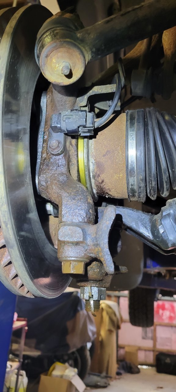

    Is there any evidence of water intrusion into the bearing?
    There are two seals on the outer end of the CV shaft..one is pressed onto the CV while the other is pressed into the knuckle. Together they make the seal. If you are missing one, you will ruin a new Bearing pretty quickly.
    See attached photo with both seals. @05Taco4x4 sells some great quality NSK bearings. Highly reccomend, just installed them in my truck today
    05Taco4x4 and TnShooter like this.
