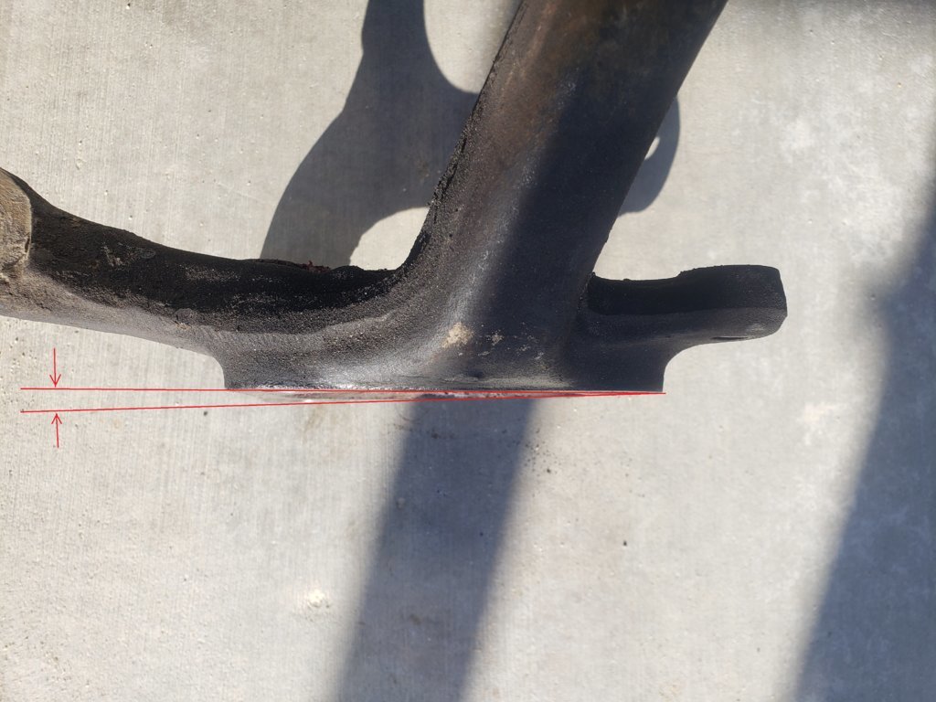

    @zippsub9: DING DING DING! You are correct.
    I couldn't see the bend until I removed the knuckle from the truck.
    I ordered a new knuckle and another hub assembly and finally got a chance to install them this past week. I can now confirm that the issue was a bent knuckle. If there is anybody reading this that is having repeated bearing-hub failures, I want you to know the following: A STRAIGHT EDGE WON'T NECESSARILY IDENTIFY A BENT KNUCKLE!
    I thought I had the knuckle ruled out after installing bearing #3, as I had taken a straight edge to the bearing mounting surface at that time. I placed the straight-edge across each of the 4 sides of the mount surface, and saw no gaps. HOWEVER, if I had used a 2-dimensional straight edge (an "X"), I would have seen it not sit flat on all 4 corners. It would have rocked a bit, indicating that the knuckle was twisted. Although the amount of twist was significant, looking at the picture, you can imagine how a 1-dimensional straight edge would not be able to show it.
    This was a very frustrating problem for me, and its finally solved! Goes to show that some of the most frustrating problems are sometimes caused by things you may have ruled out using insufficient testing procedures. Lesson learned, problem solved, happy ending. :yes::woot:

    Almost 2 months now since I replaced the bent knuckle, and wheel bearing shows no signs of any remaining problems. Still tight, quiet, and working as it is supposed to. So I am confirming again that replacing the knuckle fixed the issue, after putting a little time and miles on the new bearing.
    I will also add some more closure to this topic by addressing more of the symptoms I listed in my original post. I mentioned how tightening the 4 hub mount bolts felt like there was a spring washer even though there wasn't one. It should now be obvious why it felt that way. And after replacing the knuckle, that spring washer feel was no longer present when I installed the new hub assembly. So if the last few turns of the wrench feel like you are compressing a spring washer, you might have a bent steering knuckle. I also mentioned not being able to torque the stub-axle nut beyond about 50ft-lb before the bearing started seizing. With the new knuckle and hub assembly, I was able to torque it to 173ftlb, no problem.
