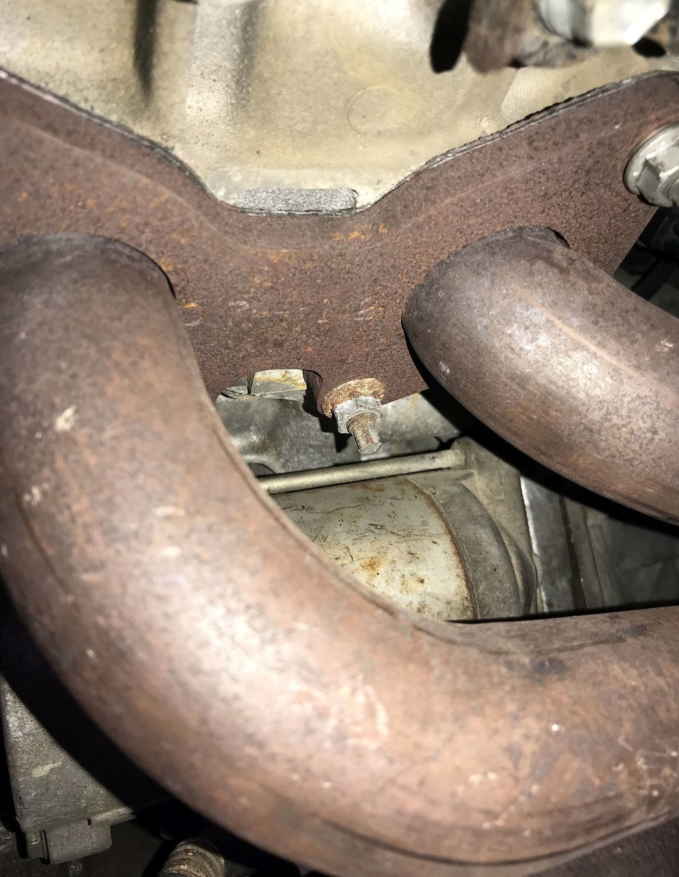

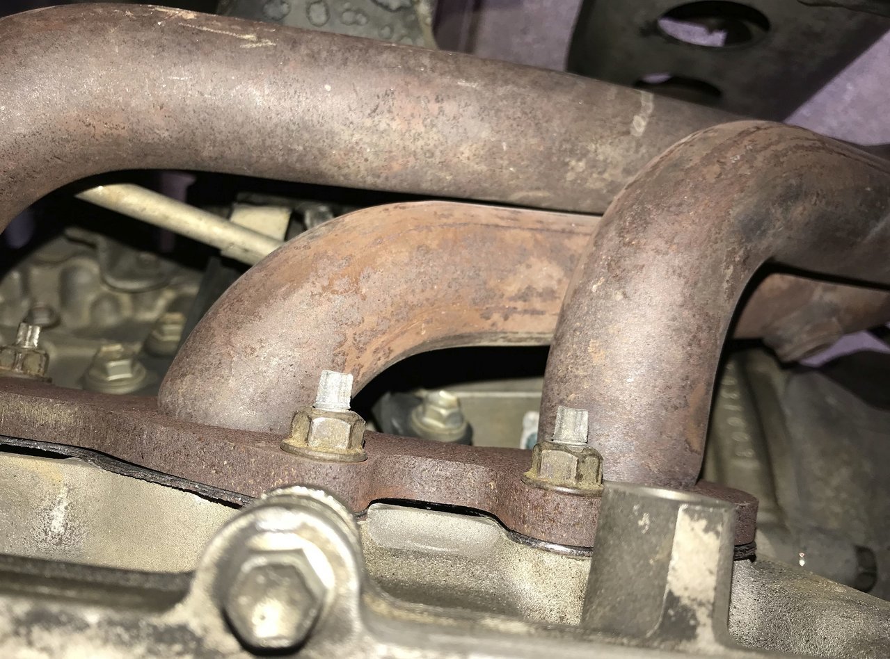

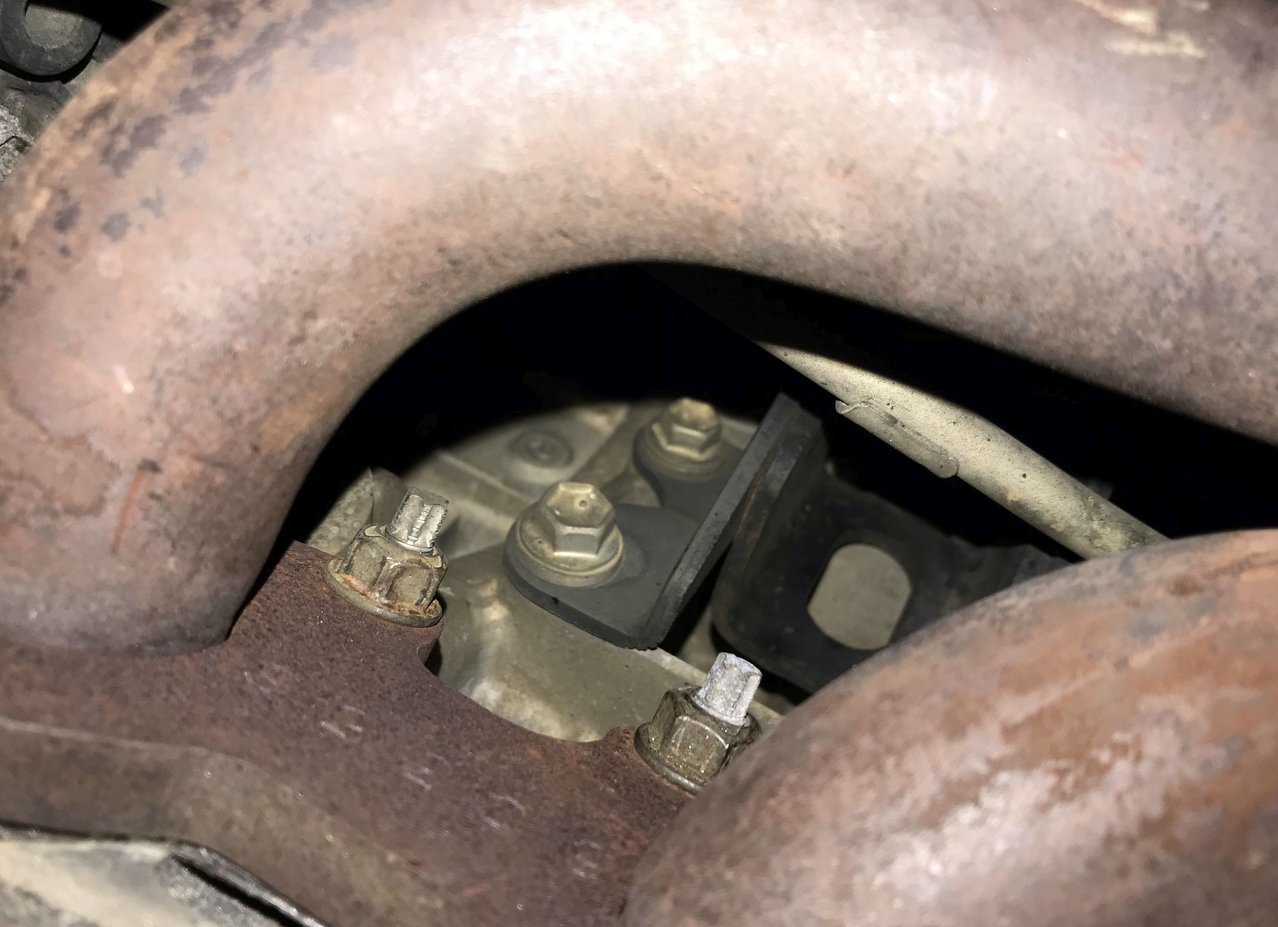

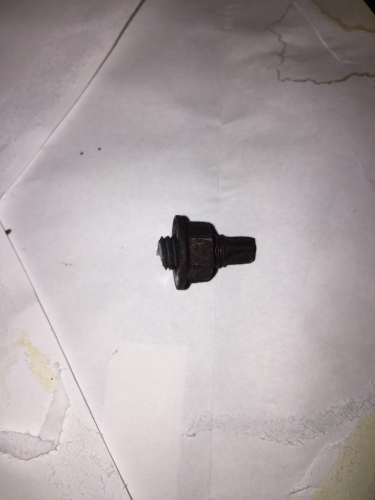

    Caveat: beyond knowing your fuel trims need to be within 1.0 or better of each other I cannot tell you why or even *what* a fuel trim is?
    My best theory is that since my JBA long tube headers were not easily attached to my Y Pipe they are “yearning to be free” and require lock washers on the header studs.
    Since posting above I had my engine replaced and sure enough, after driving seven hours at highway speeds I watched my fuel trims go from 1.0 apart to 20 apart.

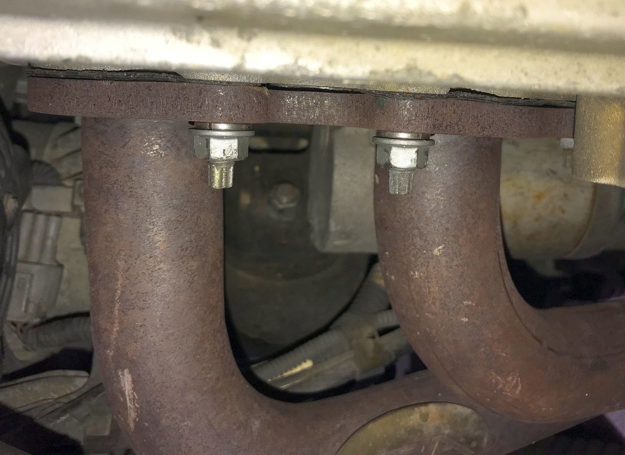

    That is when I noticed the mechanic failed to transfer my lock washers to the new manifold studs.
    I was planning a bigger write up and do not have pics yet. however I purchased the Dezod stainless ARP studs and after the eternity it took due to Dezods wedding planner for the studs arrived I began the installation.
    Let me point out the ARP exhaust manifold studs are far easier to install if you remove the headers.
    I did not chase all the threads with a tap and did not have any significant issue installing, however you are better advised if you do.
    I used anti seize on all the threads and faced the ARP washers bevel side out towards the nut.
    The best nut tightening was accomplished with a 1/4” 10mm deep multi point socket. I ended up taking the wheels off for a separate project which allowed me to access all the studs except the far front one on the drivers side.
    All was good until a month later when my wife reported the CEL was back on. So I checked the header nuts and not only was every single nut loose but several/most had some sort of tan “seepage” barely visible on the ARP stainless threads just outside the nut.
    I reset the CEL and went on a seven hour deer hunting road trip.
    I can watch my OBD II settings on my iPad with this dongle and dashcommand. Approximately six hours into the trip my previously close fuel trims changed and the right side went to 4.9 and stuck there.
    Sure enough, my cousin in Kansas had a 3/4” 10mm deep multi point socket and the ARP nuts I could reach were loose. After that, my fuel trims went back to close again.
    I have been on vacation from after hunting until now and thus have no pics or notes to add.
    I have ordered these The Hillman Group 3640 M10 Metric Spring Wave Washer, 25-Pack https://www.amazon.com/dp/B00I2VV4TU?ref=yo_pop_ma_swf and plan to install at first opportunity.
    I had the M8 version of the above and they almost fit. The M10’s look a little big but I plan to install regardless. Perhaps the M9’s are correct?
    Will post pics when I have them.

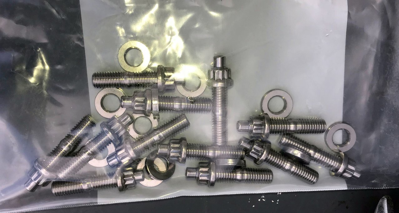

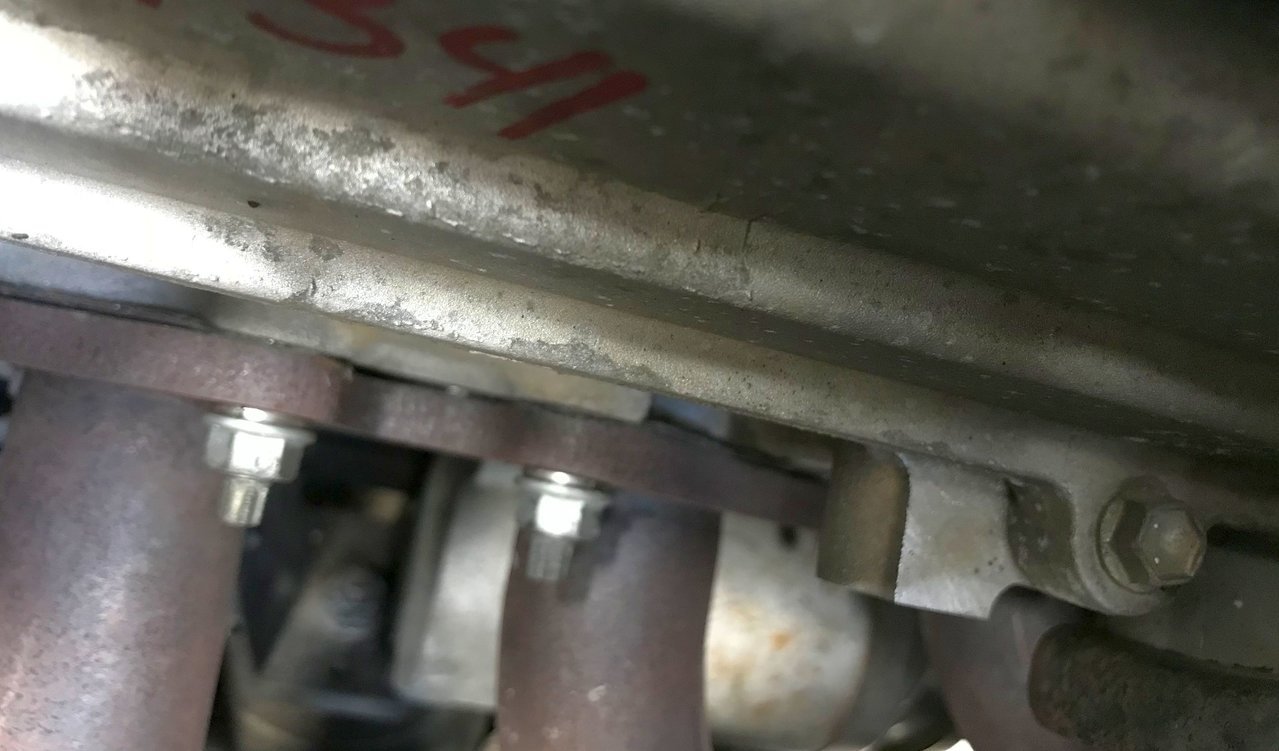

    The lock washers you see in the above pics resolved the issue on the original engine. Sure enough, when the shop replaced the engine this summer and did not transfer the home depot lock washers the CEL came back!
    I got the pretty ARP studs from Dezod - referenced on here, found via google. The home depot lock washers on new factory studs resolved the issue, however they are not nearly as pretty as the stainless.
    These sockets work to tighten the shiny stud nuts: https://www.amazon.com/gp/product/B01K4MIEUG/ref=oh_aui_detailpage_o03_s02?ie=UTF8&psc=1
    These female torx heads remove the factory studs: https://www.amazon.com/gp/product/B000I45Y8Q/ref=oh_aui_search_detailpage?ie=UTF8&psc=1
