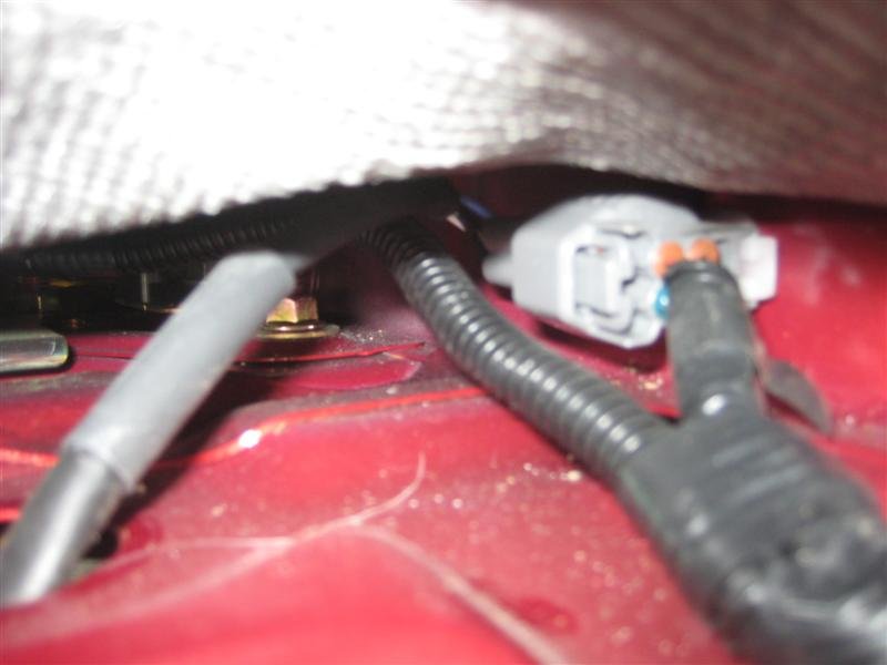

    I popped the grommet and found that there was no slack. I had to get under the carpet beneath the passenger seat to acces the plug - not much fun, but it is done. I had to go to the dealer to get the custom nuts that hold the sensor and its annoying mini heat shield in place - the oginal nuts were toast.
    I am attaching a couple of pictures - sorry for the blurry shot of the plug. the first photo shows the grommet from below and the second shows the wire coming up throught the floor and the plug under the carpet.

    Before too many others read this thread I have to admit to a mistake - I replaced the bank1 sensor2 sensor that reads an error message of P0141 - not the bank1 sensor1 sensor (P0135) that starts this thread. I had the P0141 message last fall, ordered the sensor, and cleared the error. When my check engine light came on last week, I assumed it was the same sensor even though it read as P0135 - bank1 sensor1.
    So, I will be ordering the other O2 sensor tonight and replacing it sometime next week. I'm not sure why I would have different codes from last fall and this spring...well, I will now have two new sensors.
