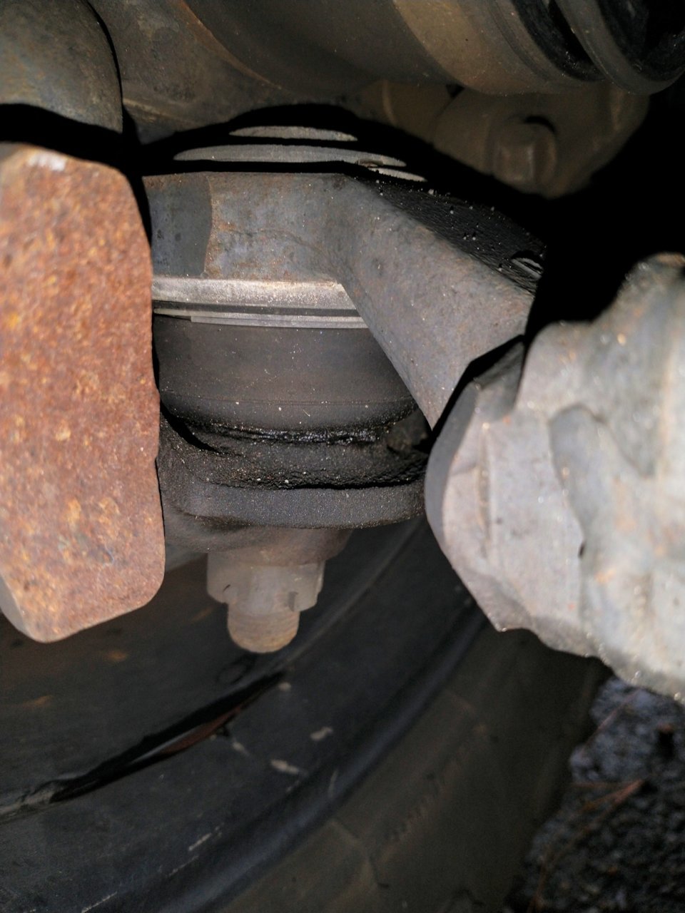

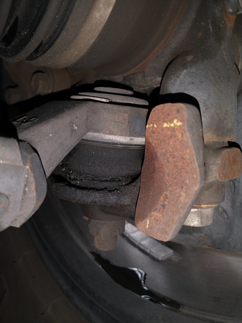

    I need new lower ball joints. I see the moog lca with ball joint at rock auto for a 4wd Tacoma is only $100/side. Seems easier to replace the arm and not just the joint for just slightly more cost.
    Am I correct in this thought process?
    Pics of leaky ball joints

    Well they are just leaking some grease it looks like. I don't think replacement is needed right away but it's coming.
