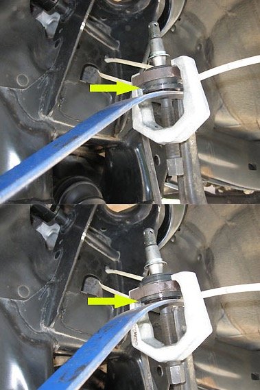

    I used this method, which outlines what you're talking about:
    http://www.bajataco.com/tech/control_arms_01.html
    While the method technically "works" (eventually) there are far better options, IMO.
    Starting with the removal using a 3-arm puller. You have to cut off the UBJ arm so now you're 100% committed before you even really start. Then I had to use a bunch of wire wrapped around the arms to keep them form popping off the control arm. And even then, the arms still popped off.
    Then installing the new BJ, it was extremely frustrating as the flat bar always wanted to push the BJ in crooked, and the tool had no real way to maintain a straight alignment. There's so much leverage on it that I couldn't even keep it straight using the prybar (it would just pop from one extreme to the other). I *eventually* got the BJ in, but it took several hours and LOTS of swearing.
    This method probably took 3 or 4 years off my life. The kicker is it wasn't even worn out: I was only replacing them since I was doing a bunch of other maintenance to the front end so I figured might as well do the uppers, too.
    Considering the fact you can go rent a proper balljoint press for FREE at most any auto parts store, just do that...
