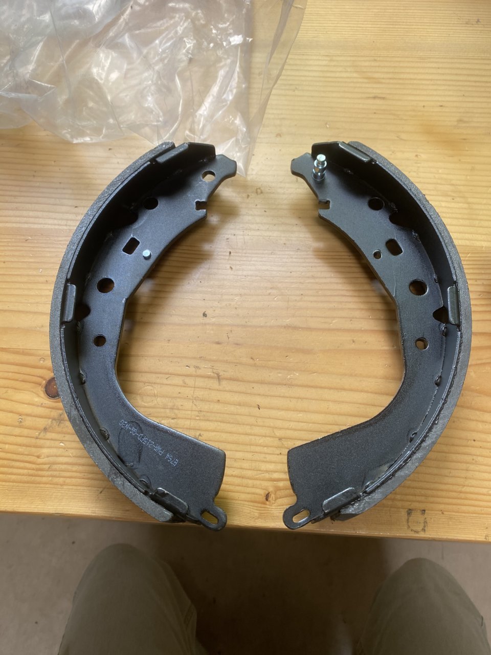

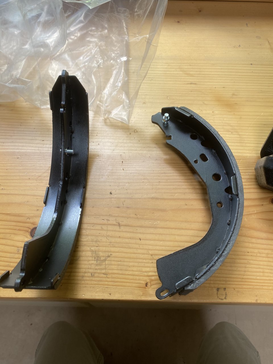

    Here’s the pads I got from RockAuto for an ‘03 4wd I think the brand is powerstop
    this is the passenger side. As you can see they have pins for both the e-brake arm and the self adjuster. The e-brake arm is pressed in and there’s definitely no easy way to remove it without damage. The self adjuster pin is pressed and peened over so there is no way to remove and swap that one either. My guess is you just got the wrong pads.

    Those shoes OP got are nowhere near correct even for the older style bottom mounting e-brake. In 2003 they changed to a top mounting (the e brake arm pins to the top of the leading shoe) and i don’t think that was a mid year change. It looks like they might be for a 2wd or 5 lug??
    Every google search I’ve done of ‘03 drums turns up the correct shoes that I sent a picture of as well.

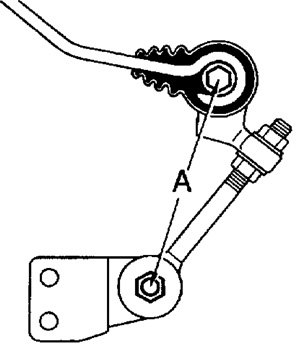

    Make sure you adjust the BPV linkage and make sure your BPV isn’t leaking, that’s a common problem.
    distance A should be 120mm
