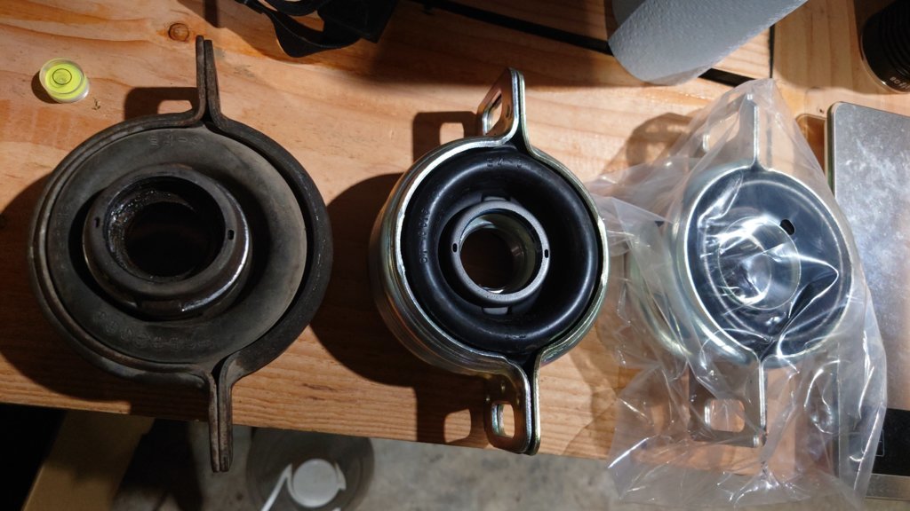

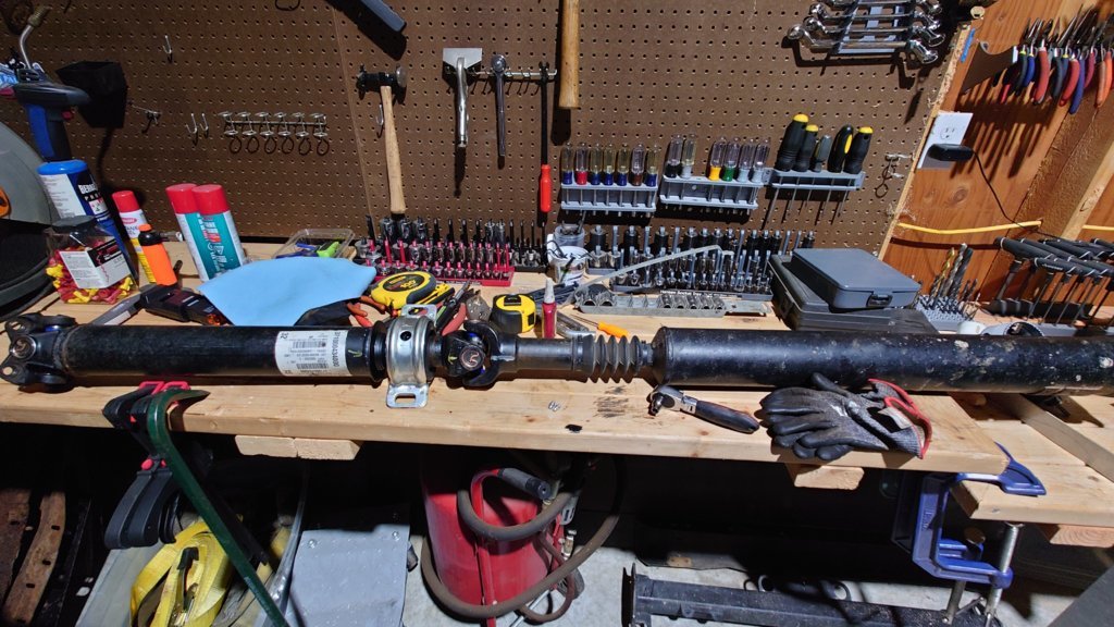

    I just replaced my carrier bearing and the ujoints after 105k miles of fairly rough life. Night and day difference- the existing bearing had noticeable slop. I got the Amazon 3- Spicer ujoint+bearing cheap kit, tossed the included bearing and bought a OEM carrier bearing. It took a couple days to do because I cleaned up the drive shaft pieces and rust binded/painted some of it. Used a bench vice and sockets to do the ujoints. Went well after I did the first one.
    Some of the youtube videos are very helpful. If you end up doing the bearing, make sure to mark with a paint pen or punch where the various ends meet each other and the tcase/diff so you keep everything in phase.
