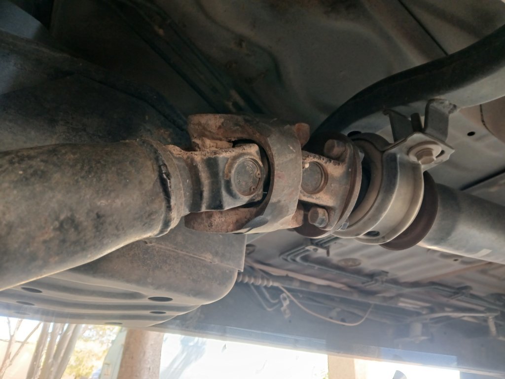

    20250614_102718.jpg 20250614_102718.jpg The title says it all. I've been vacillating on this for a while now. My driveshaft is a 2-piece unit that uses a double cardan. I have already greased everything since the picture was taken
    The u-joints seem to be fine for now, but in the future...

    The purpose of a CB is designed to absorb vibrations, not provide high clearance for offroad. Eliminating the CB will cause more felt vibration.

    I agree with the above posts. FWIW, Tom Woods no longer makes 1 piece rear Tacoma driveshafts since its not guaranteed to fix driveline vibrations

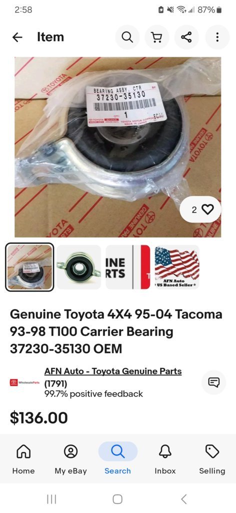

    Awesome, thank you for all of your replies! It looks like a new CB is the way to go. Does anyone have any recommendations? Supplier, part#, etc.

    RockAuto, Timken. If I remember correctly that is the OEM manufacturer

    Spicer is OEM actually.
    DANA two117501X from Rock Auto is what you'll want. (not that there is anything wrong with Timken, they make good bearings)
