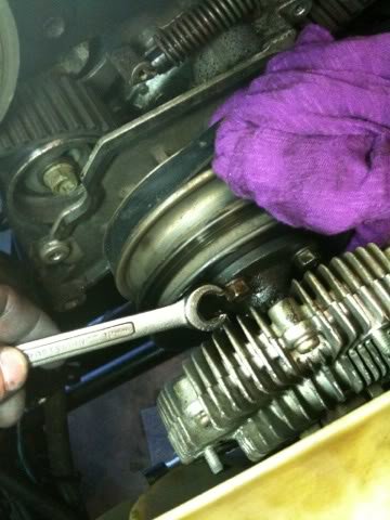

    Thanks guys.....I pulled out the remains of the fan and pulled the radiator...both will be easy installations...so no worries there.
    WHen the fan blew up the truck was still running and ran till I shut it off. I went to start it and all the power worked but it seem like it was not sending power to the starter. IE not turning over...
    Although I did notice some wires that were suspect although I have no idea what they are. I am attaching an Image.
    In the image IMAGINE YOURSELF standing inbetween the Fan and the RAdiator looing towards the passenger side of the truck
    A. This wire harness attaches to the black cyclinder thing at the base of the windshiled squirt resivour. What is this and could it stop the truck from starting?
    B. This is a pair of wires that does not seem to have a home...althogh missleadign I believe they are both green wires...what are these for, where do they go and could they stop the truck from starting?
    Any help woudl be apprecaited...I do not look foward to taking this in to have someone track down this issue....
    Its seems obvious to me that the shrapnel from the fan hit soemthing...this is really all I could find....one was not seated properly (A) and (B) was just hanging there....
    Hope someone can help
    CLICK IMAGE TO MAKE LARGER

    A. Is the windsheild washer pump motor. Just plug it back in.
    B. Looks pretty important. It looks like the plug was damaged. Check around the distributor and the ignition coil. It was to hook somewhere.

    The battery is brand new...2 days old when this happened...fan blew the truck still ran untill I shut it off...then the truck would not start...so I dont think it was a result of a dead battery...but one of those wires...I could car less abotu the windshidl washer motor/pump etc...I need to truck to move....I will look aroudn some more for a connection to that plug....
    Yes it was dingged a bit (the plug that is), but I think still usable...a little of the plastic was chipped off.... if the clip wont hold it I assume that I can buy another and cut the wires, solder them? Or would I need to go and find another whoel cable with the connection? I guess I can try adn trace back to where the cable is coming from....it looks like it loops up behind the battery...
    As for plugging the other wire in (B) ....Thats if I can find out where the dam thing goes...I looked for a few minutes and could not find anythin within its reach...the cable is only a 5-6 inches long so the number of places it can clip into is quite limited...will have to look closer...
    Really appreciate your help here.....will look for a connection when I get home tonight...

    For some reason the truck started to turn over????? I have no idea how...I did nothing...the only thing I did was connect the battery charger to the battery (which was fully charged)...
    Although noticed one of the Power steering hoses was split from the fan breaking up...so off to the parts store
    BUT those wires I discribed a few entries ago are still not plugged in....and cant find any location to plug into...
    Anyone have any thoughts or have something close to a 92 Pickup to maybe check if they can see where its plugging in to? The wire I am talking about is in the image a few entries before this...LABELED "B"
    Thanks for all your help....

    I don't know Jay. There aren't too many 3.0's on this board. I can't find any pictures either, at least with substance.
