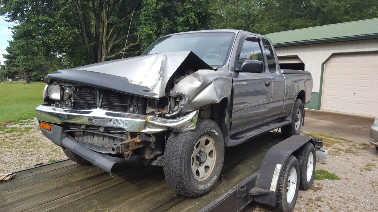

    I was able to buff mine out...:)
    Like said above, they do tend to be stuck depending on where the truck has lived. I have removed them from 3 rusty 1st gens, and they do tend to have rusted bolts and be slightly stuck to the frame. The good thing is since you are replacing it you can get as rough with it as necessary.
    On my other truck (never wrecked) I did have minor alignment issues to get the new one on, but I figure it was just not completely straight since it was not OEM. Only used a 2 x 4 to pry a bit and it looked perfect after install.
