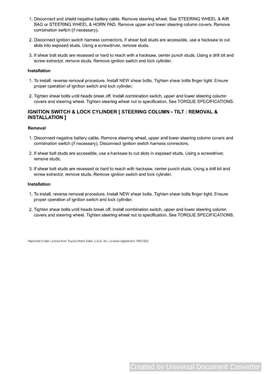

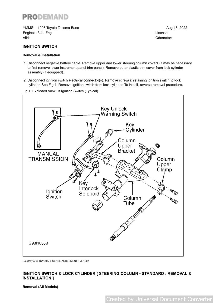

    any info or links available for changing ignition SWITCH (not lock cyl) in a 1996 taco

    That's about all that service info gives as well although it does have an exploded view that may be helpful.
    It looks like it's just 2 screws to change the switch but idk how difficult it is to get to.
