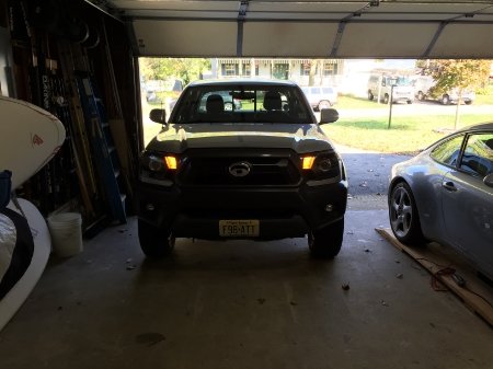

    adding my experience to this thread...
    i purchased a popular exterior LED kit for all the lamps on my truck. i was happy with them all except for the DTRL. the LEDs filled the bowl with amber but that was about it. they were about half the brightness of our stock incandescent DTRL / flashers. The resistors were also super hot all of the time, which bugged me a little.
    I ordered the "Amber / Amber V3 Triton" kit. i called them to verify the right socket adapter and it needs to the "CK" one. The guys were super knowledgeable of their product, it gave me a good feeling.
    the kit is really well put together. the control box is sealed up nice. all the connections are weather resistant and feel like good quality.
    One of the things i learned speaking with them was that unlike running regular LEDs where the resistors are on 100% of time, with these kits the resistors are only 'on' when the signal function is active. which means the control unit isnt baking and there's no super hot resistors on all the time under your hood.
    if you want to run your own resistors you can do that too, but it makes sense to use the ones built into the control unit. another nice option, is you can tie the control box into the low beam w a dedicated plug and the LEDs will dim when headlamps are on, just like stock function.
    Most importantly, with these rated at 430 Lumen, they are definitely as bright if not brighter than the stock DTRL. im super happy with them. they work fantastic, feel like great quality, hopefully the control units will last.
    its not a cheap kit, but given the alternatives... to me, it was well worth it.
    Photo with the regular LEDs that i wasnt too happy with...
    V3's on passenger side installed
    Both V3s installed
