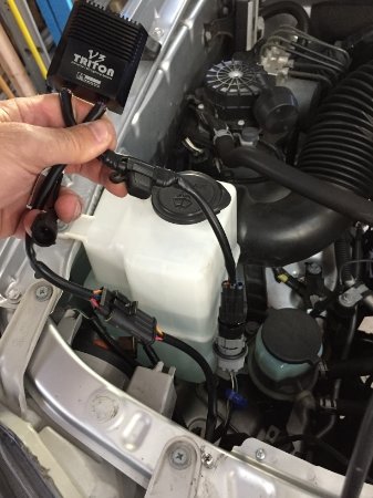

    Question for you guys who are running VLED Tritons in your DTRL, specifically the 2nd generation ones (larger control boxes with built in resistors) like photographed....
    this is just for discussions sake.
    when i installed the Triton kit into my Tundra, i noticed that while i ran this set up in my tacoma i was not using the built in resistors as the inline fuse was empty. when i installed into the tundra i had to install the 5 amp inline fuse to activate the built in resistor.
    i figured the DTRL wiring of both the tacoma and the tundra would have been identical. if you guys are running fuses in your 2nd gen control boxes try it without the fuses you may be able to get away with not running the resistors up front. as mine worked fine without this fuse.
