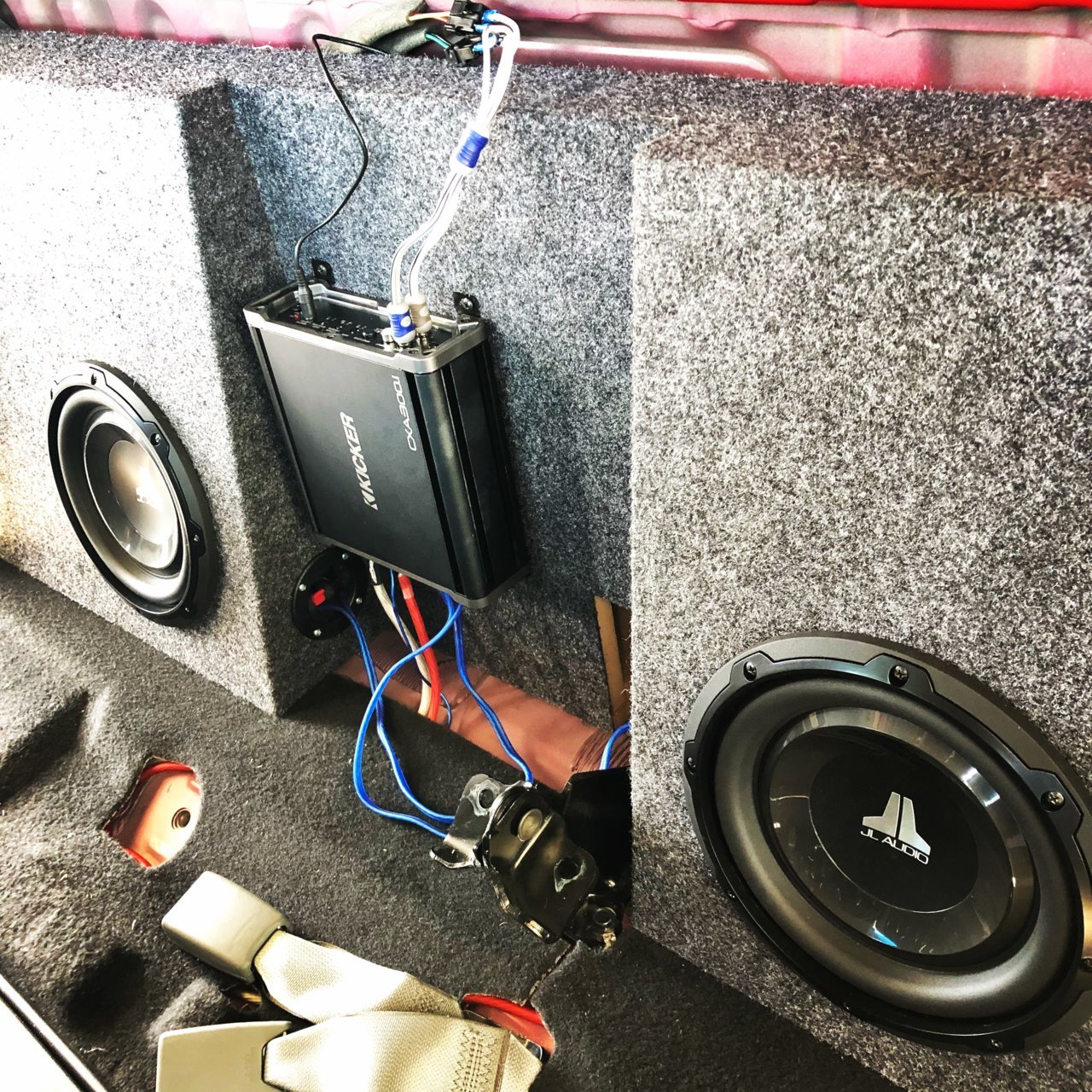

  16. Oct 16, 2018 at 4:50 PM
    #16
    fivefoot
    fivefoot Scarlett, Scarlett Tacoma is the name!
    Dec 1, 2016
    #203768
    221
    Temo
    Texas Panhandle
    2012 Tacoma TRD Offroad Barcelona Red
    I have a 2012 with JBL, I replaced all four door speakers and the crappy subwoofer. I am using Infinity speakers for the doors. 2.7 ohms each. I am using JL Audio 8” woofers, 300W total with a Kicker amp. This setup sounds super nice. Doesn’t wake up the neighborhood, but inside the cab sounds amazing!

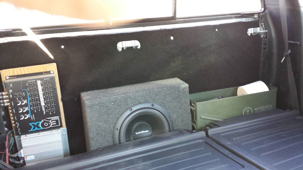

  19. Feb 5, 2019 at 6:04 AM
    #19
    John C
    John C Well-Known Member
    Aug 31, 2016
    #196076
    56
    John
    2016 TRD off road
    2 10” Rockford fosgate subs with a 500 watt Rockford fosgate amp. Works great had it in for about a year or two. Use them everyday, never had a problem.
    House Forsaken likes this.
  20. Feb 5, 2019 at 6:53 AM
    #20
    fivefoot
    Dec 1, 2016
    #203768
    221
    Temo
    Texas Panhandle
    These boxes are heavy! lol That's one think I don't like about them.
