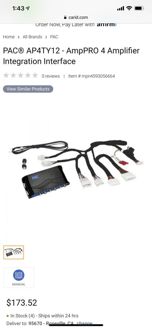

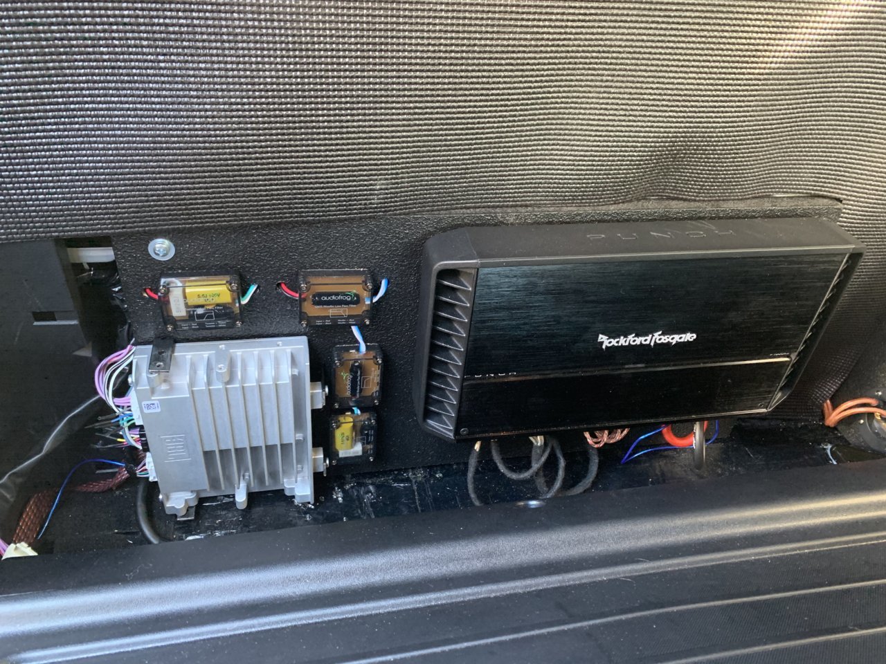

    As far as I know with the Maestro, you have to buy the data link along with having to piece meal together the rest of what the JBL amp integrates including back up camera, rear lights, navigation, steering wheel controls etc. to retain the head unit, the easiest route for us folks with jbl is to use amp pro and keep the jbl amp in place for everything else except audio. If you are changing your head unit, then Maestro is what you need. Some people hide the jbl amp in the cubby under the rear seat, I just integrated it into my amp rack.
    There is lots of good help on here on how to do this. If you have any questions hit me up. This install does take a fair amount of planning and education to understand what is going on with the FUBAR jbl system, so I would start with the wiring diagram to help understand things, then look at what Amp pro vs Maestro will offer you.5AA86CF8-CCA1-472C-AF2C-FBBE43595424.jpgB8942F3E-0432-43C4-BF74-CB2CFF0E3179.jpg
    and yes the ap4-ty-12 will work with 2018 Tacoma with jbl even though it is not on the list of compatible vehicles.

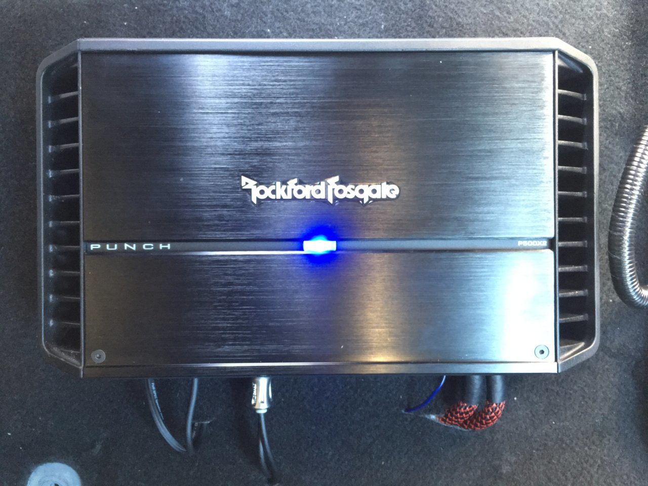

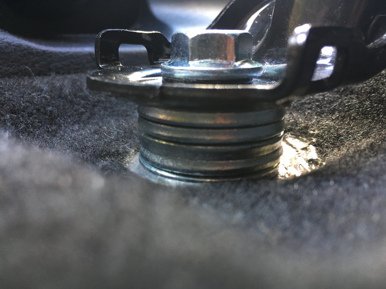

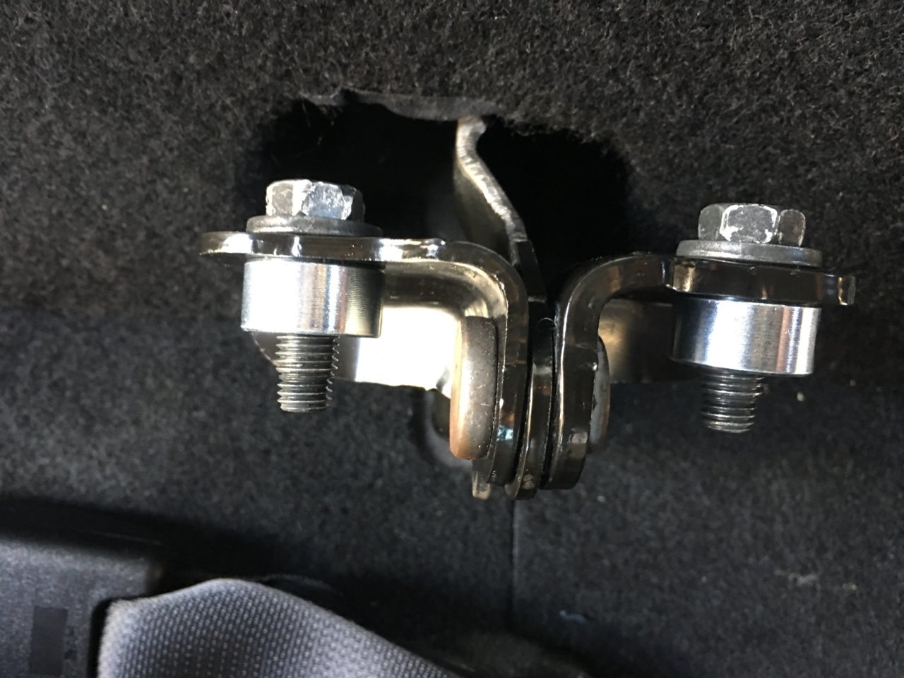

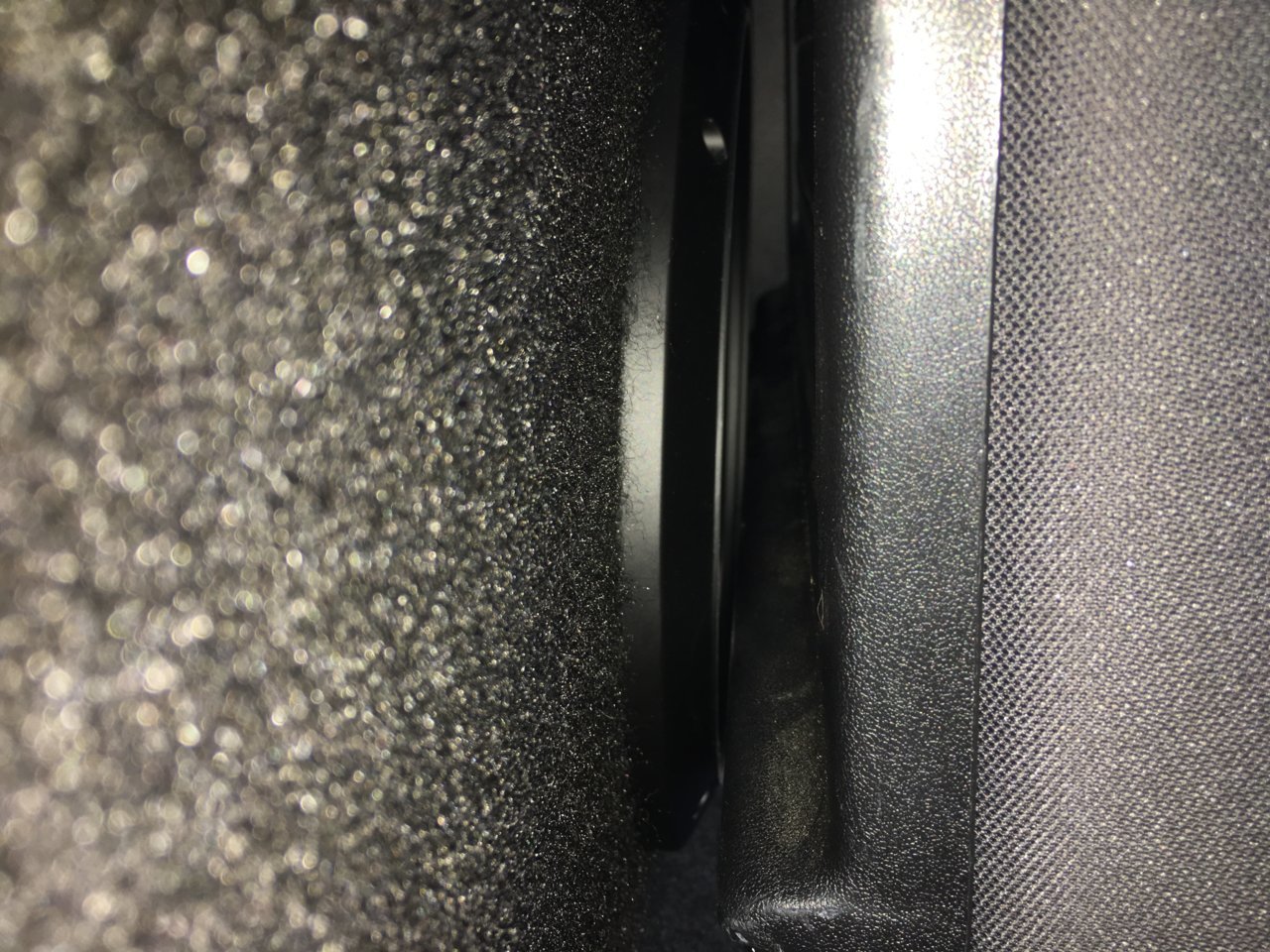

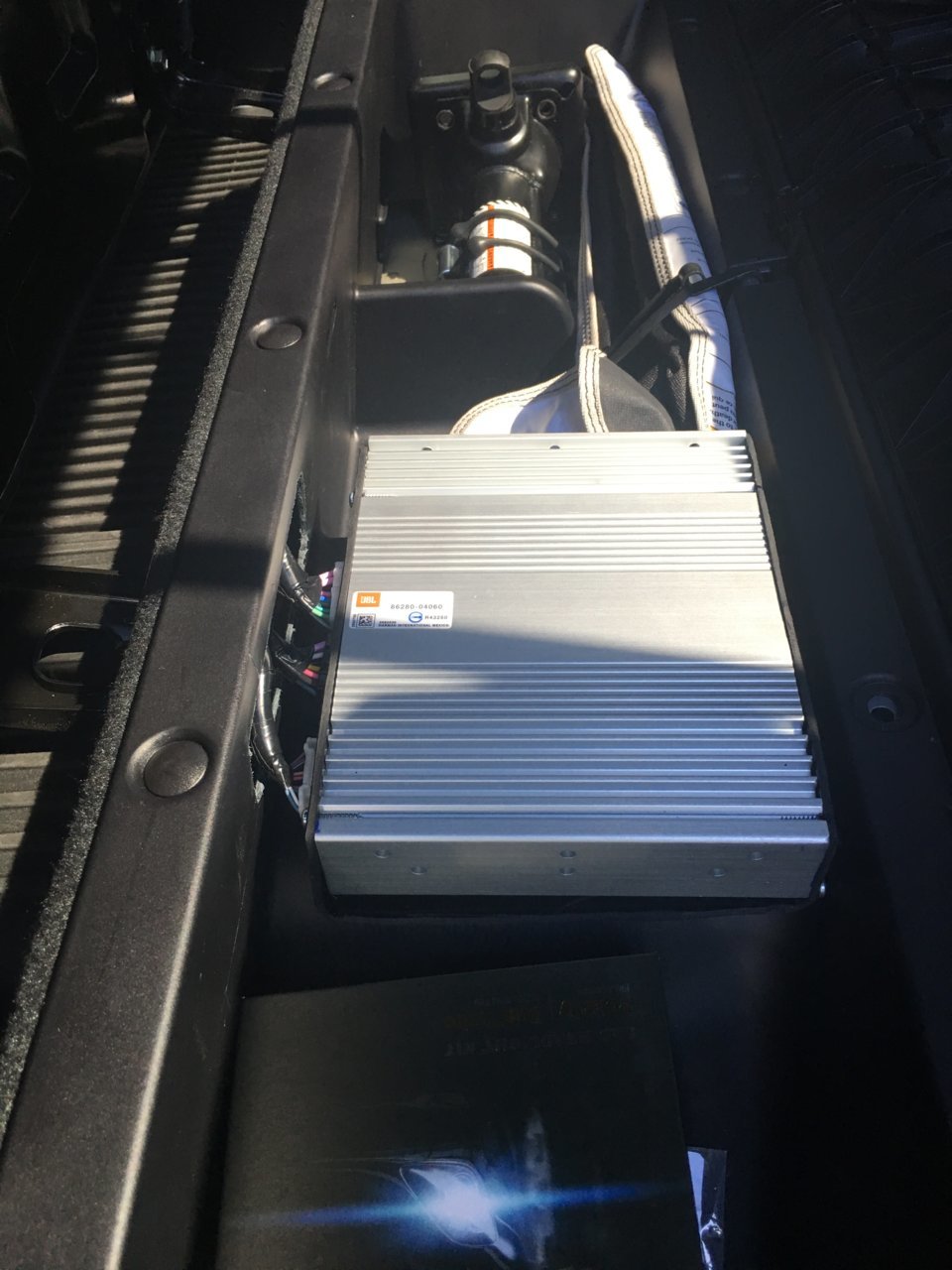

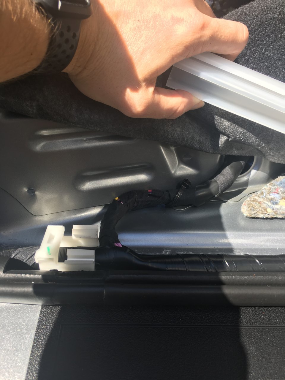

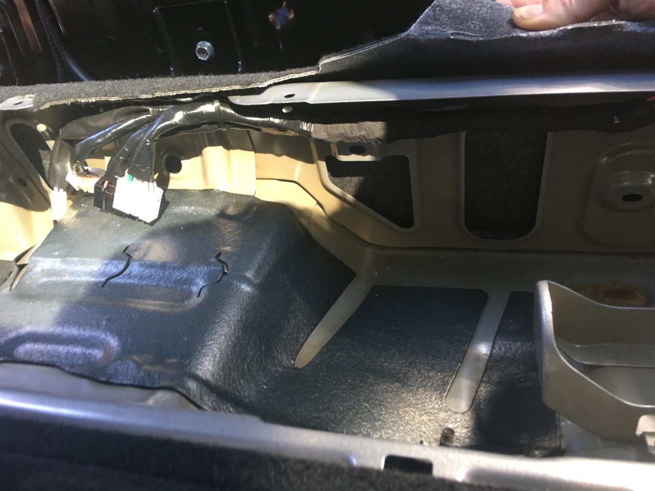

    You won't regret those amps. A little pricey but absolutely worth it. I threw mine under the driver's seat with spacers and I'm about to do the same on the passenger side.
    Heres an idea for mounting the stock amp in the underseat cubby. I just had to extend 2 wires that I assume go to the 3rd brake light

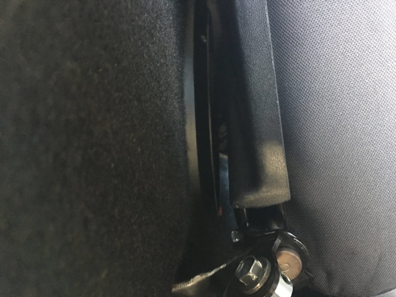

    And if you're going with two 12s, I'd definitely throw some 3/8" spacers behind the back seat bolts to push the bottom away from the subs. Heres an idea of how much those spacers give you some peace of mind
