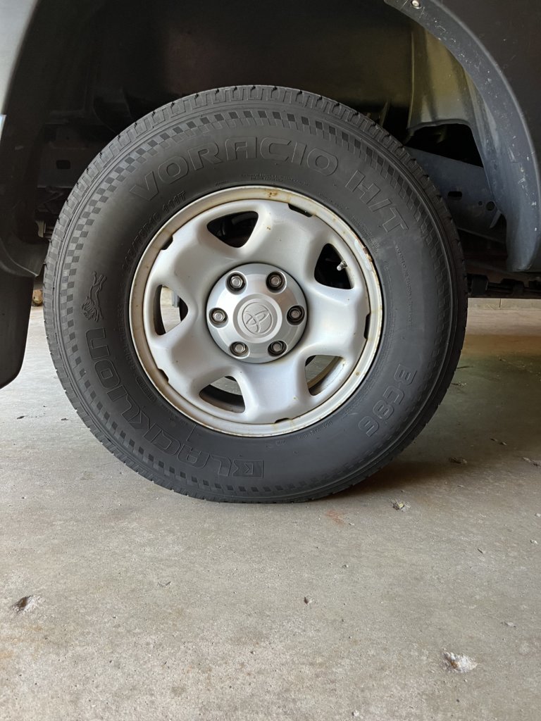

    I have a 2014 base model 4x4 4cyl manual with the "economy" looking six-bolt wheels. They work just fine but they've got some rust, and I've long thought about either replacing them or painting them. Two questions:
    1) What are some OEM Toyota wheels that are the same size? I don't want to get aftermarket wheels.
    2) Has anyone had good luck painting these wheels? Will the same paint work on the plastic hub caps in the center?
    Thanks!

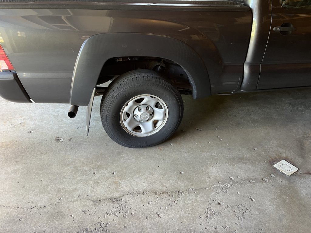

    My wheels need refreshing and I'm thinking of doing them with Plasti Dip Spray. They have minor rust areas but are in good otherwise as they had chrome wheel-skins over them for many years. They looked very nice, but the metallic finish got tired and was starting to flake off.

    Thanks for the advice, particularly about the tire pressure monitors -- the reason I'd wanted to stick with OEM wheels was because I figured the monitors would be guaranteed to work, so this is very good to know. Really tips the scales in favor of painting or just living with cheap looking steel wheels, haha.

    They don't really look too bad at all. I think if you scoured off the little bit of rust with a green Scotchbrite, washed and degreased them really well (Dawn dish soap works wonders) to get them clean-clean-clean, and hit them with a couple layers of clear coat, they would look really nice and not look like they're trying to be something they're not.
