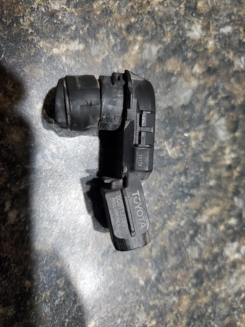

    I bought a 2017 Tacoma which had a broken parking sensor. Looks like it was broken on the neck under a rubber boot.
    P/N 0CO11/48930 new P/N 893410R060
    Autoparts stores wanted $150 and dealer $200. Well, found someone posted about using the same part labeled as rav4.
    Bought this on Amazon for less than $20 and it works perfectly. https://www.amazon.com/gp/product/B01MUVKVMY/ref=ppx_yo_dt_b_asin_title_o05_s00?
    No issues and was the exact same housing and wire connector.
    No idea how parts stores can charge so much when there are cheaper versions.
