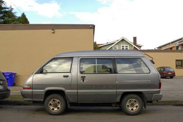

    Pics of your Space Van?
  18. Oct 24, 2013 at 8:01 PM
    #38
    Jimmyh
    Jimmyh Well-Known Member
    May 16, 2012
    #78991
    14,316
    SC
    2012 Prerunner SR5
    It is long gone but this is what it looked like:
    The engine is under the front seats.

    Hard to tell which is the front and which is the back....lol

    It was a great van, we bought it when my wife was pregnant. Great for trips. We disposed of it at 200K miles and it was still like new.
