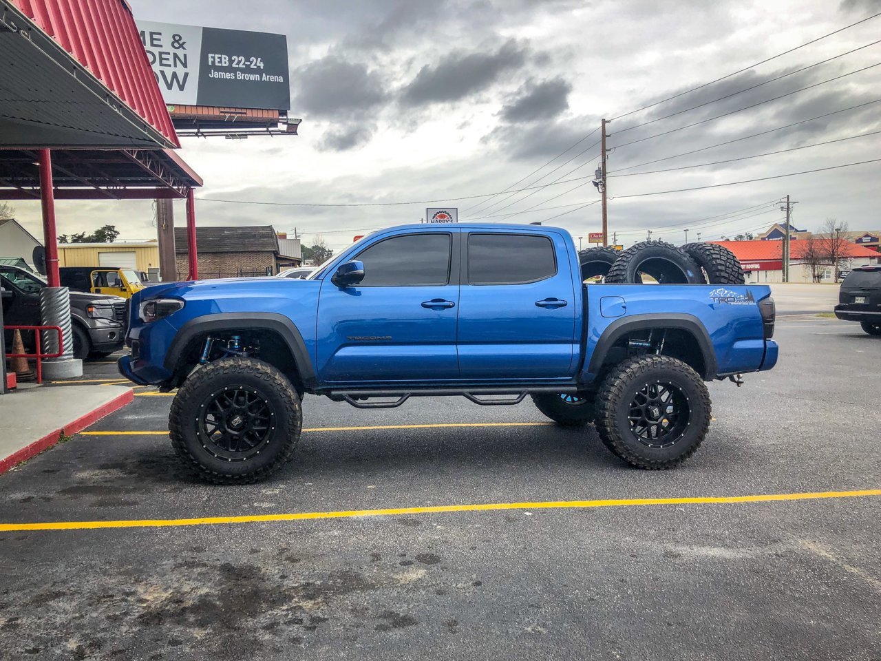

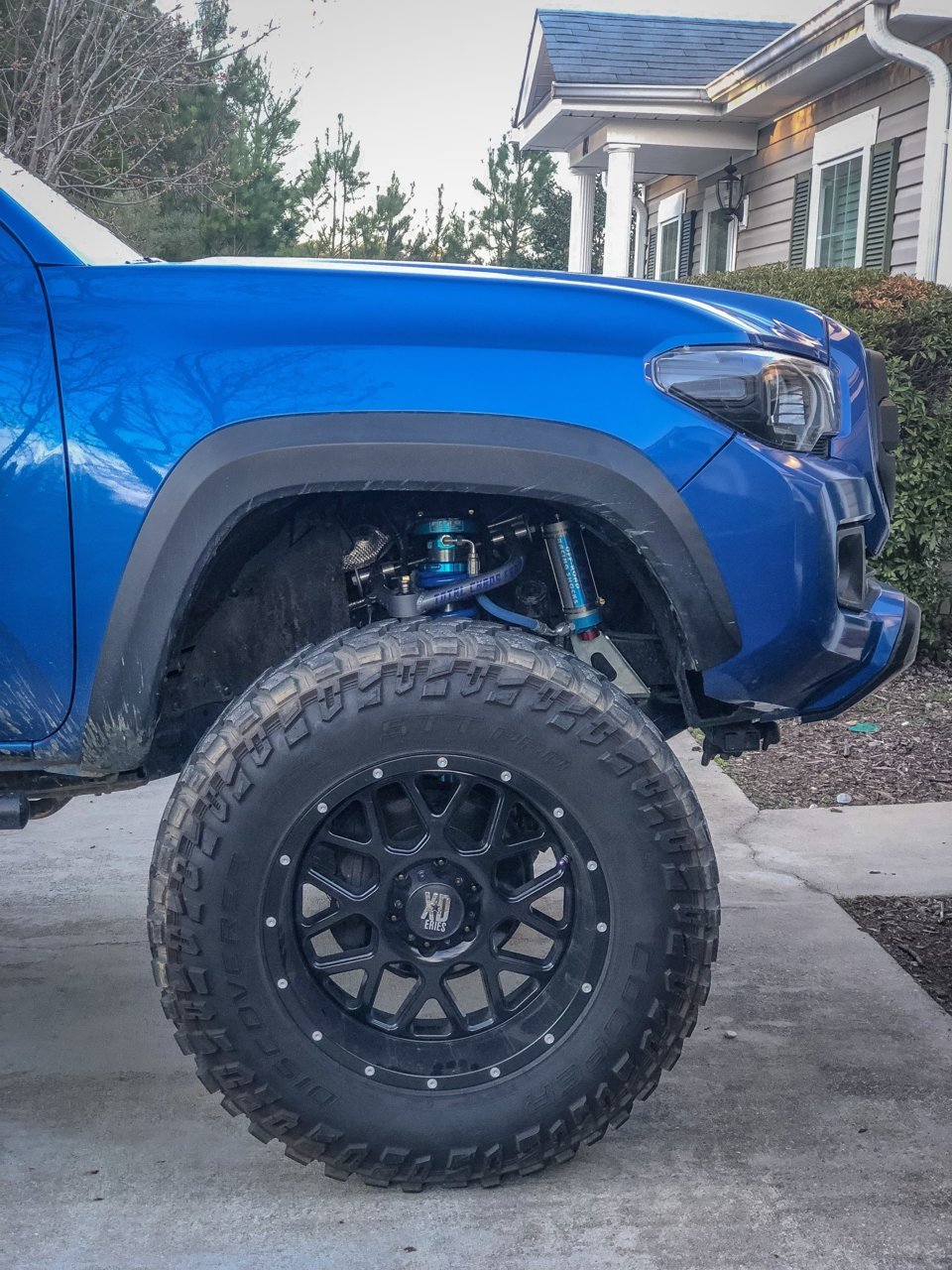

    322
    Hey guys quick update! I ended up going with full length 2.5 adjustable king coilovers in the front and king shocks in the rear. A new leaf pack is next F6BCF997-108A-4D0F-AF8A-DA1EC55DB124.jpgEF0B18A9-E086-456A-8828-9E4A2F407976.jpg
