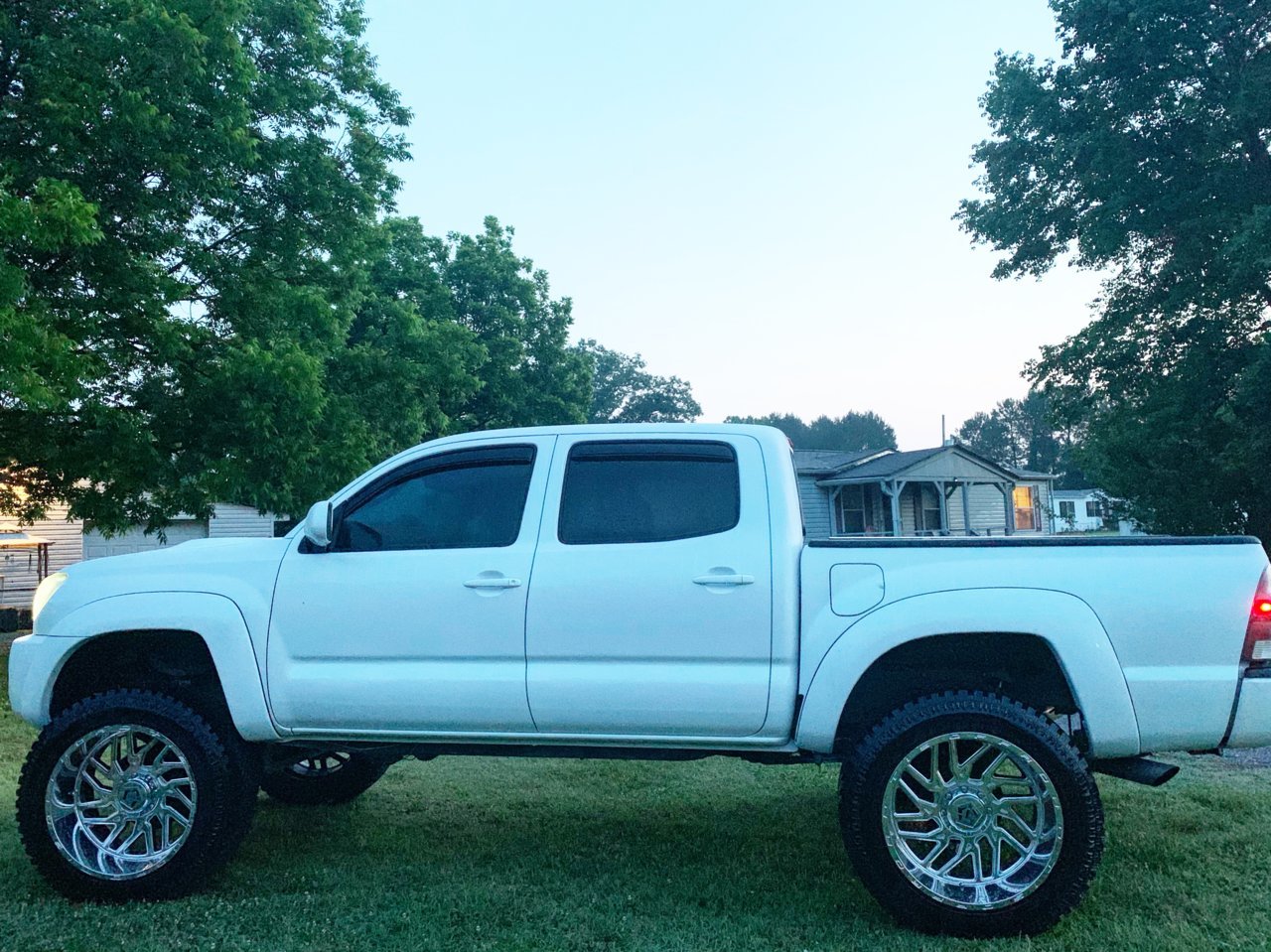

    so ive had my truck for a while now (bought when I was 19) and I cheaped out and bought a rough country. This lift hasn’t given any problems but I wanted to upgrade from a spacer to a full coilover. The only ones I can find are either only compatible with other lifts or are only sold in complete kits, thanks in advance

    I’m currently on the stock front shocks with the spacers that came with the lift bolted on top. I want to do away with that and replace them with a single coilover to eliminate the spacer
