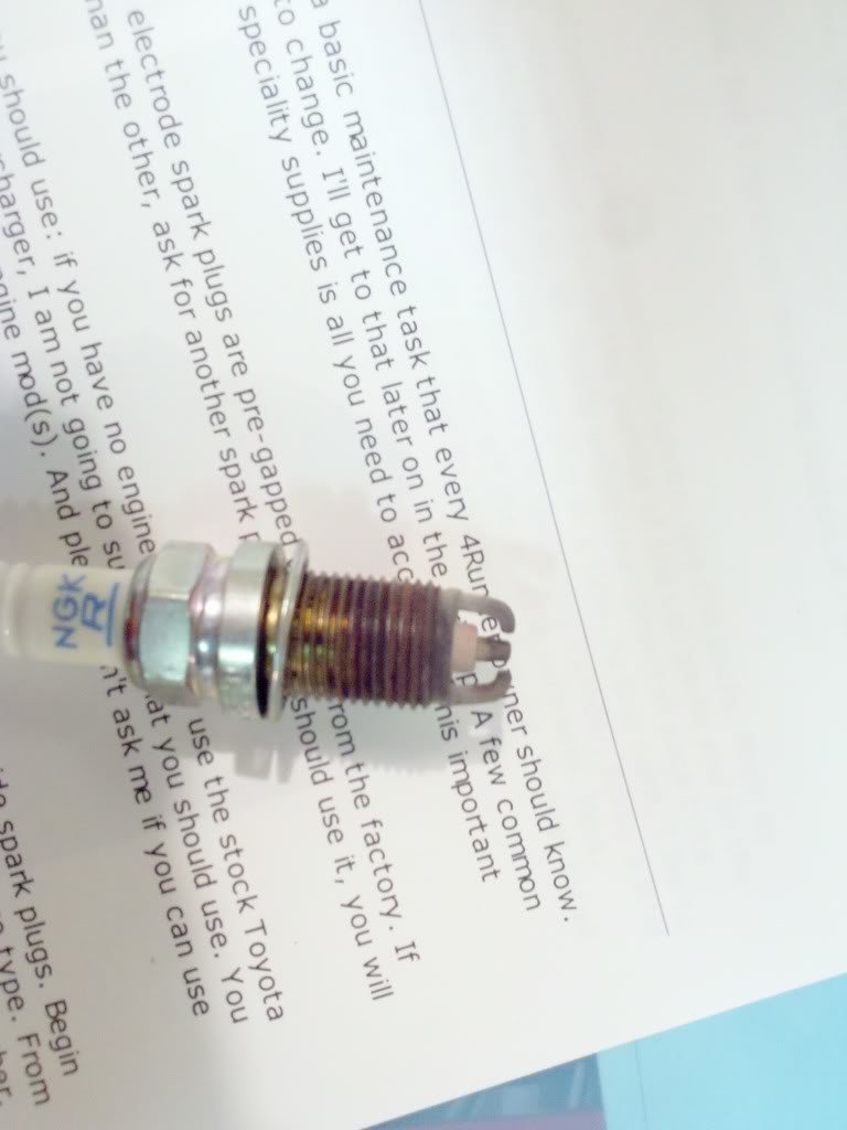

    My truck has 75,000 miles on it. I went to replace the plugs yesterday because I figure its probably past due. I went to pull the first plug and it looked really good/clean. What do you all think? Should I go ahead and change them, or just leave them?

    I'm in the same boat as you, 70K+ miles and my plugs look good, but should I just replace/upgrade anyways. Looking forward to seeing what comes of this thread. I was thinking plugs and wires. Congrats on only 75K on an 03, sadly my 07 has already reaches this point as well. The fiancées new car get great gas mileage so I'm hopping my pickup can be just an around town truck from here on out.

    I can tell you that i bought my 98 tacoma in August 09 and i replaced the stock plugs and wires at 169k!!! It ran better after i replaced them, but the plugs looked about like the one you show above, I obviously wouldnt have gone this long without changing them, nor would i recomend it but the fact that the truck still ran good was a statement in of itself, as for your plugs they still look good to me, but it never hurts to change them

    From the factory, I do know that the tacomas came with different spark plugs on each side of the block so that explains the different spark plugs you found. I have owned the truck for about a year, but did talk to the previous owner who owned it since new and he had never changed the plugs before.

    Definitely a good way to look at it, thats my theory on oil changes, spend a little to get a lot.... not that letting your plugs go will exactly ruin anything. And good call on the factory using 2 different kinds of plugs, i didnt think of that, i just figured someone was getting lazy. I tell you though, those plugs look super clean compared to what came out of mine at 58 k, not clean in an oil fouled sense but mine were very worn.

    Considering I only pulled one plug to inspect, and it was the NGK, makes me wonder what the Densos on driver side look like.
    I think I'll go ahead and pull them and replace them this weekend just to be done with it.
