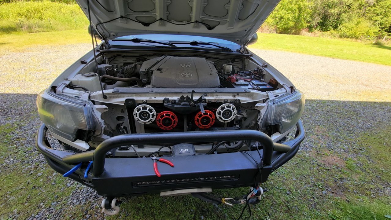

    Thanks for the replies and concerns about honking my horn, I live in the mountains and sometimes when passing or trying to let someone know your position it's nice to have a horn that can be heard. My BMW has a great "Euro" sound that is very audible, my two Cadillacs also have superb horns, however as you other owners know the Tacoma horn sounds more like it belongs on a small sedan from Yugoslavia :) So, if anyone can recommend horns great, otherwise i'll just try some out and see what works. If I get a tone that's Tacoma worthy I'll try to post the info. I like Wyckedan's pic, how well do those 4 disc horns work?

    Those are monstrously loud. You can hear them from the next county
