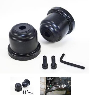

    Unfortunately I do not. The front superbumps use allen screws and a free nut, so theoretically you could us whatever hardware you wanted.

    Oh dang. I didn't know that..i guess that seals the deal. Wow
    That will make it more than just screwing on and screwing off the bump stop, hmm
    Edit, why isn't there a nut in the photo?

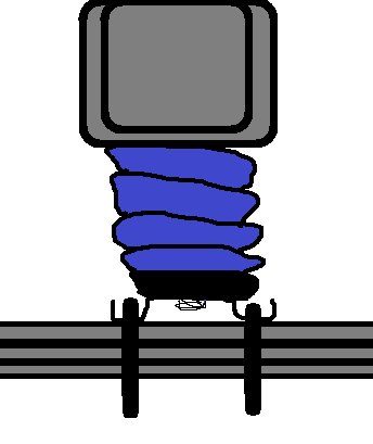

    Have you thought of doing something like this? I'm not sure if the 2nd gen and 3rd gen leafs are the same size, but you may be able to use the factory U-bolt. [​IMG]

    How will this help me? I don't see how I can attach a Sumo Spring to that

    I thought you were trying to get a super bump in the rear SUMO location? I linked a rear super bump kit.
