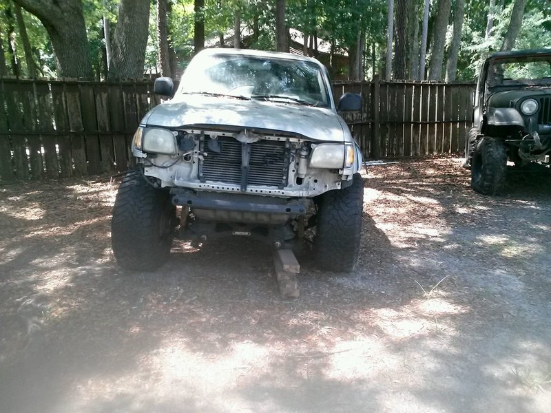

    About the location, I have a good driveway to do the job. I just try to get it done to look like the way it was as from the manufacture only, nothing fancy, just a regular one.
    There are many damaged parts, but I believe I can get those done easily. The only things I really need to know are the Front Suspension and the bed. I say the suspension. I'm not sure which part but the wheels are turning in different direction. I tried to post the pix here for you to see but I could not. Can you tell me how to post it?

    Sounds like you are good with a wrench but Ill ask anyway. :) Is there any damage to the frame? Are any of the damaged suspension components heavily bent (specifically the upper or lower control arms)? Look for tweaked or cracked suspension mounts or the area around the mounts. Even the slightest bend in parts like the control arms are a red flag that the frame could be bent. If it is, it could spell large headaches later during alignment and what not.

    Looks like the lower ball joints are the first thing that need attention.
