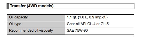

    My honest guess is that a straight 75W is harder to find, so more people are likely to purchase the overpriced fluid from Toyota. I would not hesitate to put 75w-90 in the transfer case on a 3rd gen. I'd venture to guess that is the go-to for most DIYers on here. Toyota is very slow to change things, which is what makes them so reliable.

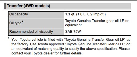

    Toyota engineers specified this particular lubricant, that happens to ship from Japan, I trust that if a more off the shelf product would achieve the engineering goals they would have used it.
    The idea that a special lubricant is specified so that Toyota can make a huge profit selling said lubricant doesn't seem very likely to me.
    1) Outside of enthusiasts (like TW members) probably the majority of transfer cases won't ever get serviced unless there is a problem.
    2) There have been many instances here that Toyota dealerships put the incorrect lubricant in the transfer cases, thus missing the opportunity to make this huge profit.
    If Toyota truly wanted to make more money on parts and service they could increase the price on every set of brake pads by just $1 rather than shipping cans of specialty oil from Japan.

    You missed the part about that being a guess. Unless you are one of the engineers or in management at Toyota, you cannot claim to know better. You can just have a better guess.
    For the most part, I trust Toyota engineers too. In fact, most of the non-toyota parts that I have put on to replace worn out OEM stuff hasn't lasted near as long. When it is feasible, I'm forking out the extra money for the OEM stuff. That being said, Toyota has HUGE markup on their parts and oil. Maybe they found that 75W is better long term than 75w-90 (though they are both 75 weight). I don't know. I stand by my statement that I would not hesitate to use 75w-90. Especially if you are changing it at the recommended service intervals.

    I made no claim of knowing better and I have no need to guess, the knowledge of a team of engineers was included when purchasing the truck, they provided their recommendations in a nice book.

    Yes. I risk repeating myself, but I experienced shift problems when using synthetic 75/90 in the T-Case in cold weather. Went back to the Toyota LF and no issues ever again.

    One Toyota can will do it. I used the Redline stuff, and a quart was enough.

    Thanks all for the info, Im going to buy the Ravenol 75W for $20.

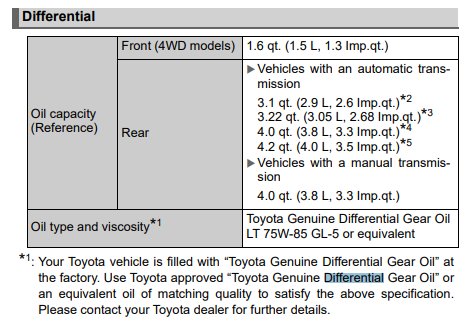

    I've never used this site before, but for $9.99 and free shipping, I'd order 6 qts and have it on hand for the diffs too. Or at least 2 quarts so that you have enough for this time and the next if you only want to use it in the xfer case.
    https://motomummy.com/products/vp-racing-g-500-gear-oil-75w-1-liter.html?sku=431022
    And yes, I realize the diffs utilize 75w-85 in the 3rd gen.
    Again, I don't think there is enough of a difference to matter.
