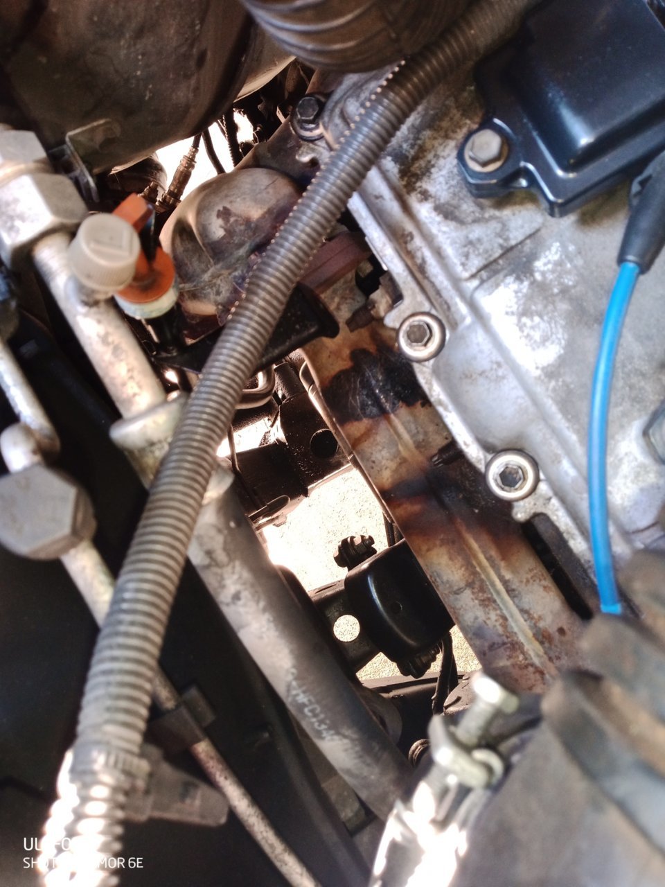

    Tacomaislife
    Tacomaislife Well-Known Member
    Jan 24, 2018
    #242231
    545
    Texas
    2002 tacoma trd
    Is this a leaky valve cover gasket?
    GQ7227 likes this.
  3. Jan 8, 2020 at 12:47 PM
    #23
    Timmah!
    Timmah! Well-Known Member
    Feb 25, 2016
    #179385
    1,224
    TIM
    Yes, it is.
    GQ7227 likes this.
  4. Jan 8, 2020 at 12:56 PM
    #24
    Tacomaislife
    Jan 24, 2018
    #242231
    545
    Texas
    2002 tacoma trd
    I was wondering if it's okay to be riding around with it like that till Monday . Going to get it fixed Monday
    GQ7227 likes this.
  5. Jan 8, 2020 at 12:59 PM
    #25
    Timmah!
    Feb 25, 2016
    #179385
    1,224
    TIM
    Yeah, it's totally fine. Nothing about an oil like this is going to make anything explode. You will just smell some burning oil because it's dripping onto the exhaust manifold.
    GQ7227 likes this.
  6. Jan 8, 2020 at 1:04 PM
    #26
    Tacomaislife
    Jan 24, 2018
    #242231
    545
    Texas
    2002 tacoma trd
    Okay thanks and yeah smells like burning oil and there's white smoke I guess the owner before me never changed it
    GQ7227 likes this.
