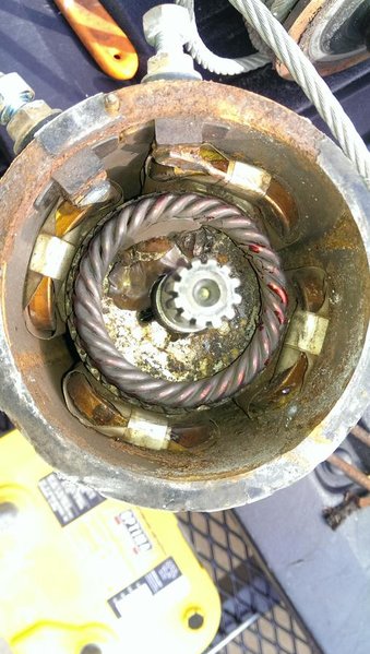

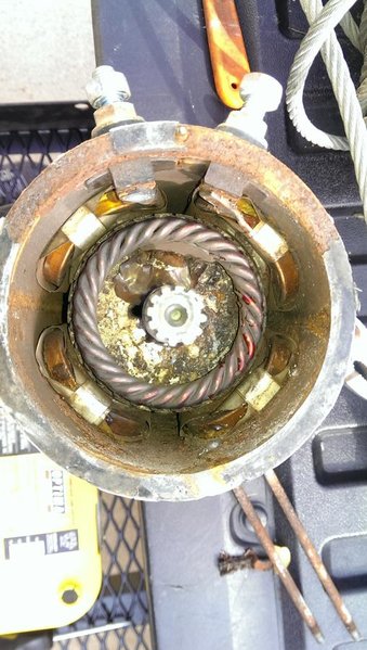

    Bought a use Warn 9500ti for cheap and decided to disassemble it so I can put it in the parts cleaner to get the old crud out and put in fresh grease. Was surprised at how bad the inside of the motor was. Was wondering if it is ok to leave like this or since its all apart should I replace the motor before I cram it behind the bumper. Also are there any options on having the motor cleaned and rebuilt.

    Went ahead and ordered a new one. Dont want the motor to be the weak link when I need to get out of a jam.
