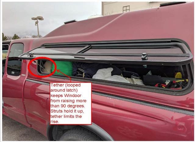

    Love my windoors and the convenience. Never any leaks, mine from Leer. After a rain or carwash the windoors retain some water which will drip, briefly, if and only if the windoor is raised above 90 degrees.
    DIY solution:
