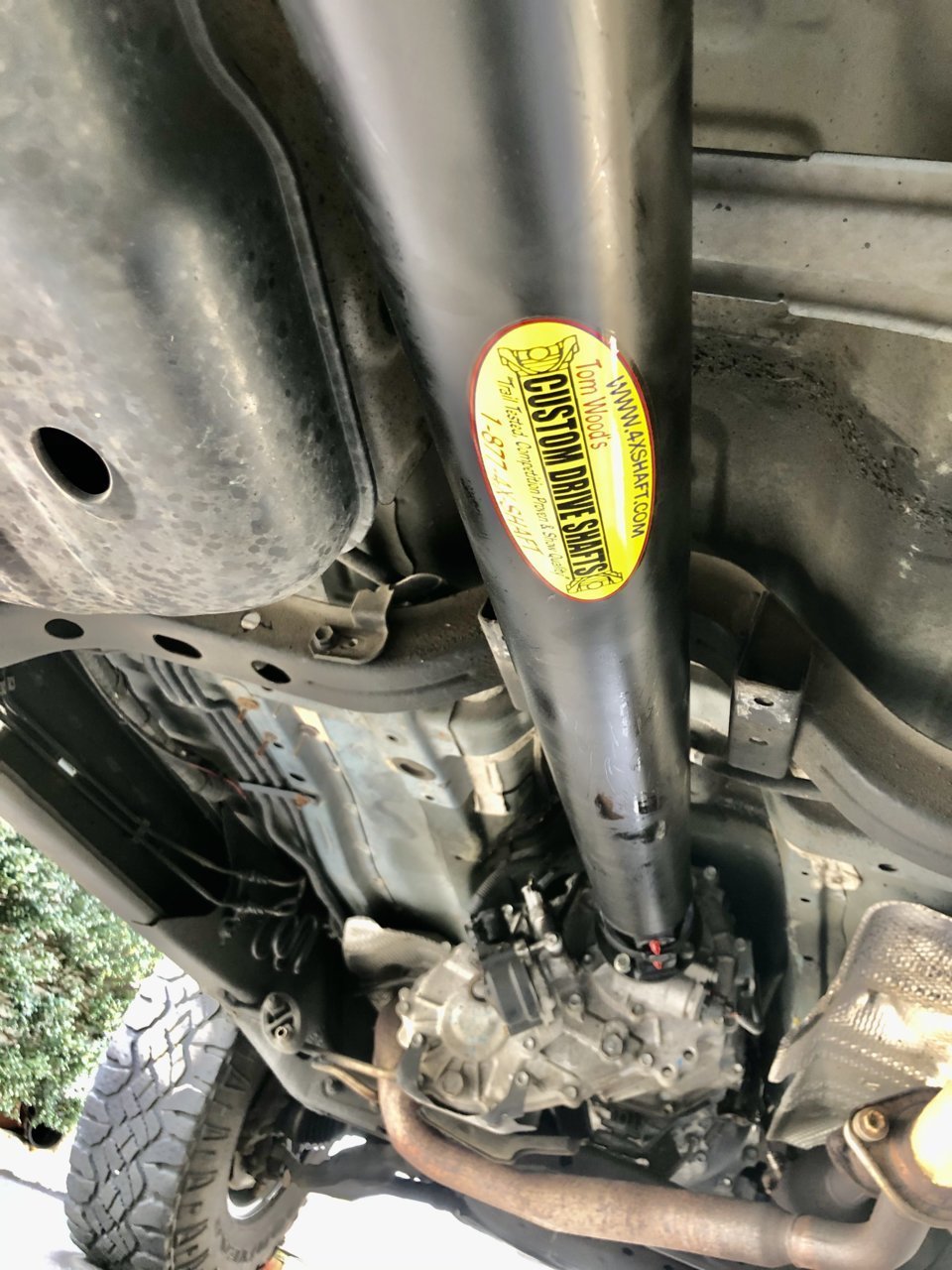

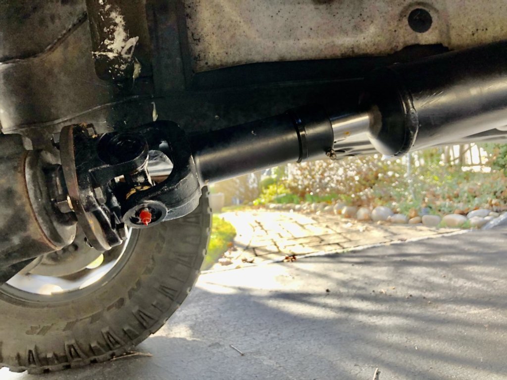

    Lifted, Kings, Locked, 295s and more.
    Wow, you could have bought a Tom Woods one piece for that.
    G8R_Taco, Toki and whatstcp like this.

    You spent $1,000 on a 2 piece driveshaft???? Custom built all aluminum 4" one piece only cost me $900.
