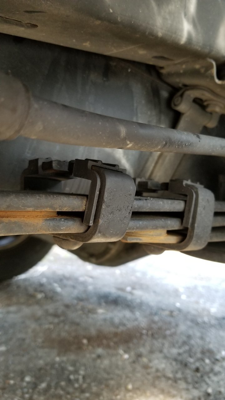

    And just for the record my leaf springs are flat also.the holders for the leaf springs all have air at the top of them.never in my life thru driving tons of trucks and owning 5 have i ever experienced this bs in driveline nor having to throw parts at something time and time again to just turn around and the same problem exist.

    Look at the air in those leaf spring holders!!!

    And look at the angle of that assend.refuckintarded.

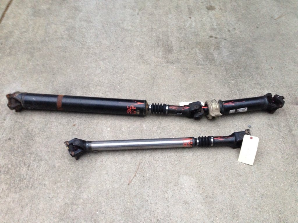

    2 things to realize after buy a taco. Replace the factory leaf springs and driveshaft and all is good. I put OME dakars on a 1 piece driveshaft I cobbled together from a 4runner. My truck never has had driveline vibes since then.

    The fellow that rebuilt my driveshafts balanced them, but even afterwards the 2 piece driveshaft sucked ass. 4runner double cardan shaft is what will cure your problems.

    A straight shaft isn’t available for the 2wd as it’s too long. Again it shouldn’t have to be replaced either.
