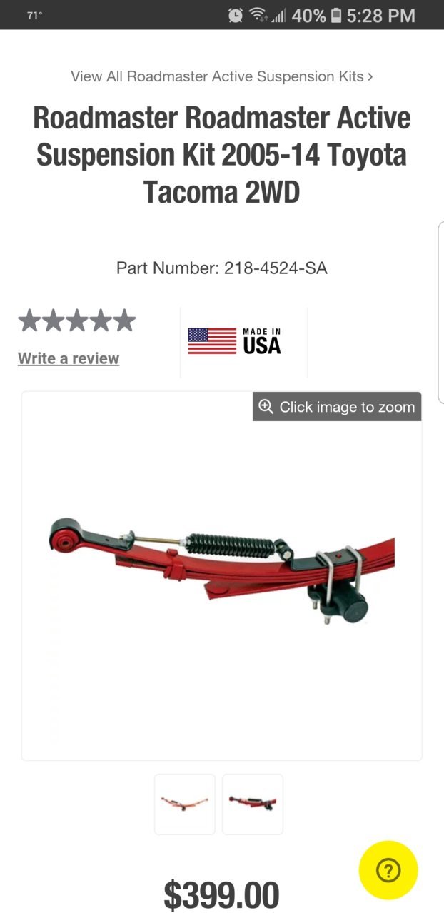

    So these are the one you have? U got a 2x4 or 4x4?

    This one?? Do u have 2x4 or 4x4

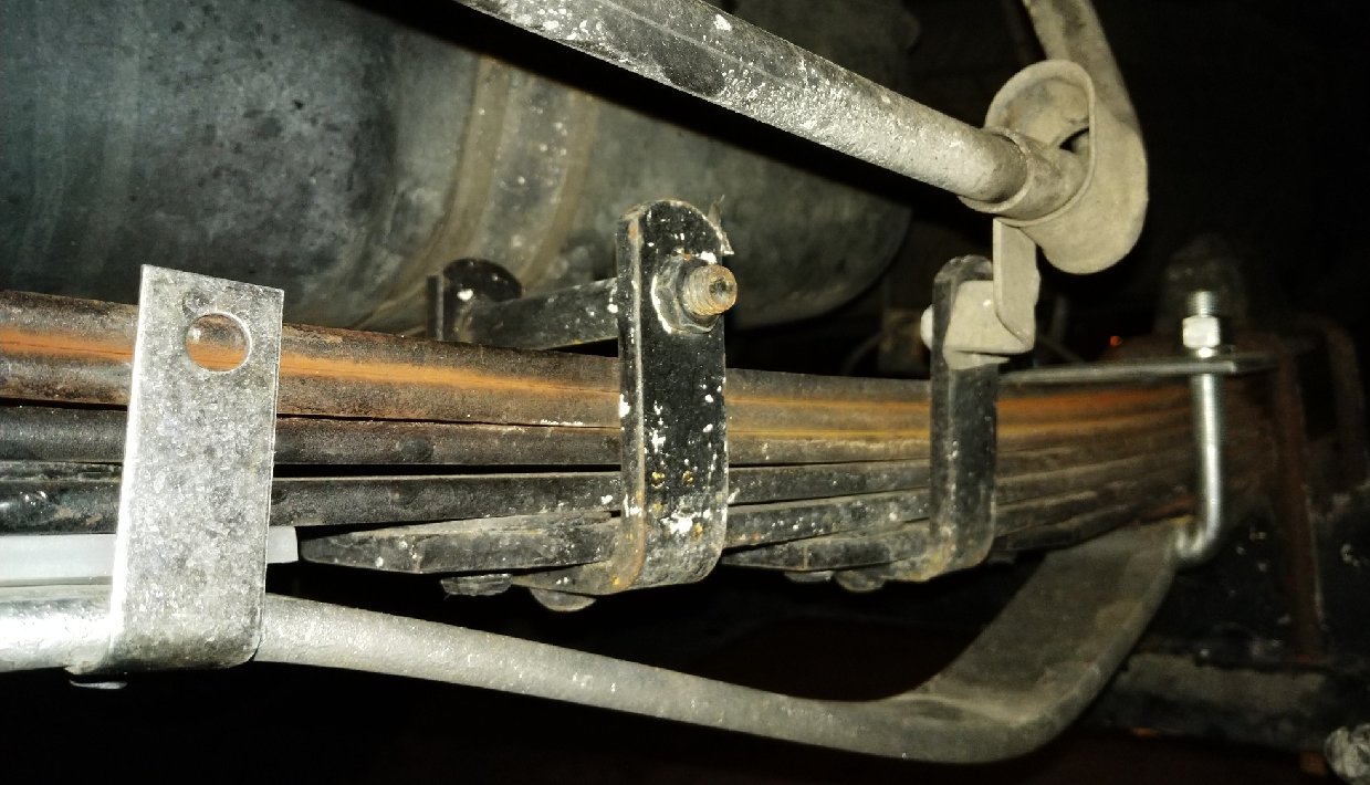

    Save your $$$. If you want go this route to deal with axle wrap from weak leafs, for $40 at Advance Auto you can get an Under spring over load bolt on kit. It will just about kill axle wrap.
    I think i got a set in the shop, gimme a few I can put them on to show you what I'm talking about.
    Or, put the $400 you would spend on Roadmaster towards custom made to fit Alcan's or some Allpro's etc...
    BTW, did you ever actually run some cams under the truck to see what's going on?

    Here you go, no going take back off
    2x4 tacoma[OP] likes this.

    Ya i was thinking something like that.just something to stop the bend and my pinion angle going up on take off

    Driveshaft i bought cured a vib from 30 to 40 on exell and decel...the problem now is def these shitty aprings bend and making my pinion angle rediculously high on load which inturn is vibrating the rear u joint.

    This most likley what i will do.i tow a jonboat 2 times a week so it auta cover that and DD.
    Thank you sir.

    And that roadmaster springs and the kit they have on them in the front looks like its trying to mimic what you showed me q this kit from the parts store. Ill try the $40 thing first.
