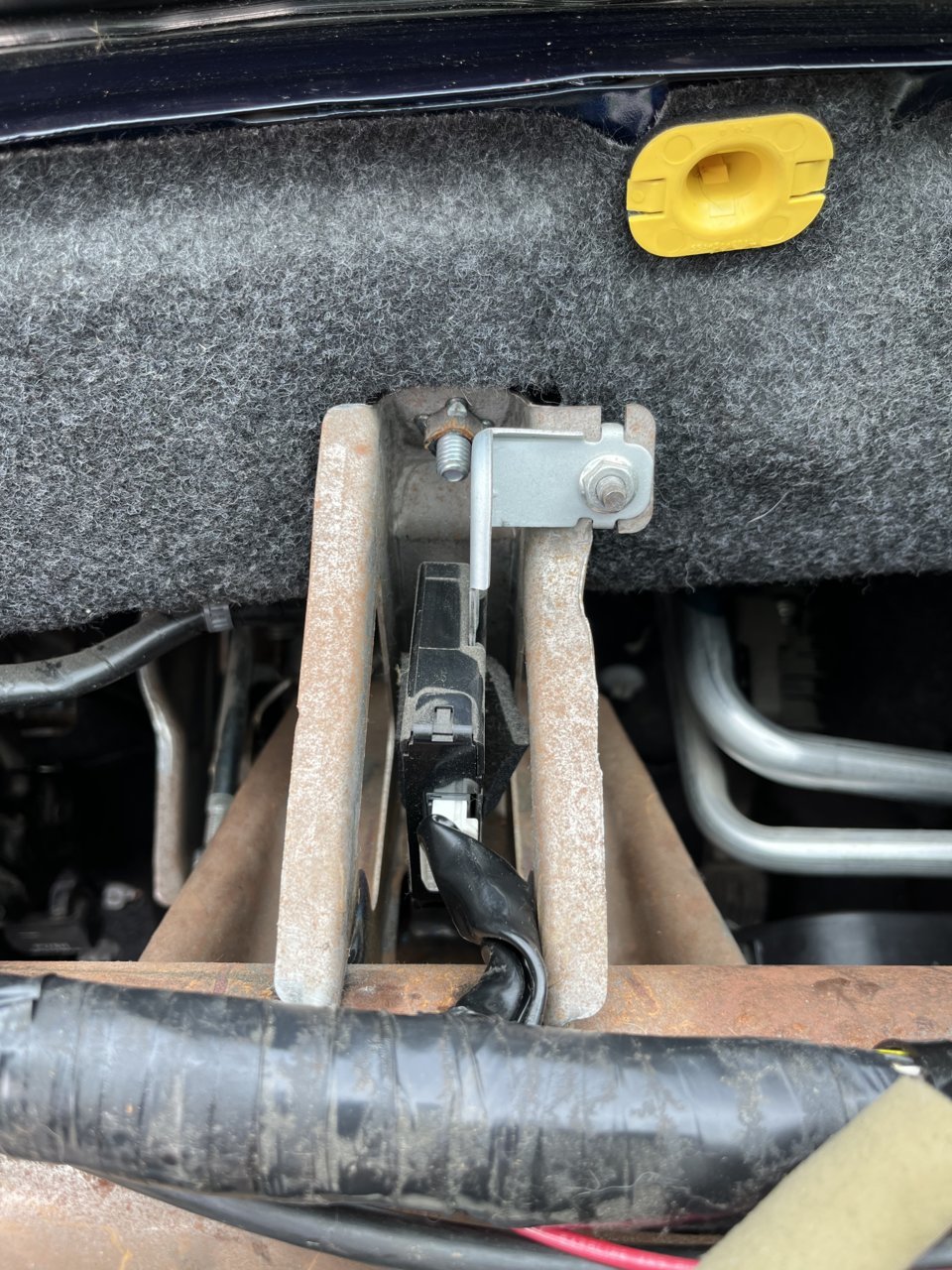

    Pulled dash and unplugged wiring from passenger side to driver’s side. Marked the plugs. Replaced evap and put everything back. Now when I try to start my truck it fires and stalls almost instantly. Been looking for anything I might have missed with the wiring but not finding anything. Any ideas would be greatly appreciated.

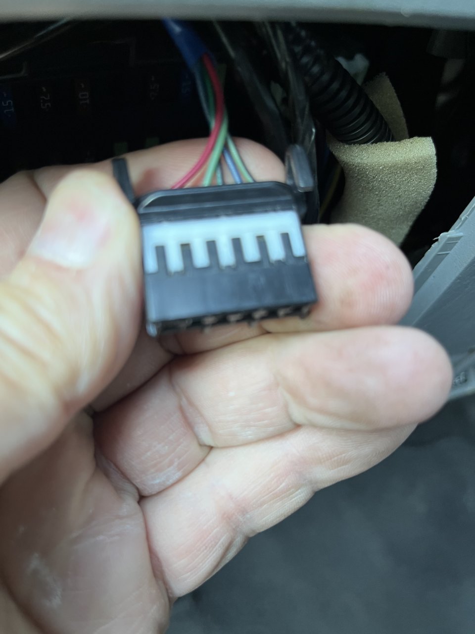

    9C72A3BC-382C-4AEB-AEDF-CFD18B0C0C38.jpg 8B95D22D-20E8-432E-B8EB-A64476608FCC.jpg I did find this plug above the fuse box but I don’t think it goes anywhere.
    I have the truck back together now. Just won’t stay running. Acts like it’s getting no fuel.

    Figured it out. After pulling the dash out again I found a plug I missed. Straight above the steering wheel all the way up neat the glass. Not sure what the module is but the truck will not stay running if it’s not plugged in.
