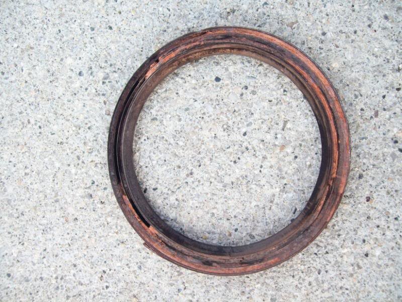

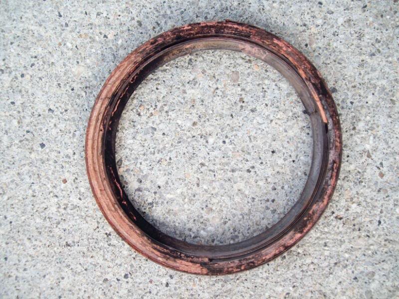

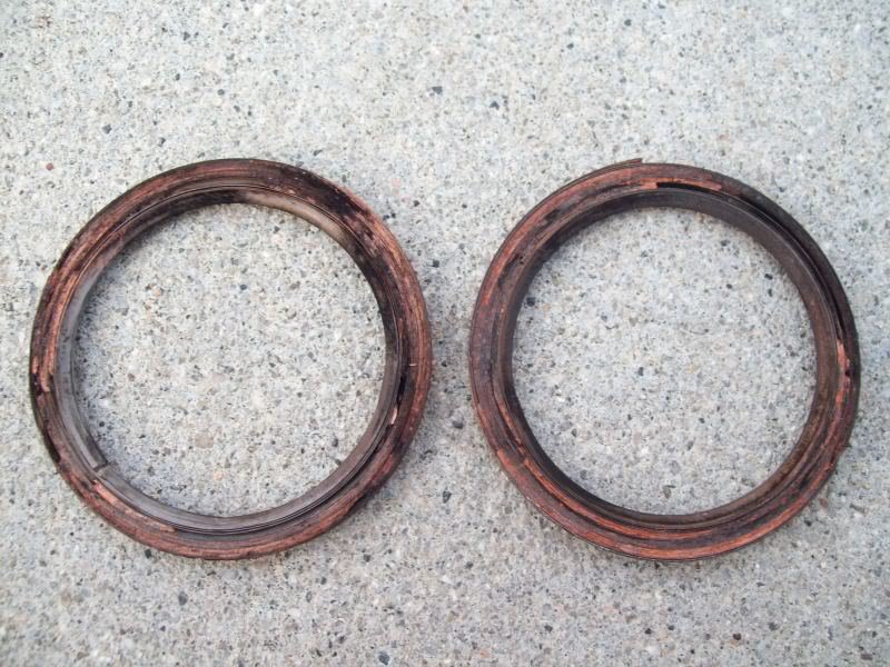

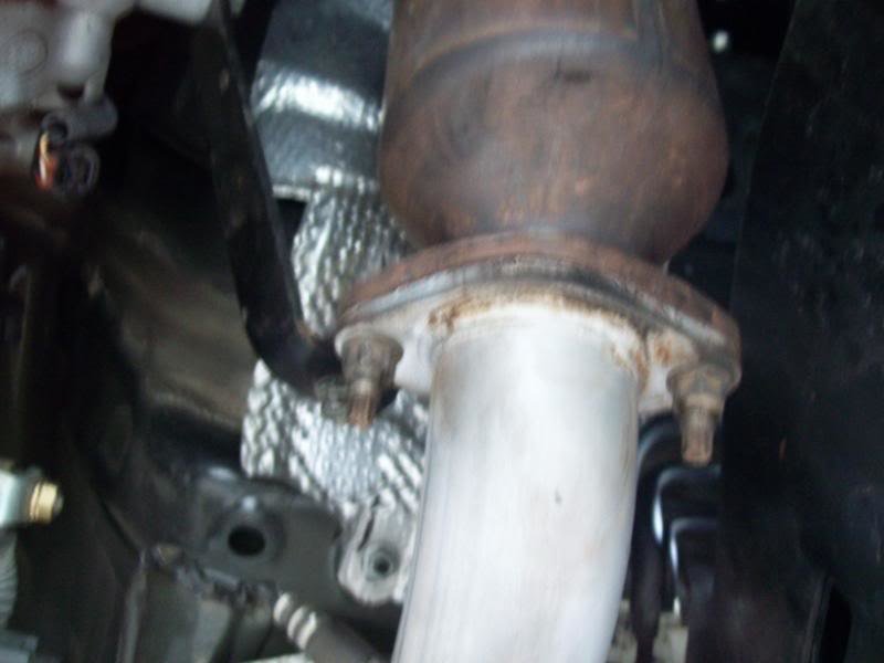

    So the other day i was under my truck checkin for leaks and saw some black where the y-pipe meets the first pair of cats, the driver side had more than the passenger side. this morning i replaced the crush gaskets with new OEM ones. it was tough getting the gasket to fit well since its an aftermarket y-pipe but finally got it to fit right

    I am now leak free :D

    Cool! I meant to tell ya, anytime I replace gaskets, I use some Copper RTV. I have never had a leak. :) Something to think about if it happens again.

    Wow, just did the same today. I put those OEM gaskets in, and felt was still having leak. went to a muffler shop and they suggested same deal. Works good. I got the Copper one, says withstands 700 deg. temp and safe for O2 sensor, which is located right beneath that flange.
