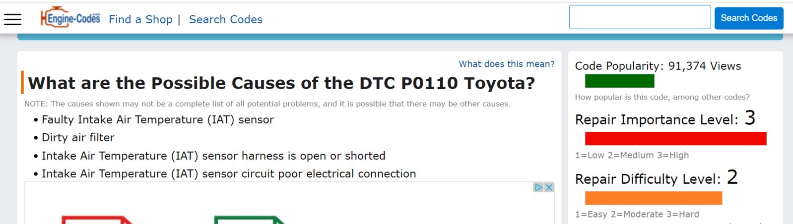

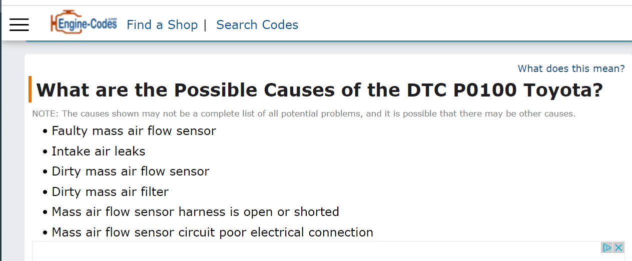

    not too many things to investigate.......
    Taco Phil[OP] likes this.

    tht IAT sensor, doesnt it just plug into airbox....into a rubber grommet?

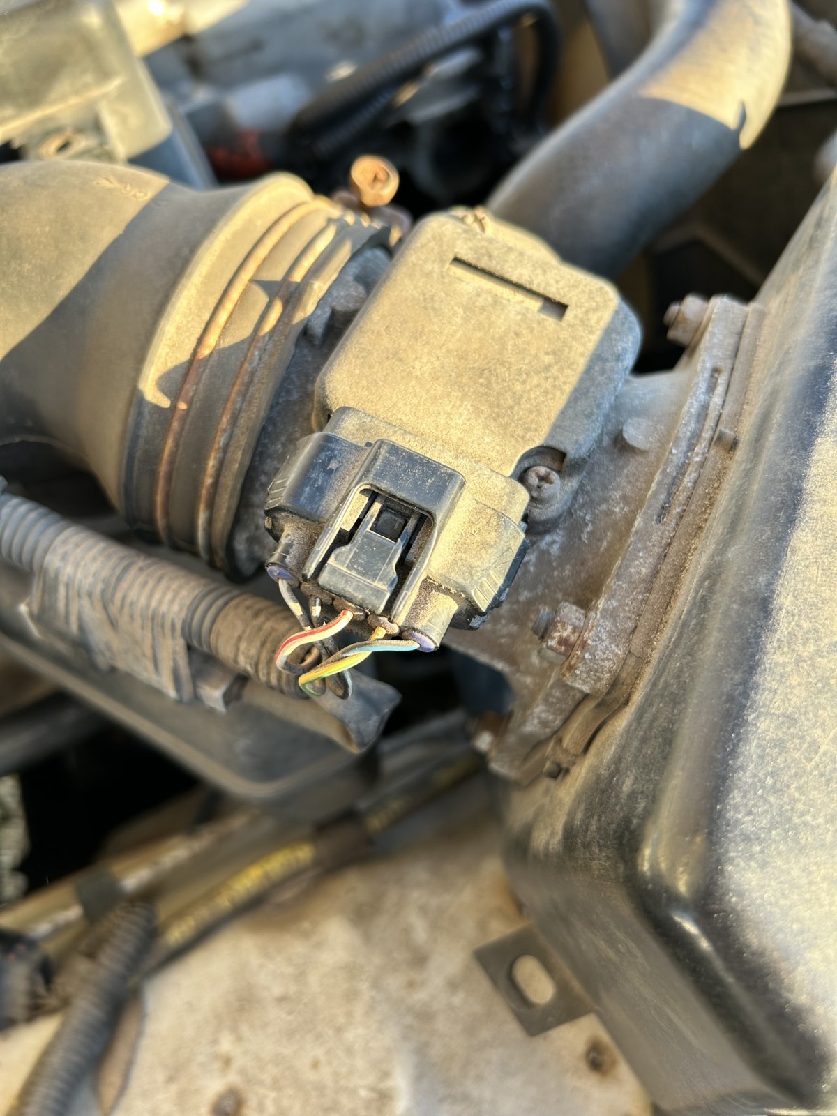

  13. Dec 28, 2023 at 2:49 PM

  14. Dec 28, 2023 at 2:59 PM
    ControlCar
    ControlCar My Moto: Help & Learn…period.
    Jul 22, 2023
    #429578
    3,590
    Steven
    Sugar Land TX
    1996 Taco 2.4L 2wd Automatic
    Clock Volt meter/LSPV Delete/Hyundai 16’s/FP gauge/after 9months of wrenching ZERO oil leaks
    no that is the MAF pigtail^^^
    there is a small little plastic pointy thing/sensor
    gimme a min

    I did not have that. I just went and checked.
