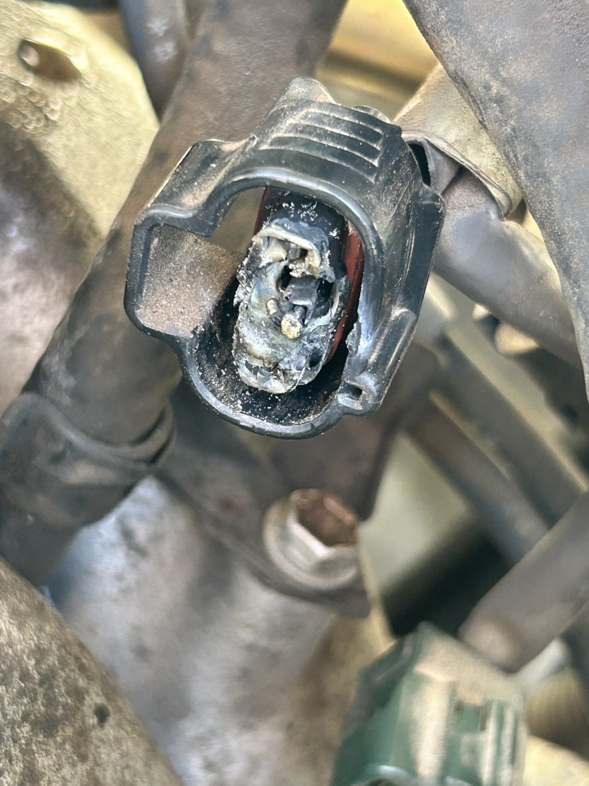

    Well guys, I guess I screwed up.
    This is the connection to the IAC. It’s fried. This was the smoke I saw when I started it for the first time. Was this because I didn’t disconnect the negative cable from the battery before I started changing it out? I can assure you I did it now.
    Other than going to the dealer and buying an OEM IAC on Wednesday, could somebody please explain to me how can I change this connection? Really need your help guys.

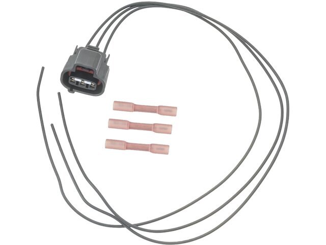

    I'd try to wire up a new connector. Should be a very simple and cheap fix.
    Taco Phil[OP] likes this.

    So I should cut the wires as close to the old burned connector as possible, then strip them, then connect the new connector, and twist them together?
    some black electrical tape after?

    Buy a new connector (I always go OEM for stuff like this but its your call). Splice wires and reconnect them with the new connector (carefully one at a time to not screw things up). Use wire connectors.

    did this happen because I did not disconnect the battery when I connected the new IAC?
