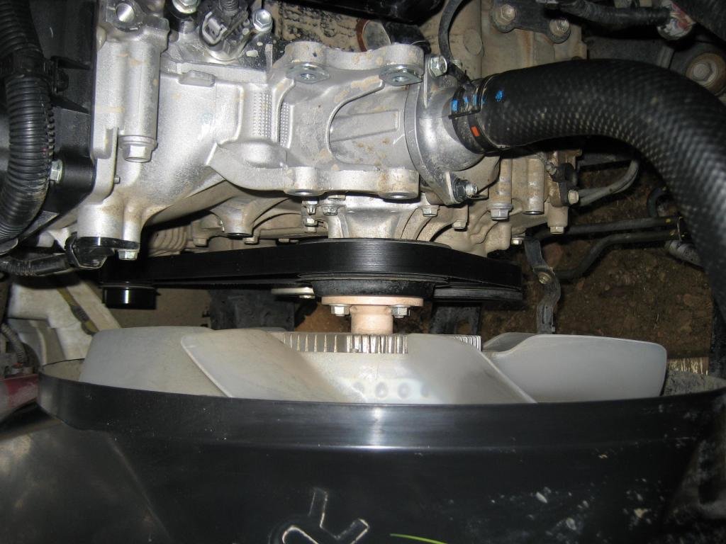

    Why not simply leave the damn pump off? :)
    I removed mine, connected the input hose to the output in a closed loop, removed all of the extra pulleys and ran a shorter belt. :thumbsup:

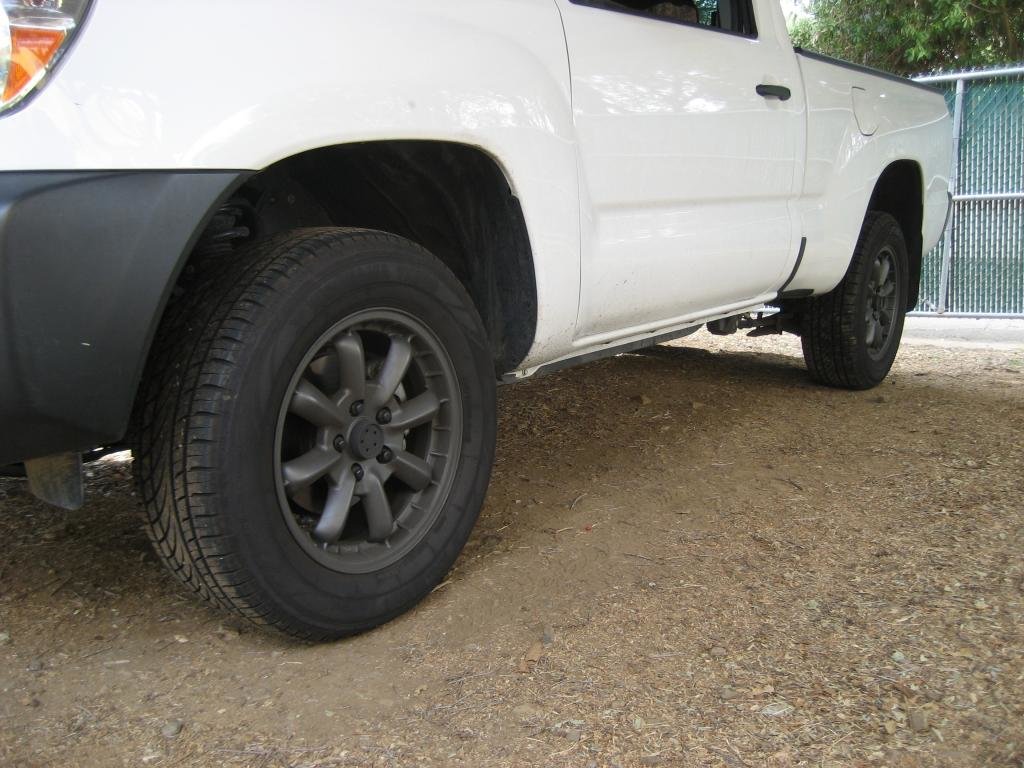

    I totally understand. My work truck never sees dirt and has lightweight stock diameter street wheels and tires on it and so steers easier.
    I was around when almost all vehicles had manual steering, so the trick to parking is never to try to turn your wheels when they are not in motion. Even if your wheels are moving just a few inches at a time you can gradually turn the steering wheel without needing a lot of effort. :thumbsup:
