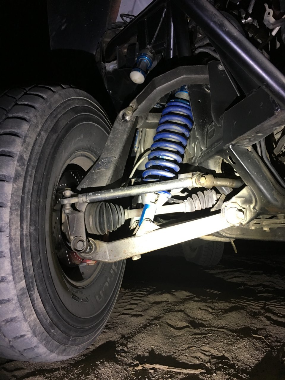

    nwi and i where just talking about putting this on my truck as my stock pump is starting to fade. did u end up simply getting a "kit" or did u have to get specific adapters and such to move from an fitting to stock yota hoses.. ect? gonna start with this on stock rack but plans to move to some sort of hydro system.
    also u running some sort of beef tierods they look blue in picture

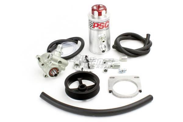

    I have noooo idea if they still are selling this kit, but it literally dropped into the truck and hasn't given me a single issue yet. And I started this thread back in 2014.

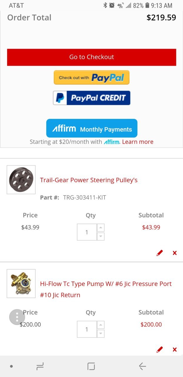

    I ordered the 3.0 kit for my other truck and it won't fit without heavy modification.
    I do know if you use pump sp1200x and the pulley 2427 you can install it in the 4.0

    This is what psc told me to get and then trail gears pulley for micro V belt.

    I was on the phone with PSC Motorsports yesterday and trail gear as well. PSC Guy told me they didn't have complete kits for the 4.0 and that I would need the pulley as well as the pump mounting bracket from Trail Gear. So then to TG I go and they don't have anything for the 4.0 actually.
    Looks like the only bolt on option for the 4.0 is OEM. FACK

    http://www.chassisunlimited.com/pro...series-serpentine-pump-pulley-4-0-toyota.html
    This one?
    Still leaves the bracket to be sourced. In my research I found nobody makes a bracket to fit these pumps to the 4.0... at least not anymore as PSC doesn't sell the kit the OP bought anymore

    So I have the tc style pump that will mount in. Stock location. I'll have to shim it so It won't destroy belts though. Now the tricky part, psc doesn't make the 4.0 7 rib pulley any more so I had to buy a 6 rib pulley from trail gear and get some 6 rib belts. I have everything I need for the swap other than a New power steering line which I plan on getting in a few weeks. I won't do the install until after October 14th as I have a trip planned and already doing a shit ton of work for that haha.
    I have also built a custom tie rod as well for some added strength. Camburg clevis and 3/4 heim inner to 1.25x 120 wall Dom tubing to fj80 outer tie rod. Had to drill out the spindle and bushing in to match the taper of the fj tie rod end.
